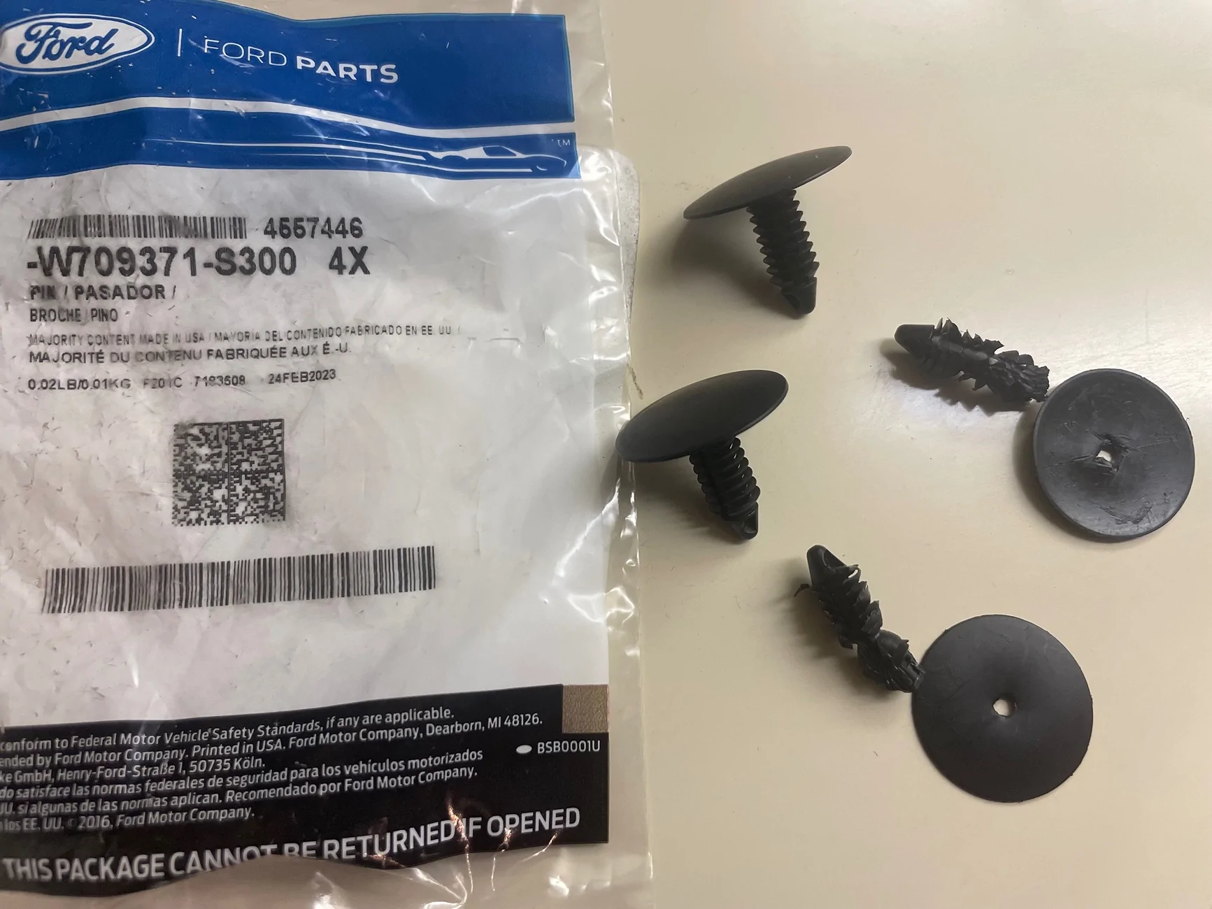

These are the Ford ones for the ones that break 100% of the time.
They come in 4 packs, but are sold individually.
