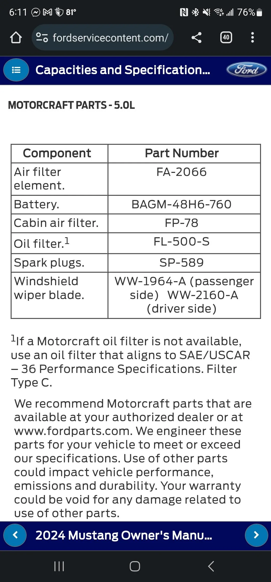

See pic, thanks for the help though.
S650 Mustang GT Oil Filter part # number? Screenshot_20230921_181133_Chrom

I'm wondering why it's showing that one the ford parts website but the manual has the fl500s. I'm about to do the change so we will see if this one fits, I imagine it will. I'll come back and confirm in a little bit.

Ok I can confirm that the FL-500-S oil filter fits good. It is a little longer than the stock filter but that's no issue at all.
I can also confirm the oil pan is metal with a metal oil drain plug.
You'll need a 15mm socket for the drain plug and you will need a 9/32 socket for the 12 ish small bolts holding the splash shield on. The oil filter can't be reached without taking it off. There is no access door to get to the oil filter like previous years.
I added 2 bottle of Ceratec to my full synthetic 10qts, since 1 bottle treats 5qts. All went smooth just plan on a little more time to take the shield off.
