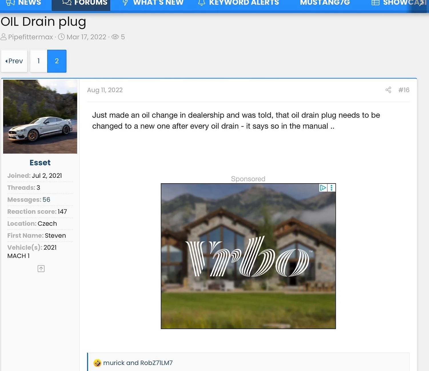

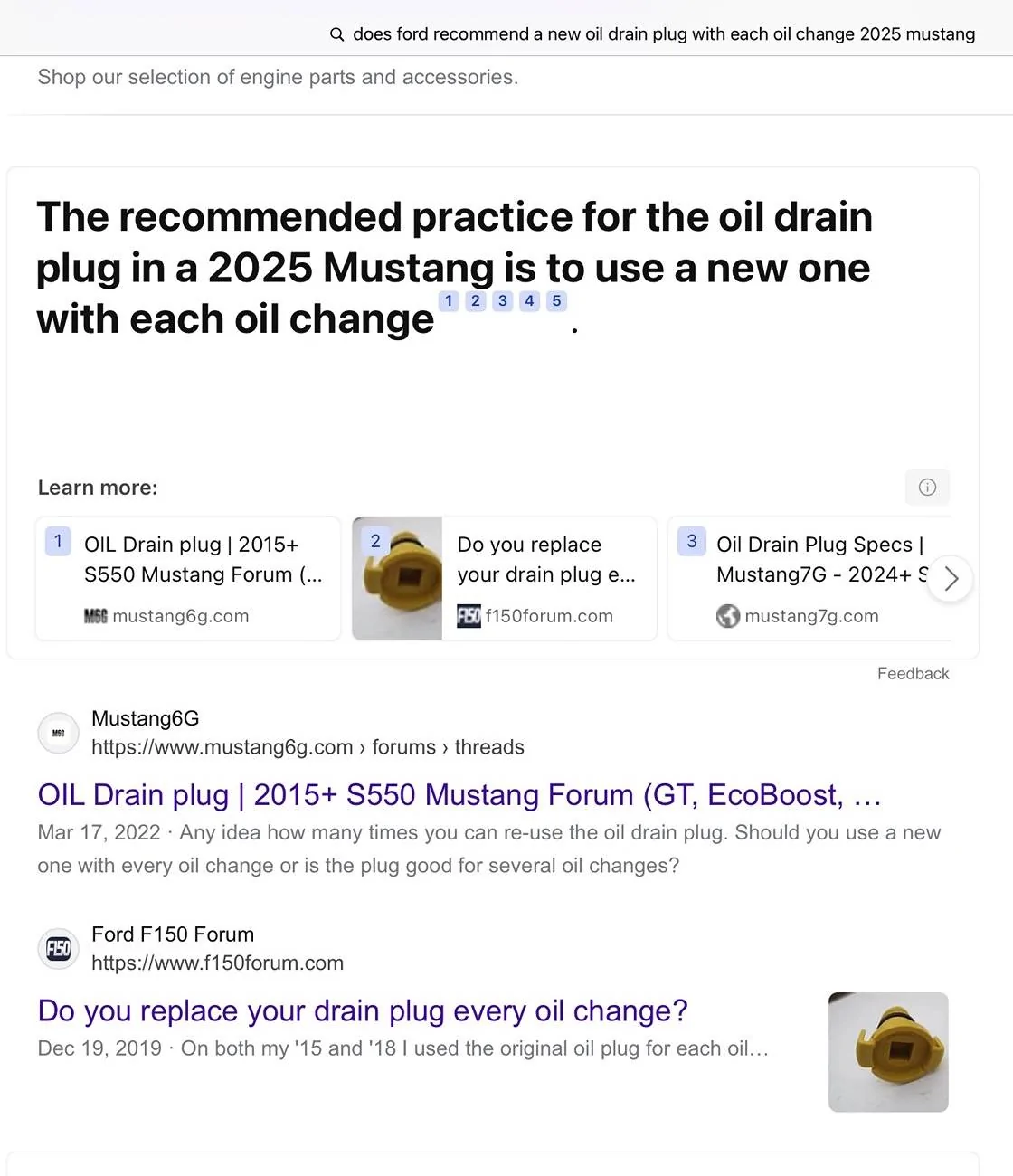

1) EDIT: I have read in other FORUMS, AND GOOGLE SEARCHES, that Ford recommends using a new oil drain plug every oil change. Mostly for the fresh integrated gasket. I CANNOT VERIFY THAT IN THE MANUAL…( I ordered a few extra OEM bolts from LMR anyway because they are cheap enough)

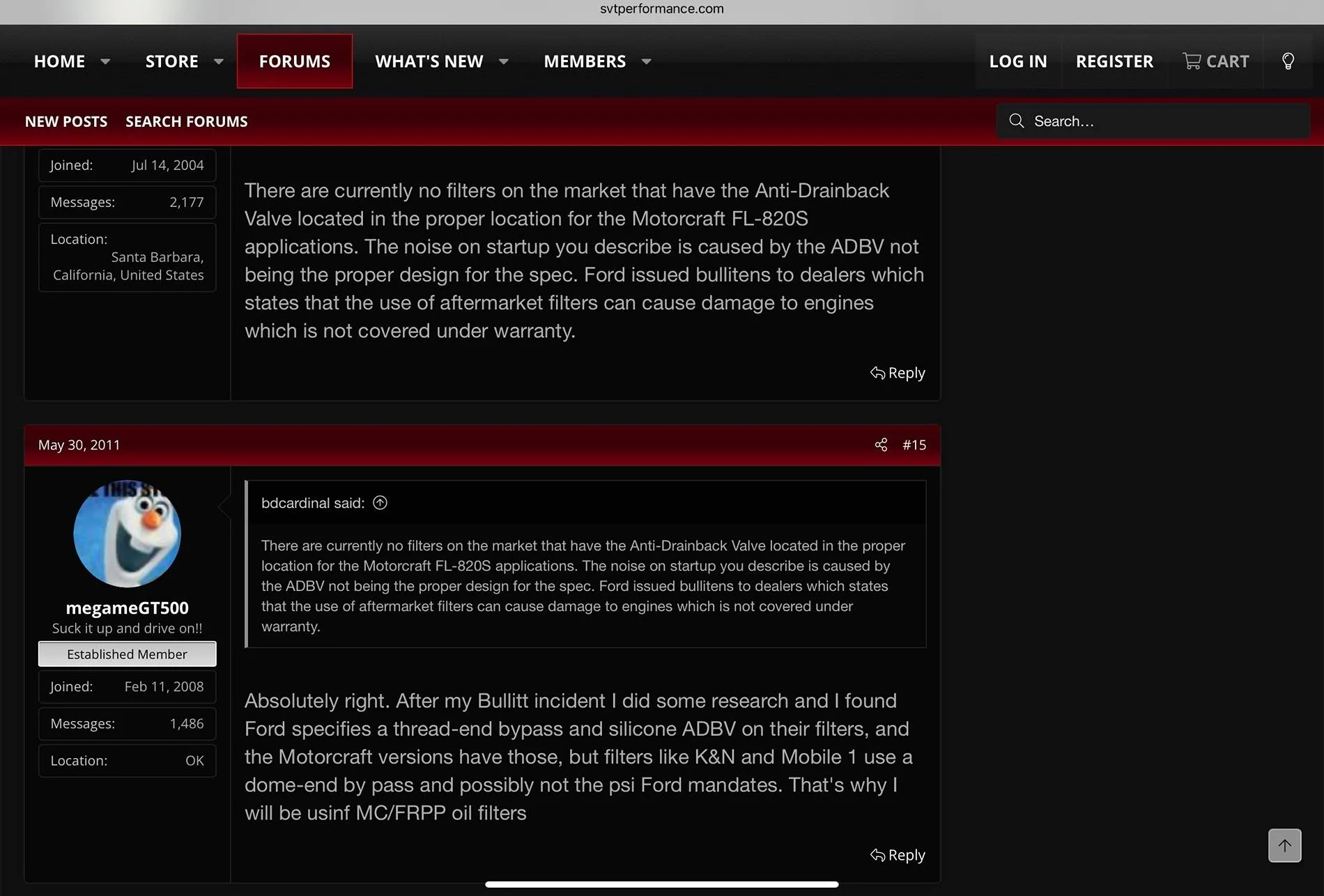

2) Mobil 1 filters are high quality synthetic material, but even though they have anti-drain back valves, the valves are reportedly not designed in the optimum way Motorcraft filters are specifically for their engines. Anyone else hear this? (After being a long time fan of Mobil 1, I am now thinking to stay with Motorcraft filters and get the full synth oil. That will also help if I ever have a warranty issue…in theory)
The only factors I don’t care about is cost. I just want what works best for the engine. $9 a year for a new oil drain bolt is not the issue….more like….is it really needed? That said, I’m erring on the side of caution.

For a new car under warranty, Or actually any of my cars, I don’t deviate from the recommended oil weight. And I think I’ve made up my mind to stick with Motorcraft For this car. Even though their filters are paper and reportedly 85% filtration compared to Mobil 1 synthetic pleat 99% filtration. The things I read about the anti drain back valve on the Motorcraft filter being optimized for that motor makes me want to play it safe.
I don’t know if anyone has experienced dry knock on start-up with the Mobil 1 filter here, but I have read it occurring on forums. (see below)

3,260
3,709
1) Ford recommends using a new oil drain plug every oil change.
I hear they recommend new tires every 5,000 miles, too.
They would if there were more folks like you out there, that's for sure! 😆
