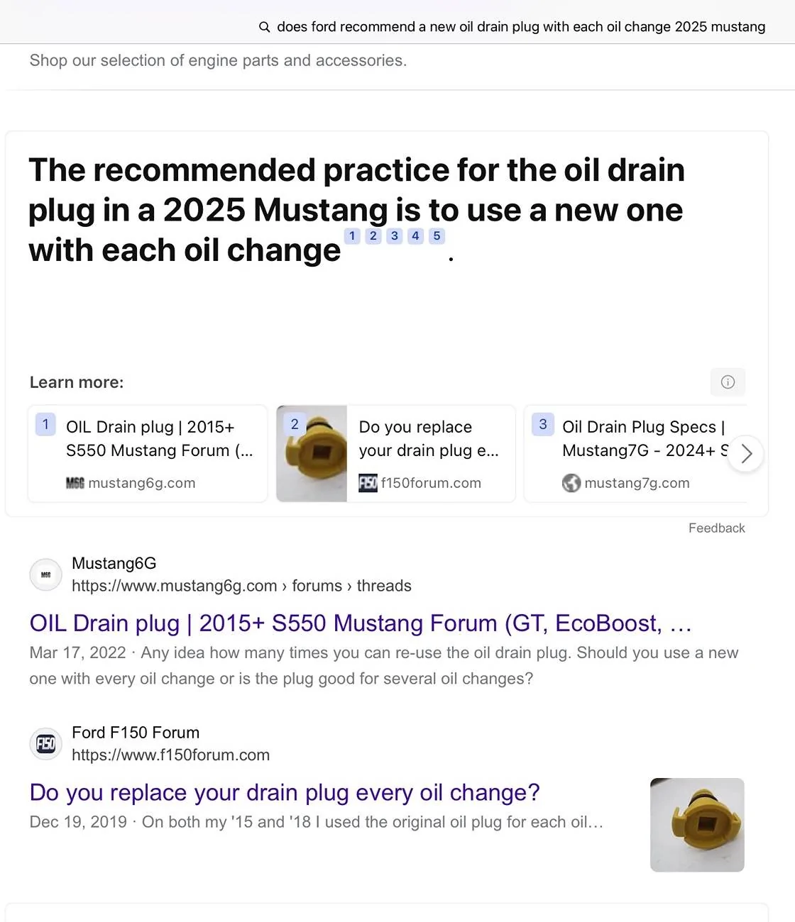

OK…..I looked in the manual and can’t verify what I have read elsewhere. I google the question and get this answer with sources. (See below) Now maybe the sources are actually referring to when the oil pan wasn’t metal. Maybe it is recommended but not specified in the manual. Maybe the original bolt can be reused forever. Sorry if my info was misleading by accidentally stating it as definitive info, but my research in general pointed to it being recommended…(even if only to be on the safe side.)
Yeah even a crushed or damaged drain plug gasket won’t leak more than an occasional drip. But hey, What’s $9……2 dozen eggs nowadays? around here $9 can’t even buy 2 gallons of premium.
Either way, I’ll amend my original post so it isn’t taken as gospel from the manual. I’m learning I have to be careful exactly how I word things around here. The original intent of my post was asking for opinions and further information that others might have here.
Below I have attached 2 screen shots that led me to believe fresh oil drain plugs is recommended.

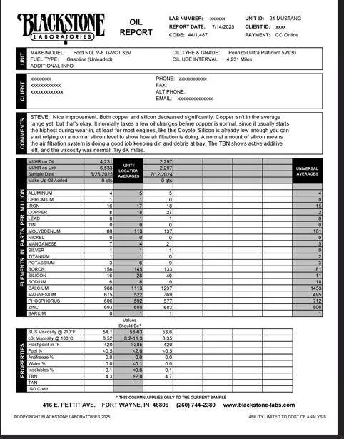

So here is my latest (2nd one) Blackstone report. Looks good to me. Comments?
