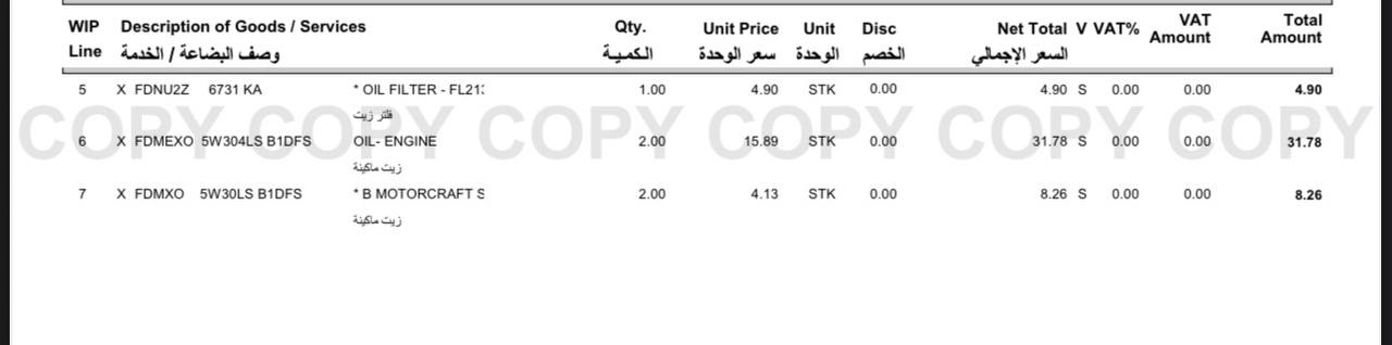

I had the oil and filter changed at a Ford dealership and the filter was not as recommended in the owner's manual for 5.0. They replaced the filter recommended for the Ford EcoBoost.it was FL21somthing, not FL500S, I spoke to them and told them about it. They told me that the filter they installed is specific to your car. I told them the manual says otherwise. They replied that it is from the factory. Basically, Ford did not install the filter on the FL500s.
Any one knows the filter number that came from factory with the car?
And is it fine to use them filter? 🙏🙏🙏

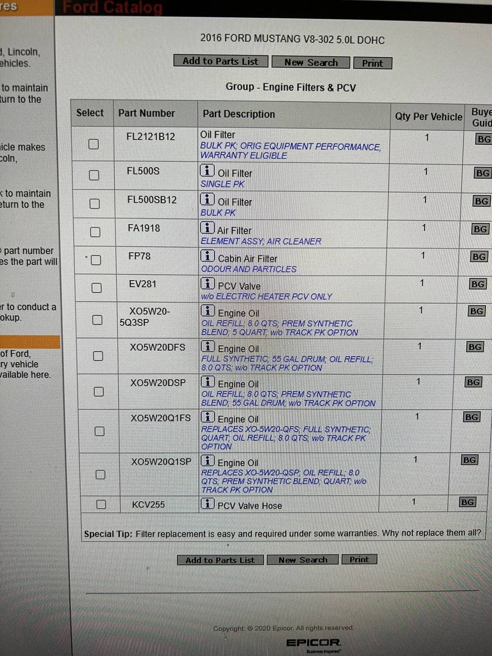

OK this got interesting. Seems the FL-2127 is a high performance version of the FL-500 and is completely interchangable. The 2127 is longer and presumably has more filter material.
Go to page 2 of this thread I linked below to see how the 2127 comes up in a Ford Service computer. it comes up as a high performance filter for the 5.0. Learning something new every day. Love this forum!
https://www.mustang6g.com/forums/threads/is-the-parts-guy-at-my-local-ford-dealer-an-idiot.183798/
Your pic shows FL-2121 not FL-2127.
I have some leftover 2127's from my old '24 Ecoboost and they prly will work fine on my new GT, but want to be extra careful to avoid Ford cancelling my warranty should an issue occur.

Good eye! The 1 looked like a 7, and I was more wrapped up reading the posts surrounding the pics.
Update
Unfortunately, the new filter is number 2133 and is a replacement for the 500 S. This filter is for Ford agents in the Middle East and Australia for sure. I do not know about the rest of the countries. of course,
This is what the spare parts employee at the dealer confirmed to me. He said that it is a step towards saving money by the Ford company, as this filter is manufactured in China.
