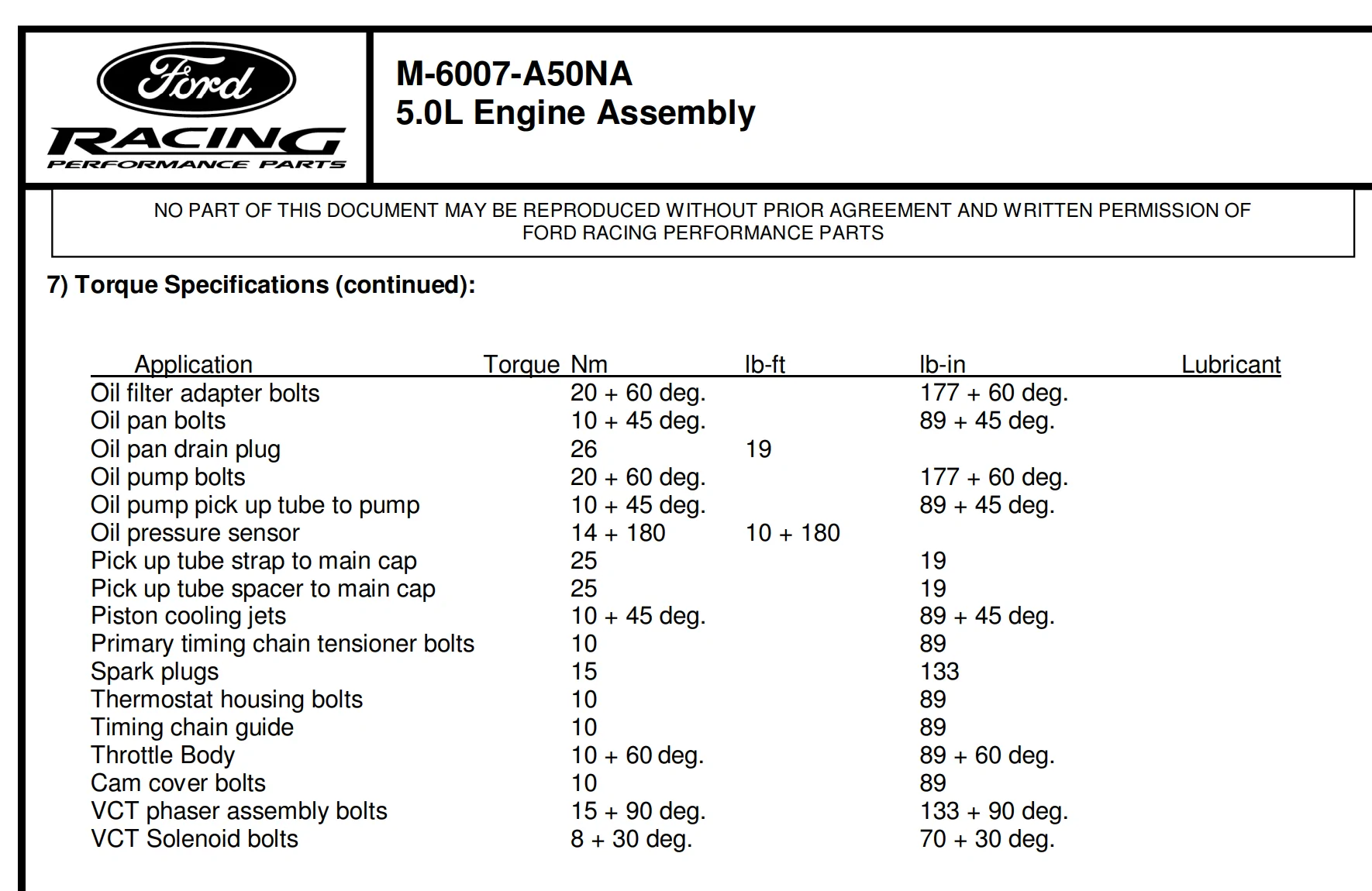

Does anyone have access to the factory service manual? If so, I'd be appreciative of an assist.
I'm looking for the bolt torque for the oil filter housing on the GT (Performance Pack), the one that is for the external oil cooler.
