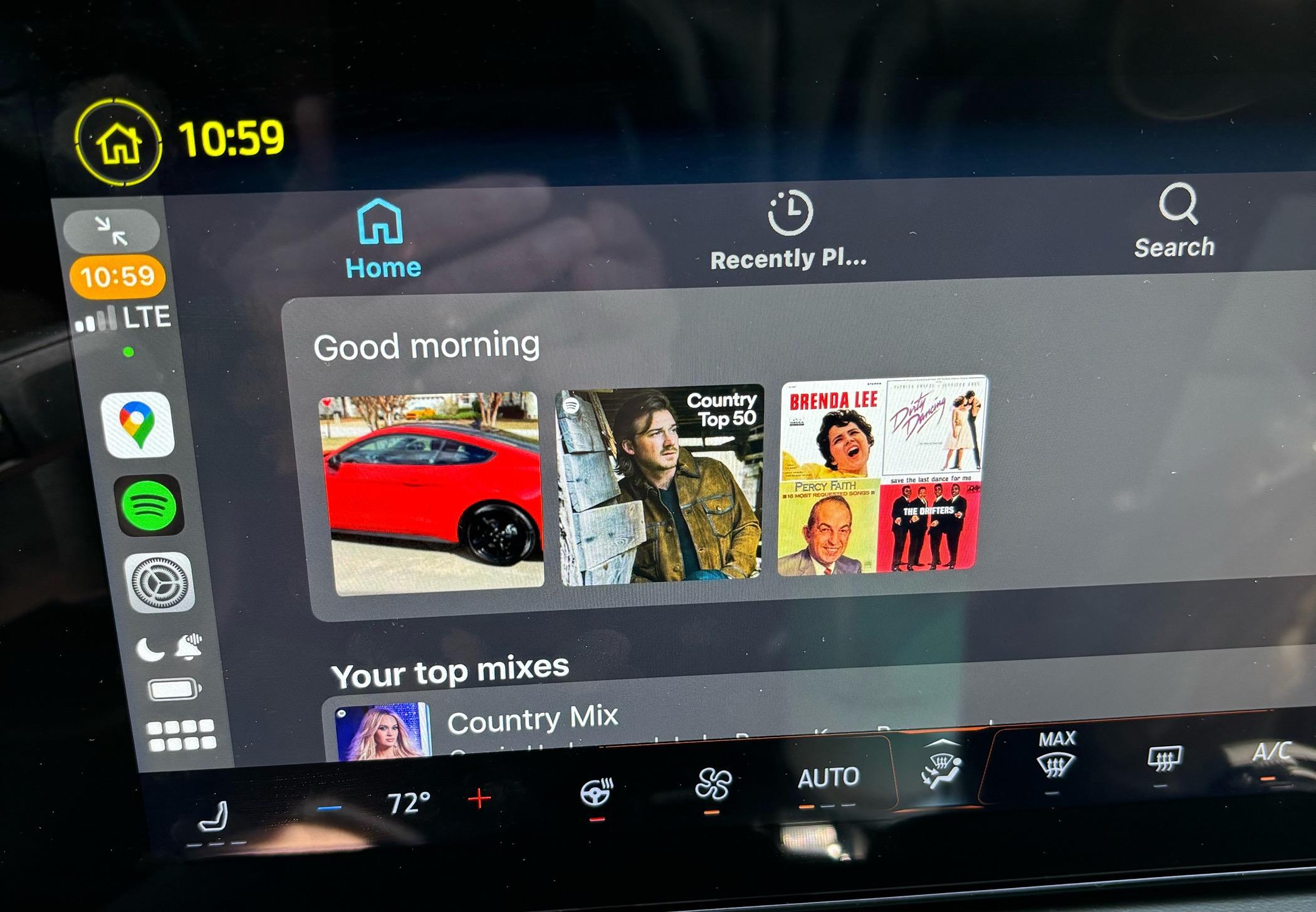

All im looking for is an easy way to switch between B&O Radio and Apple CarPlay. I have a GT Premium with the 401A. I pretty much just listen to Spotify using CarPlay. But, there are times I would like to listen to local stations. It’s a nightmare anytime I try and switch. Thought I had found the perfect answer from another thread but there is no way I can find a “Sources” button, on purpose! I did find it accidentally after about two days of playing with this thing but then it was a pain to get back to CarPlay. When I finally was able to the “Sources” button disappeared again.
My last ride was a 22 GT with the same radio and package. On that one all I did was open the Ford Pass app that was in CarPlay. This model I cannot even get Ford Pass to show up under apps. The glow of having a new and “improved model” has turned into more of a dense fog. The owners manual has been useless so far. Page 388 of the manual shows you how to turn the audio system on, which I have mastered by pushing the button in but then everything starts going down from there. Item two shows an icon and tells you to press it to open the media source menu. Says you can press it multiple times to scroll 5hrough the sources. I cannot find this icon anywhere! I’ve always been fairly tech savvy but this piece of junk has got me wondering, for sure. Obviously I need some help but I’m hoping it won’t come from anyone that’s had the same problem. I’ve been working on this for days now. Thanks for listening.

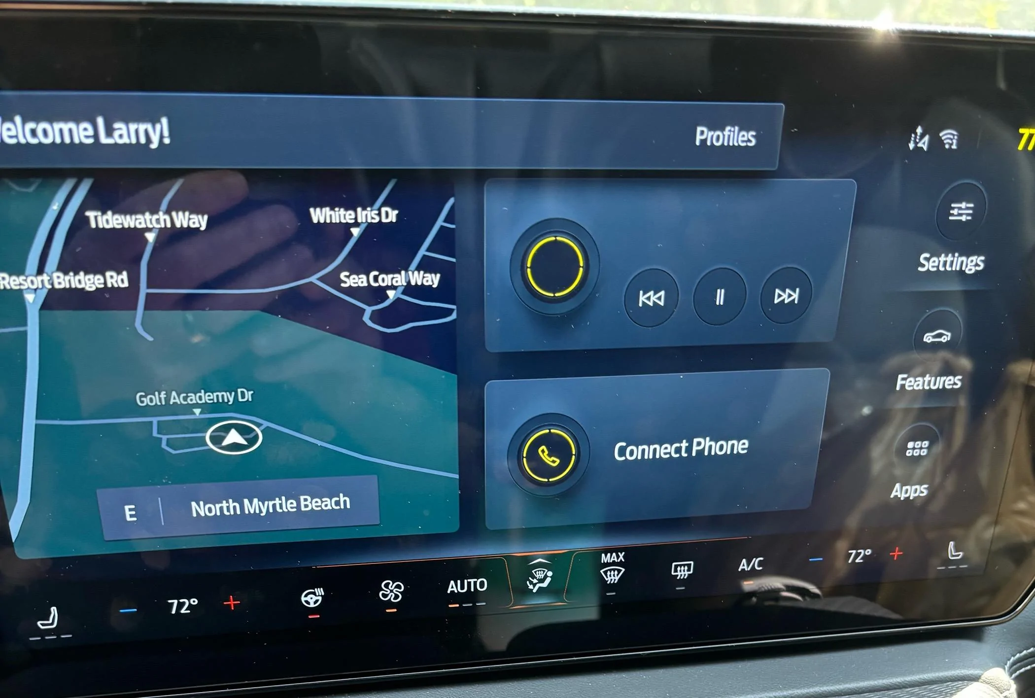

I completely agree it sucks switching sources. The fastest way I’ve found to do it is select the tile on the right side that shows what’s playing. It opens up on the main screen and there is a sources button you can toggle between options.

This, just hit the Audio tab then sources. If you the home button it brings you to the screen with the audio tile.

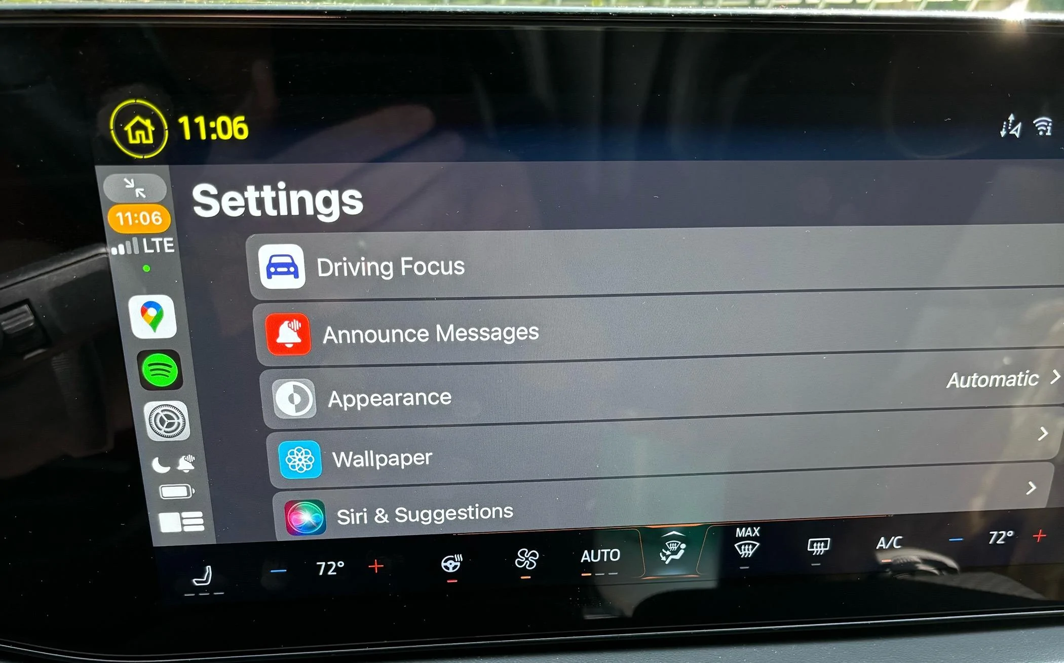

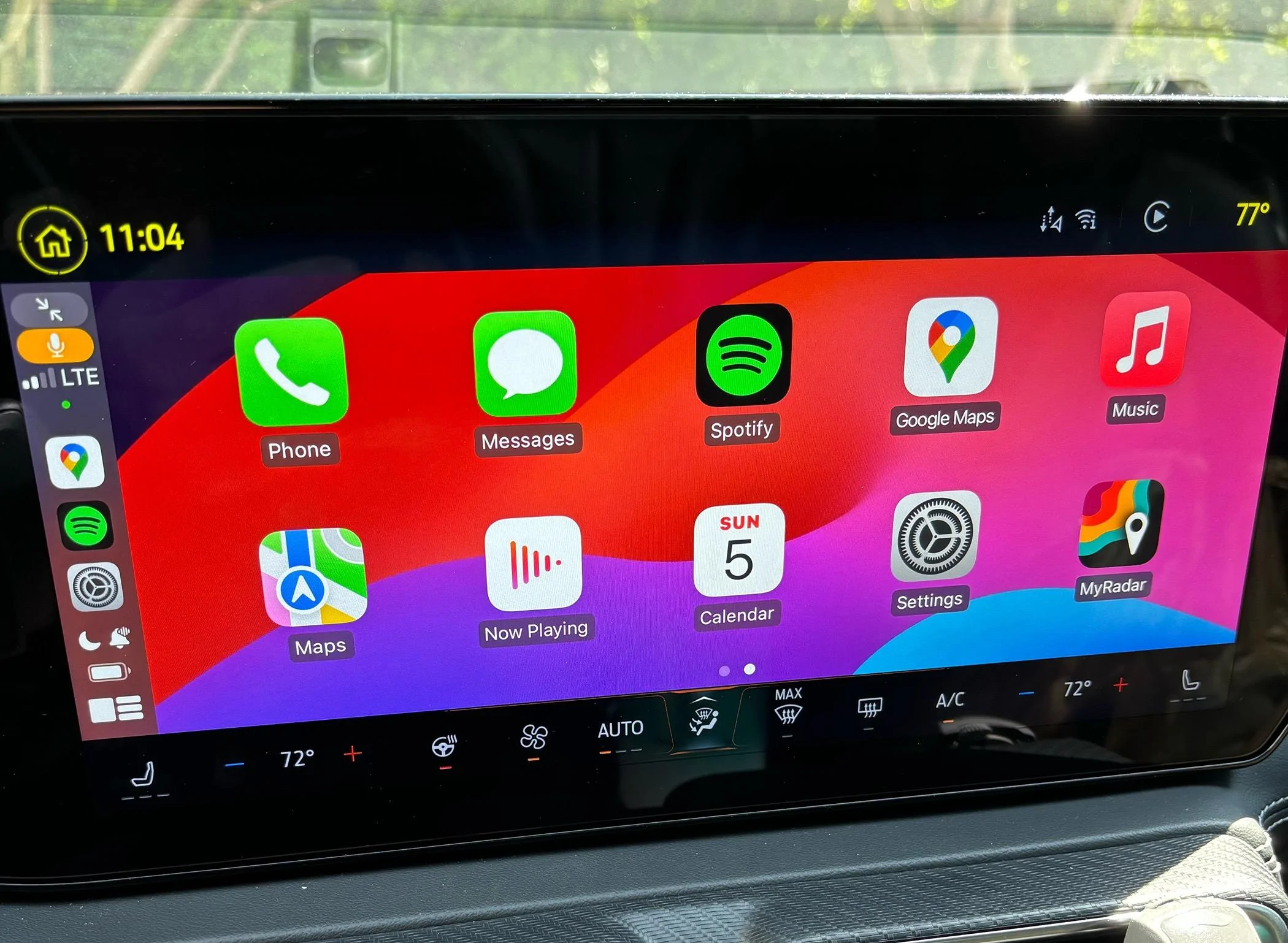

Well, I appreciate everyone’s advice but voice command doesn’t appear to be working properly for me. Using it I tried “sources, audio sources, audio, tune to fm 94.7, etc etc.” Nothing worked. It kept referring me back to Spotify channels.
When I initially start the car it takes me to a page that normally have the source tab but never fully loads before it returns to my Spotify homepage. I’m beginning to think I may not be as dumb as I thought and it’s time to take this puppy to a dealer and have them check it out. Was just so much easier using the Ford Pass app in the icons on my 22. Evidently Ford improved it by eliminating it from my car. Great job Ford.
Again, thanks for the advice. All this remind# me of the old saying “you can lead an old horse to the after but you can’t make him drink”. I feel like an old gray mare right about now.
