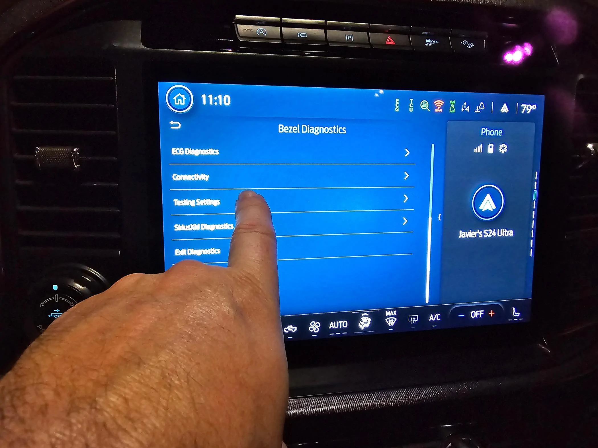

Let's test the connectivity theory. Does anyone know how to get into diagnostics mode in these cars? On my truck, you hold radio power button and the previous track button until it gets to the speaker test screen. You wait for the speaker test to finish and end up here:
S650 Mustang Recurring Infotainment and Connected Services Issues in S650 Mustang 1000047728

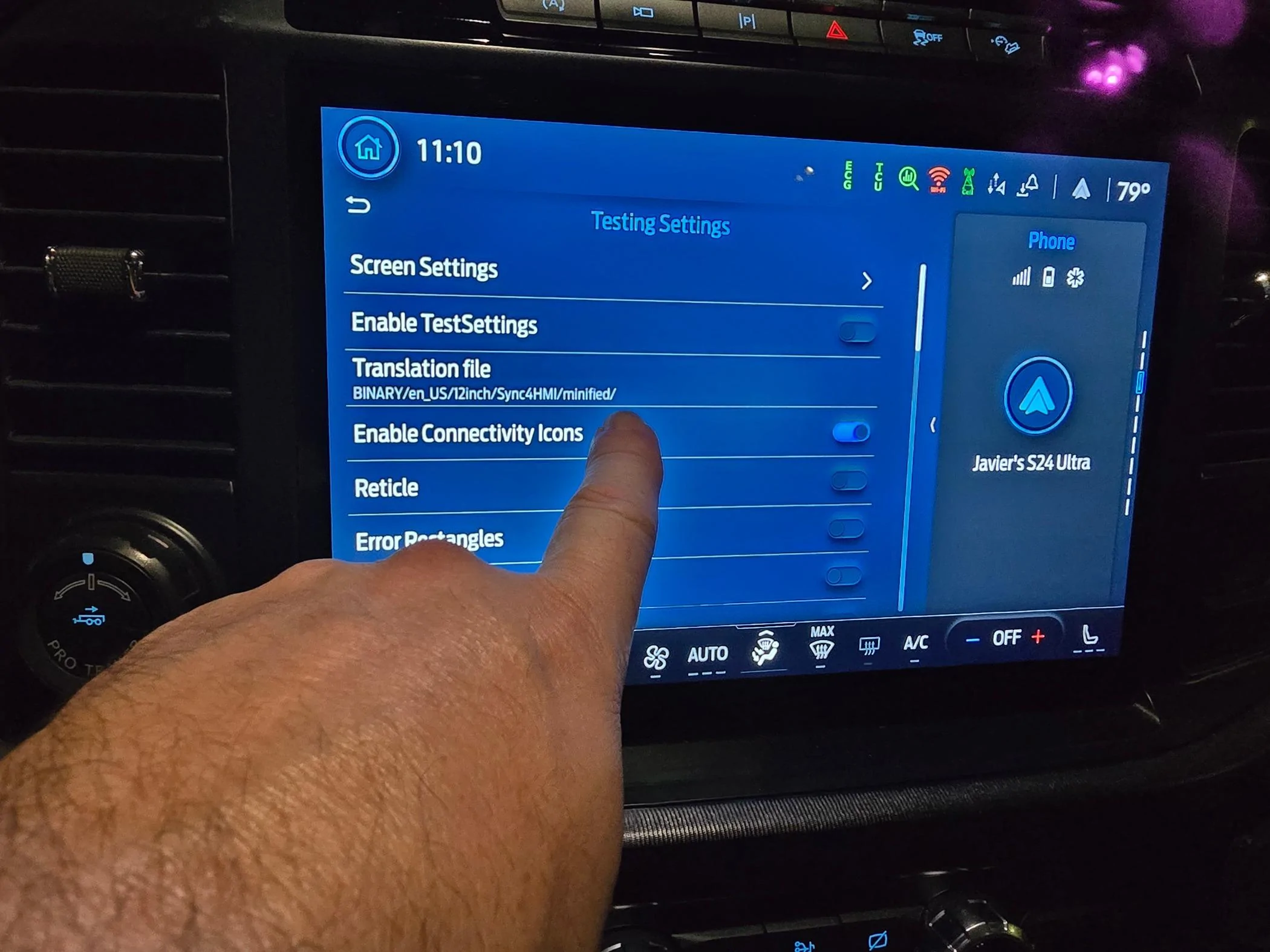

From this menu, you select testing settings and flip the toggle to turn on the connectivity icons which is what you see on the top right of my screen.
S650 Mustang Recurring Infotainment and Connected Services Issues in S650 Mustang 1000047729
If the TCU is green, connectivity it working. If it's red, it's not. This can help to rule out the connectivity theory.
Maybe for you guys it's radio power button and hold the previous track button on the steering wheel to get to this menu?
I'll find out tomorrow how to get in there on these cars.
