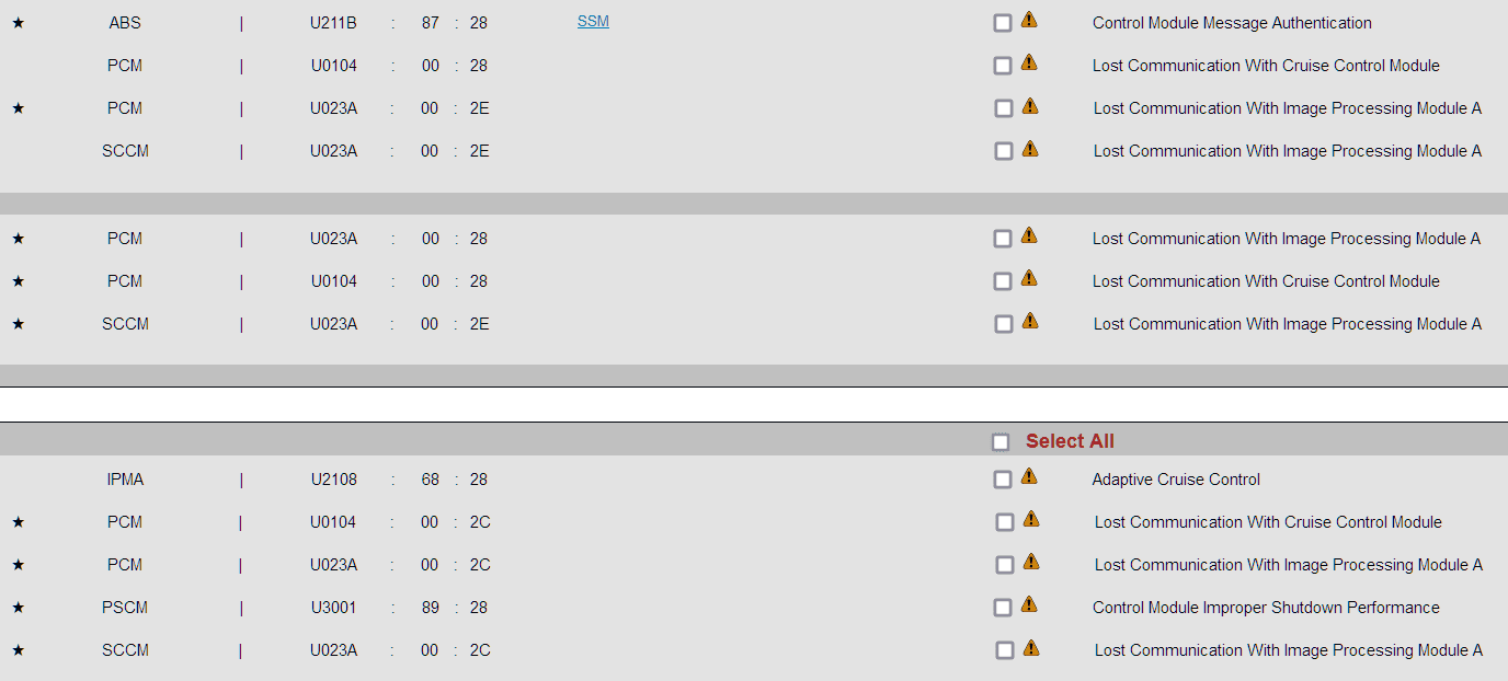

according to OASIS, my vehicle is also constantly setting codes
