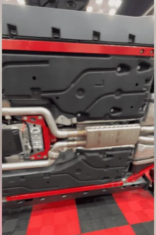

My Focus ST (8yrs) and Focus RS (3yrs) both had undertrays (8ish screws)...........................AND some sort of rubber mini splitter(4 or 5 screws) mounted at the leading edge of the undertrays.
As an option; we wouldn't have to leave the UT off; we could just cut access holes in it for the drain plug and filter.

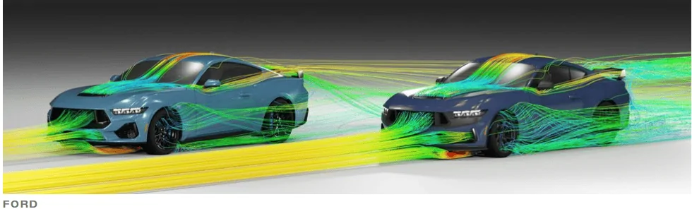

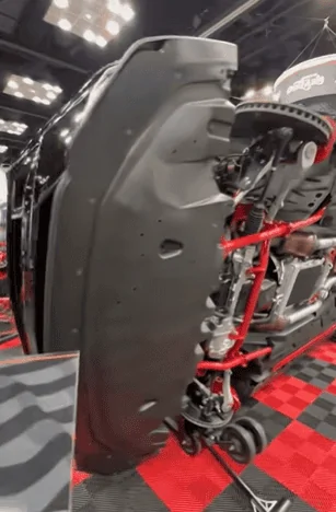

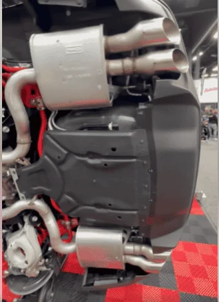

Yea, its a royal PITA, but it's all to improve aero, which I believe Ford has done a pretty good job with it. The entire underside is not covered like a full fledged race car, but quite a bit of it is. And, for $78.00, I'll let my dealer do the oil/filter change.
