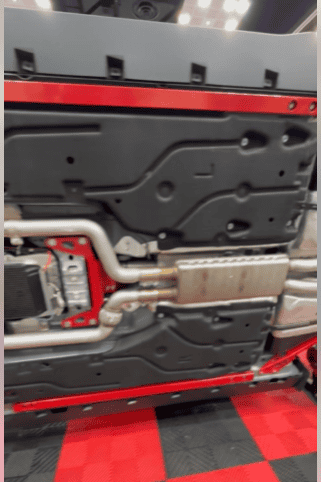

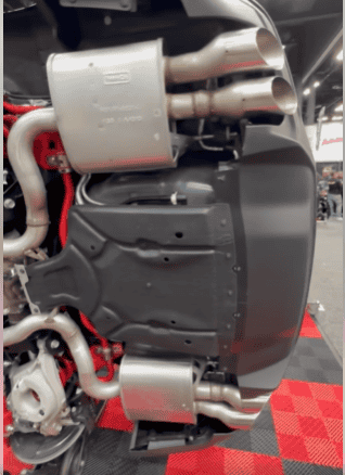

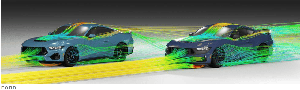

Yea, its a royal PITA, but it's all to improve aero, which I believe Ford has done a pretty good job with it. The entire underside is not covered like a full fledged race car, but quite a bit of it is. And, for $78.00, I'll let my dealer do the oil/filter change.

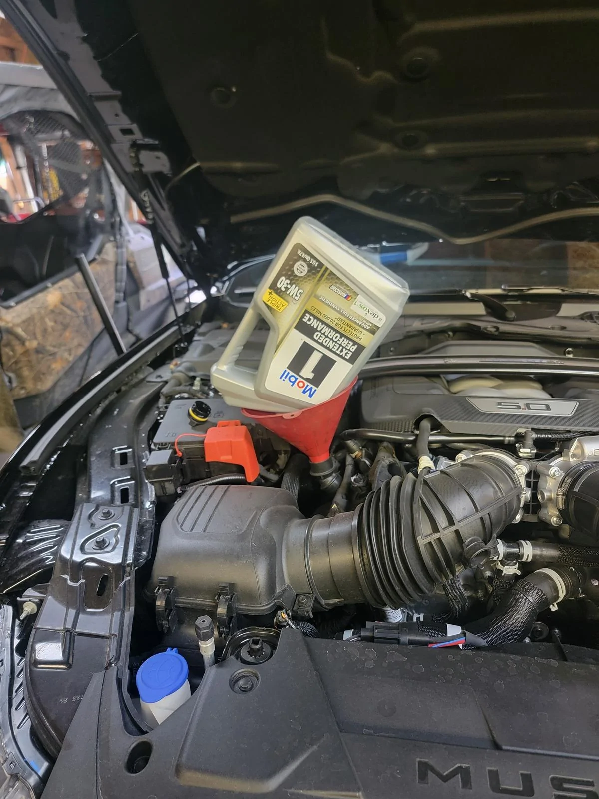

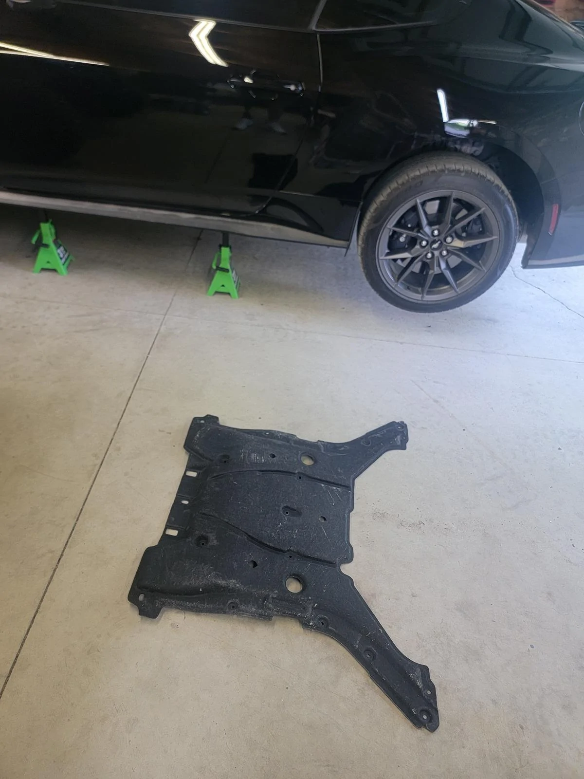

Did my first oil change today @ 1,600 miles.

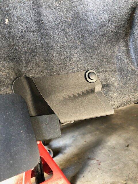

I installed the Steeda jacking rails the other day -- sure did make it easy. A few pumps of the jack, put a couple jack stands underneath, then the same thing on the other side. In two minutes, the car was off the ground with plenty of room to get underneath.
I hate to burst anybody's bubble here, but ... removing the panel in order to access the oil filter was ... absolutely no big deal at all.
Then again, I do have a Dewalt 20v MAX XR Cordless ratchet, so popping a 7mm deep well socket on it and backing out the 15 screws took less than 2 minutes. Now that I know exactly where they are, it will only take me about 45 seconds to remove them the next time I change the oil.
Side note: If you don't own any cordless power tools, including an impact gun and an impact ratchet - you're doing it all wrong. ;)
15 screws, two larger Christmas tree push rivets and two other 2-piece push style plastic rivets. that's it. Easy peasy.
If you have the air deflectors installed (standard on DH), 6 of the 15 screws are the ones that hold those on. You can leave the in place, just remove the three vertical screws and slide the panel out from under the deflectors on each side.
I drained 9+ quarts and used exactly 10 quarts to refill it back to within the upper and lower marks on the dipstick. Admittedly, I did not check the oil level from the factory, so it was likely a tad low.
Oil looked great - I'll be sending a sample off to Blackstone Labs.
For the refill, I went with Mobile 1 Full Synthetic 5W-30 Extended Performance and a Mobile 1 M1-212A filter.
This weekend, I plan to install my DIYVan fender liner covers. The duct tape I put on there a month and a half ago is still holding on pretty good!
EDIT: Forgot to include -- when I removed the 15 7mm screws while taking off the access panel, two of them were well over halfway out. If you haven't done your first oil change yet - or if you let someone else do them - you might want to check those.
