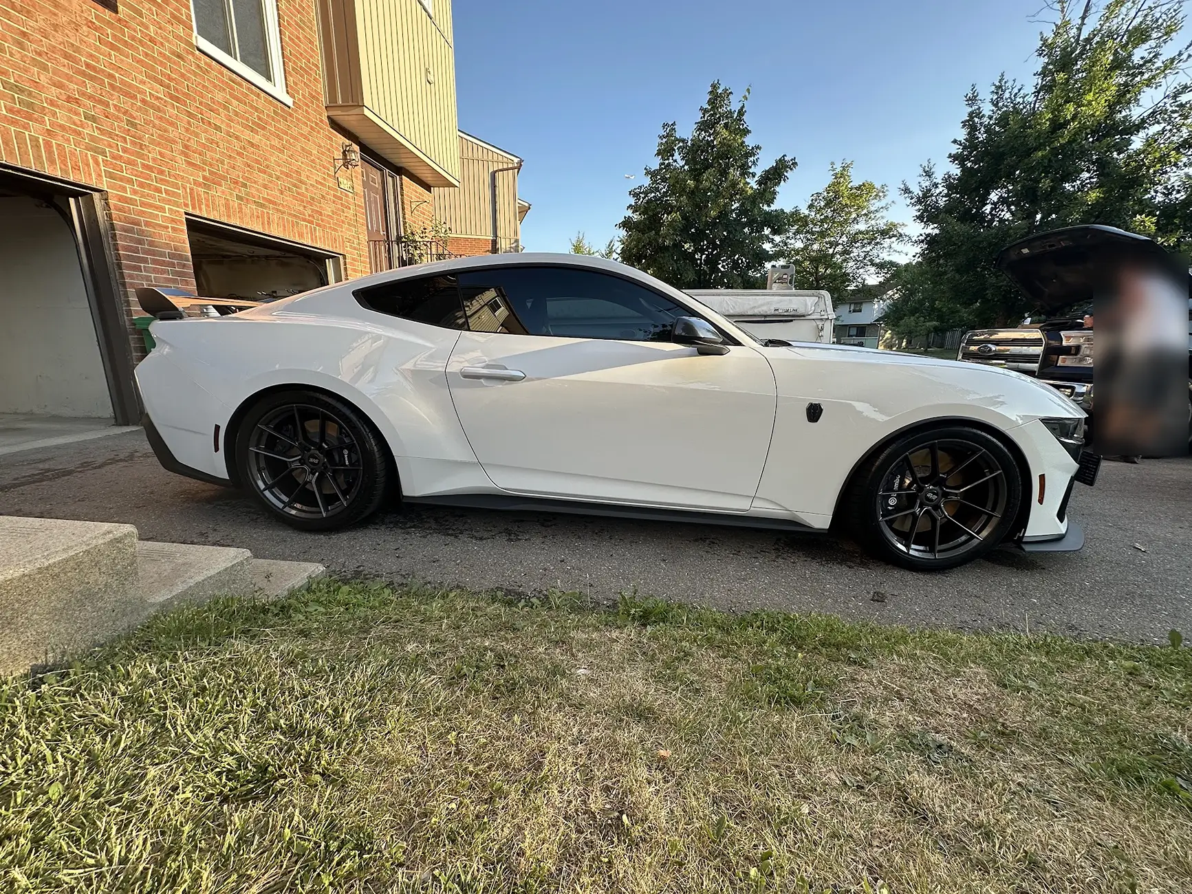

exm
Nov 4, 2025
431
524
Long Island, NY
20x10,20x11 Nysa Variant wheels in gunmetal

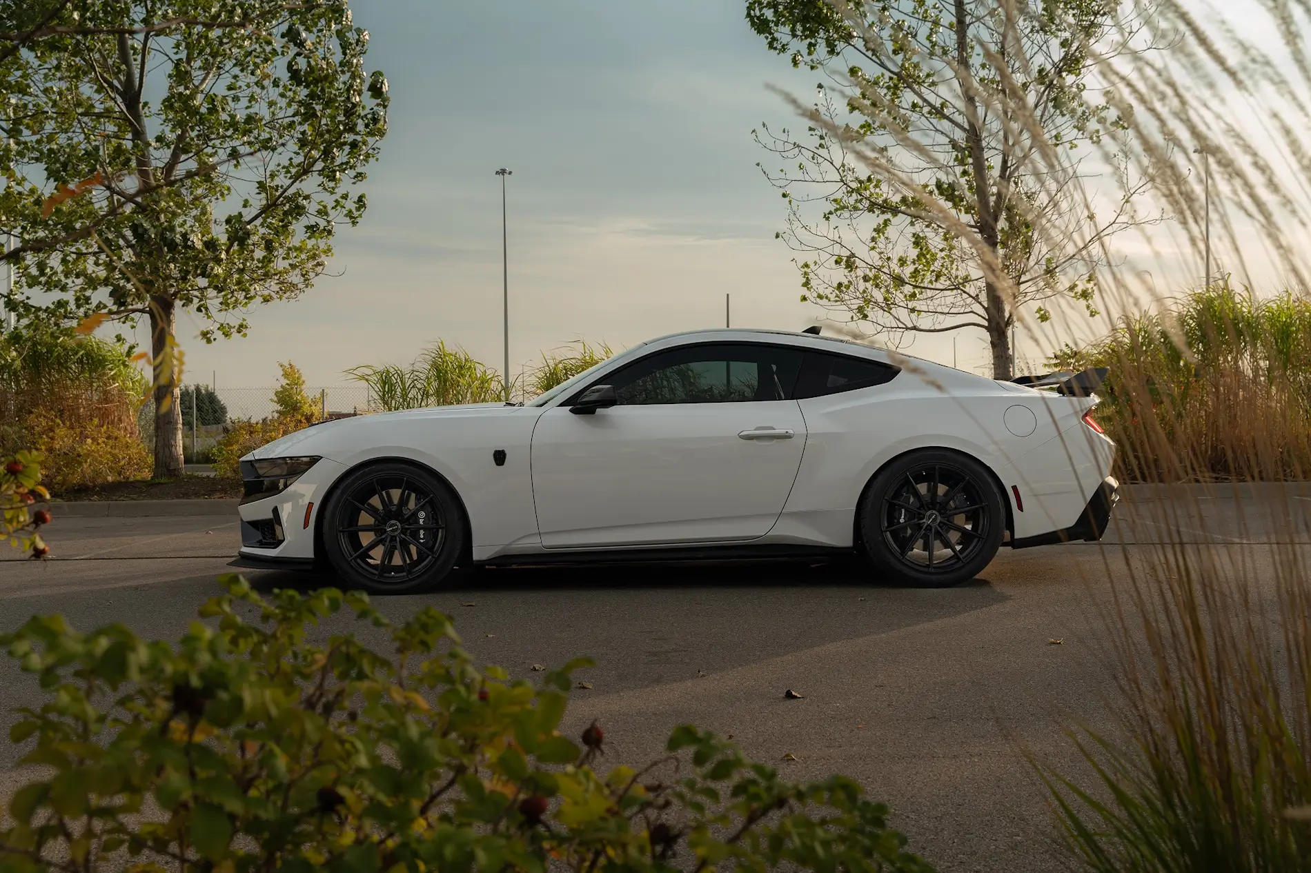

This thread is useless without pics.
Fair.
These are my Velgen VF10s with the Steeda Sport Progressives (not supercharged yet)
S650 Mustang Darkhorse Handling pack aftermarket wheel options 1781738275843-zc
These are my LMR SVE DHP1 also with the Steeda Sport Progressives + Supercharger
(after some sag/settle it is now just under 4" clearance from the splitter to the ground. Like 3.9"
S650 Mustang Darkhorse Handling pack aftermarket wheel options 1781738339687-6r
In progress are some Steeda Minimum Drop springs (already on the way) and some Apex 20" rims as mentioned in my comment above. That should increase the ride height anywhere between 0.5" and 1.0" while still filling the wheel gap.

Top picture is perfection! Looks good!
  • Haha
Reactions: MCS
MCS
Aug 17, 2022
1,168
1,210
SW Ontario
'24 DH Premium
You might be biased!!!!
That setup was perfect for a non-supercharged car but the added weight in the front causes a little sag on those Steeda Sport Progressives which then cause issues with the 20" Velgens. However, the Steeda Minimum Drop MagnaRide should resolve all of that.
