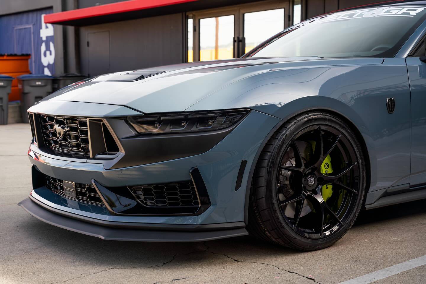

Few Images Came in From Our Customer Getting Ready For Lowering Springs
Project6GR 7 Spoke 20x10 20x11 Satin Graphite

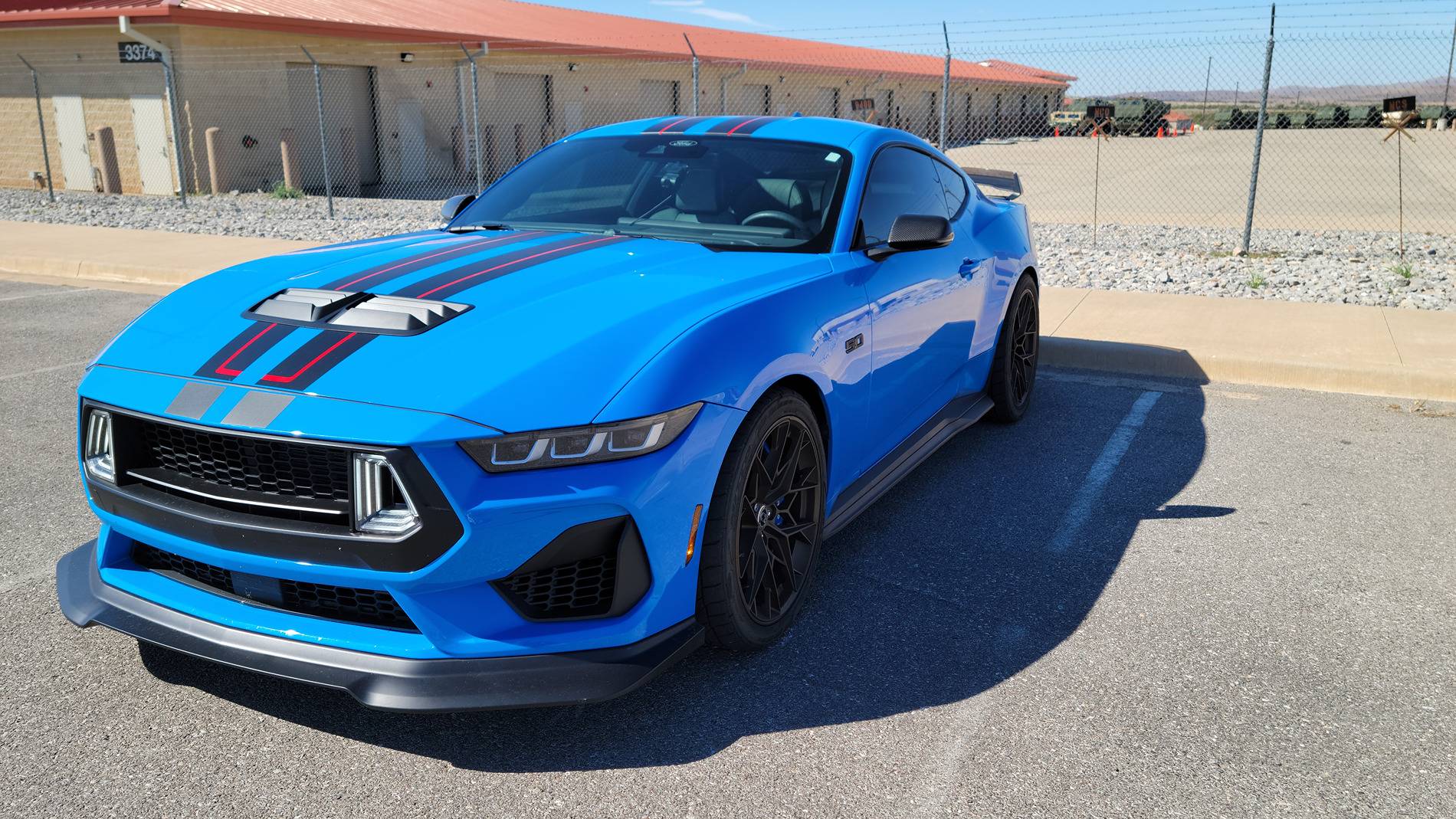

gaps will be filled in, might have slight rub up front on a full turn or bumps on on highway but it looks damn good for sure ! Here is a similar setup but on nitto NT555g2!

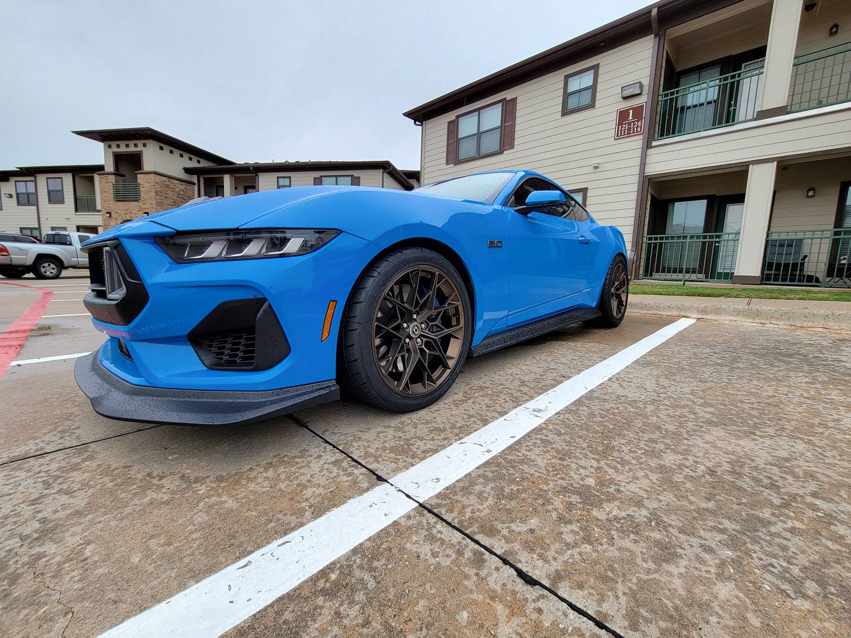

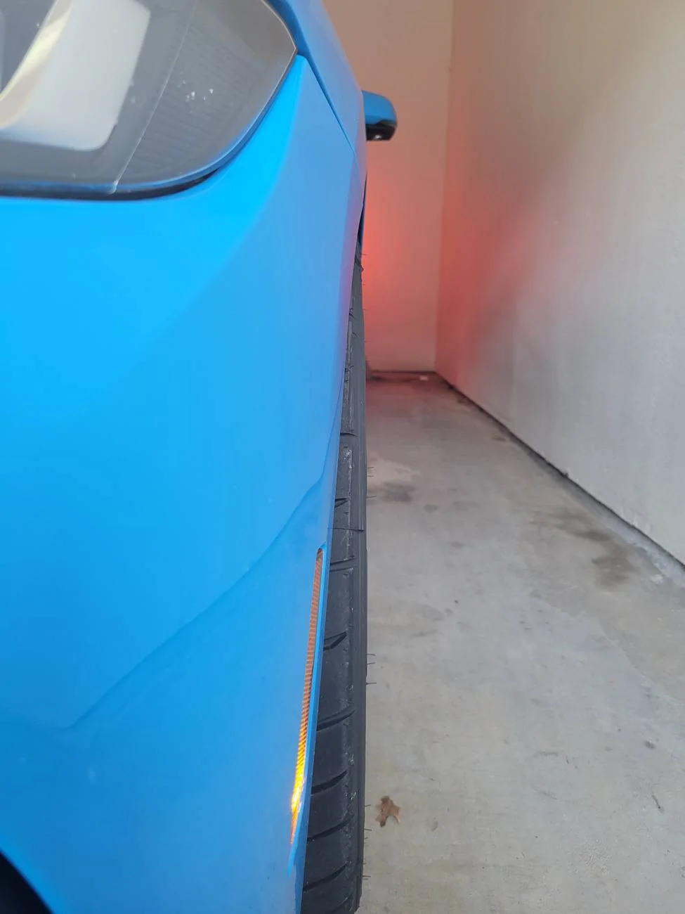

On stock suspension but there's easily enough gap between the edge of the tire and wheel arch so you shouldn't see that much rubbing.
