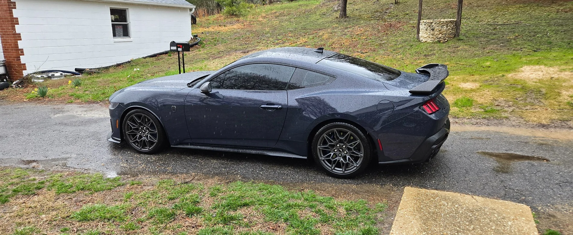

I bought a second set of PP rims on 1" spacers with all season pzeros UHPs on them. I was impressed with their performance last winter. Once they drop salt on the road here in MD I park the car until it has been thoroughly washed off the road.
S650 Mustang All Season tires for a Dark Horse with Handling Package 20250324_123157
