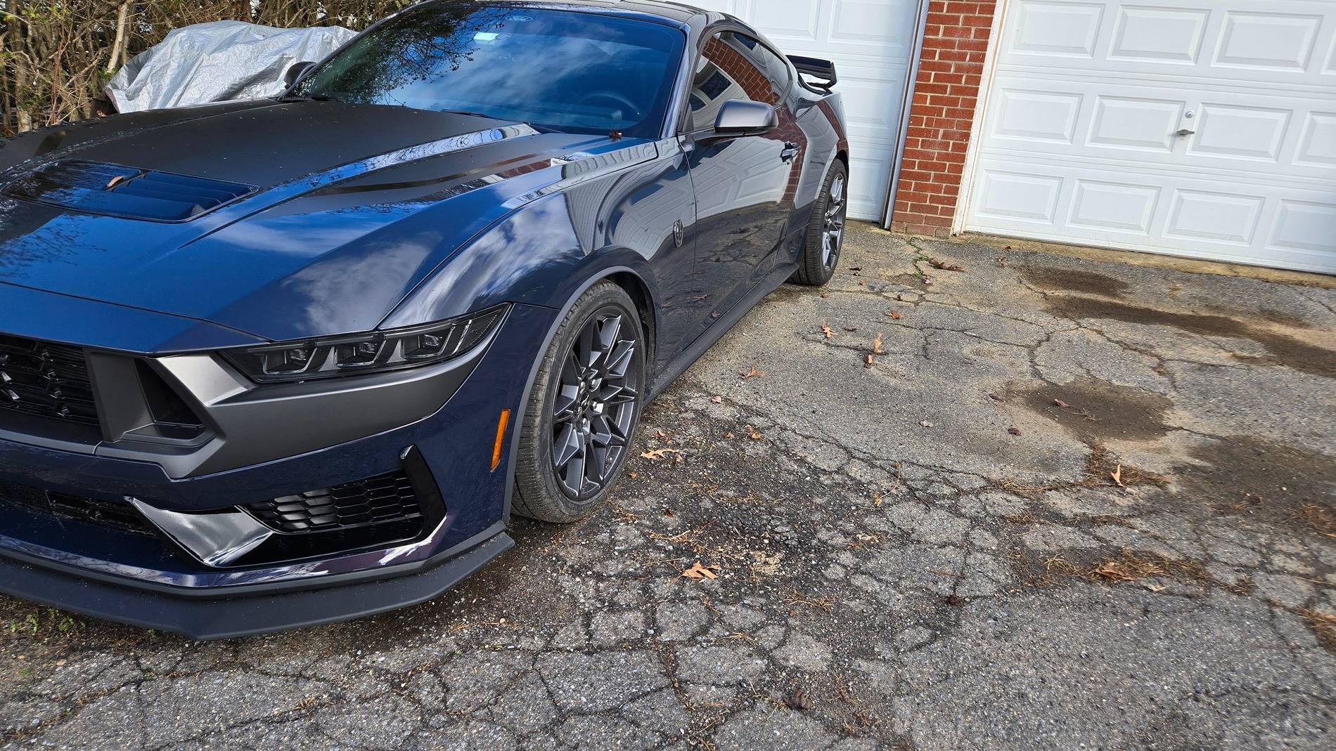

I don't know how well the clearance line up. I ended up putting GT wheel on my DH w/HP for winter tires. I had to put 1" spacers on them because the were tucked away inside the fenders. The spacers put the offset back to where the stock DH wheels sat in the fenders. You may need to measure the offset when you order rims to try and get everything lines up the way you want it.
