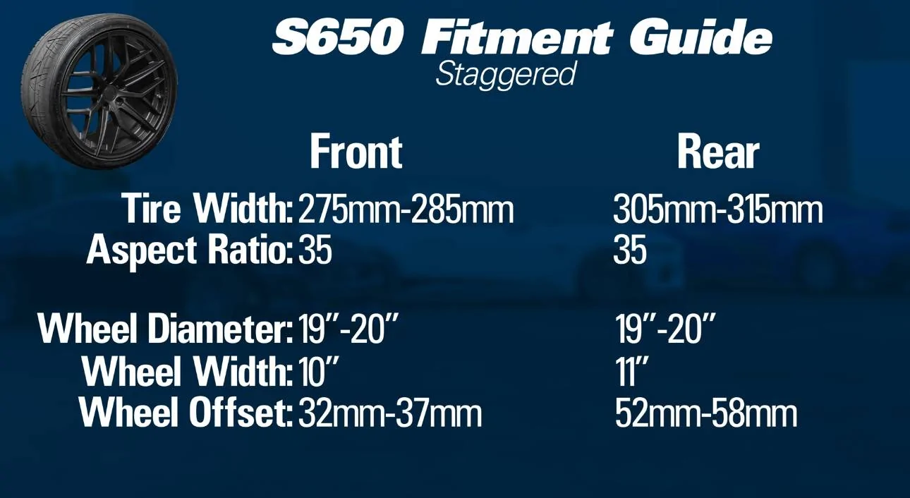

this is from steeda
and if you will go with 315 I think you will need a spacer so 305 is the safe choice here

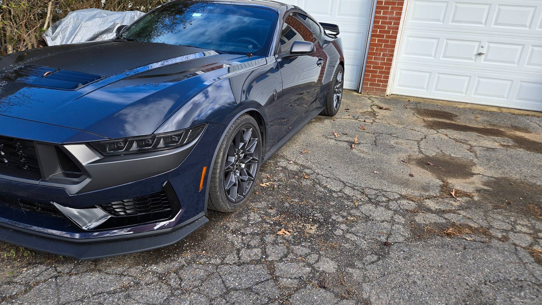

I have a dark horse with the PP. I took the 305/315's off for the winter and put on 255/275 Pirelli P Zero All Season Plus 3 UHP All Season on a set of GT PP wheels for winter driving. They seem to stick well, not as good as the Trefeos in the heat, but well enough for the bit of winter driving that I am doing with the car to not feel like I was going to slide off the road when the temps dropped below 45. These wheels were mounted on 25mm spacers. I went with a 35 on the profile to keep the wheel circumference the same as the stock wheels, but I should have went with the 40 profile to fill the fender gaps a little more and dealt with the speedo being off a little bit.
