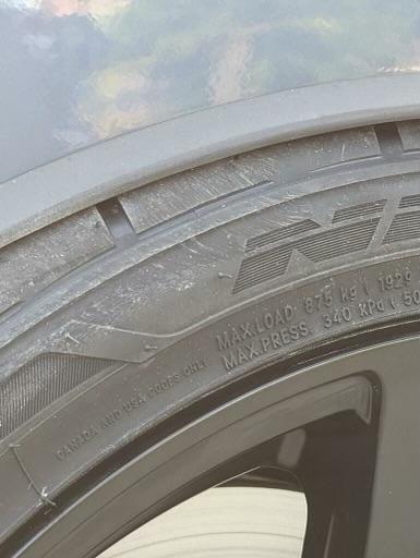

hey so i ended up getting 11/11.5 with 305/30/20 and 315/30/20s. 18 offset in the front and 58 offset in the back. im badly rubbing up front, what offset are you using for the 11s in the front? cuz i need to get a new wheel

Are you rubbing on the strut or fender. Normally you have to run a lot of negative camber to get that to work, at least on the S550 cars.

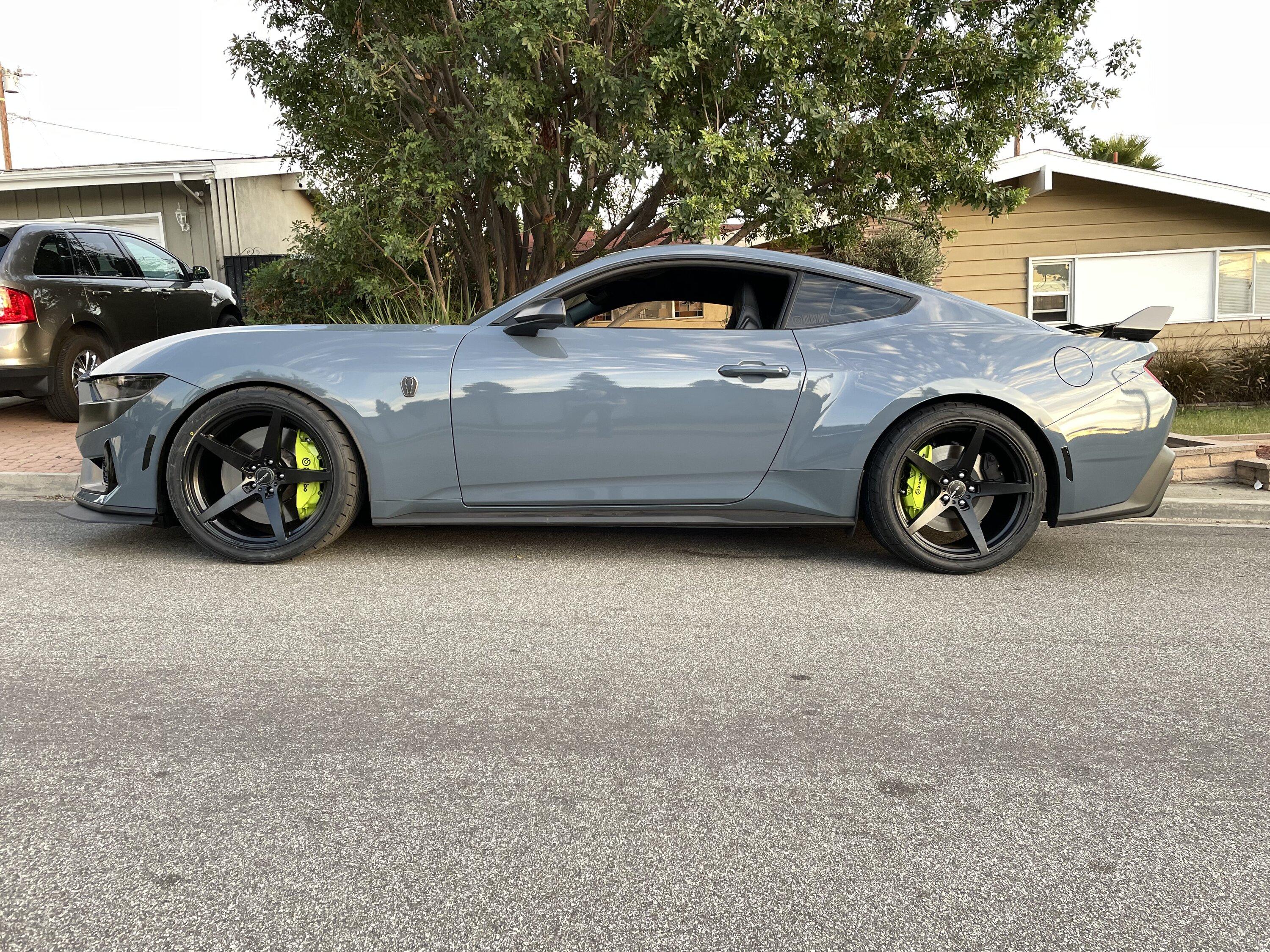

the fender under compression, like going up the driveway and such. I saw project6gr had a setup with 20x11 and 20x11.5 on a s650 and wanted to know what the offset/tire size was.
You need to run more negative camber. You will probably have to run camber plates to get what you need for negative camber since you are probably limited to -1.5 stock. You will probably need at least -2.5. Maybe some people who run 11's up front can chime in. Also looks like the car is slammed.

Ya nope it’s on stock suspension. That picture is under load though going up the driveway. This fitment was for the gt350 so i thought it would work. 20x11 ET18 and 20x11.5 ET58 The backs fit perfect but the fronts rub bad under load. I have springs too and I def can’t lower with that wheel lol

The GT 350 had wider fenders. Try more neg camber.
