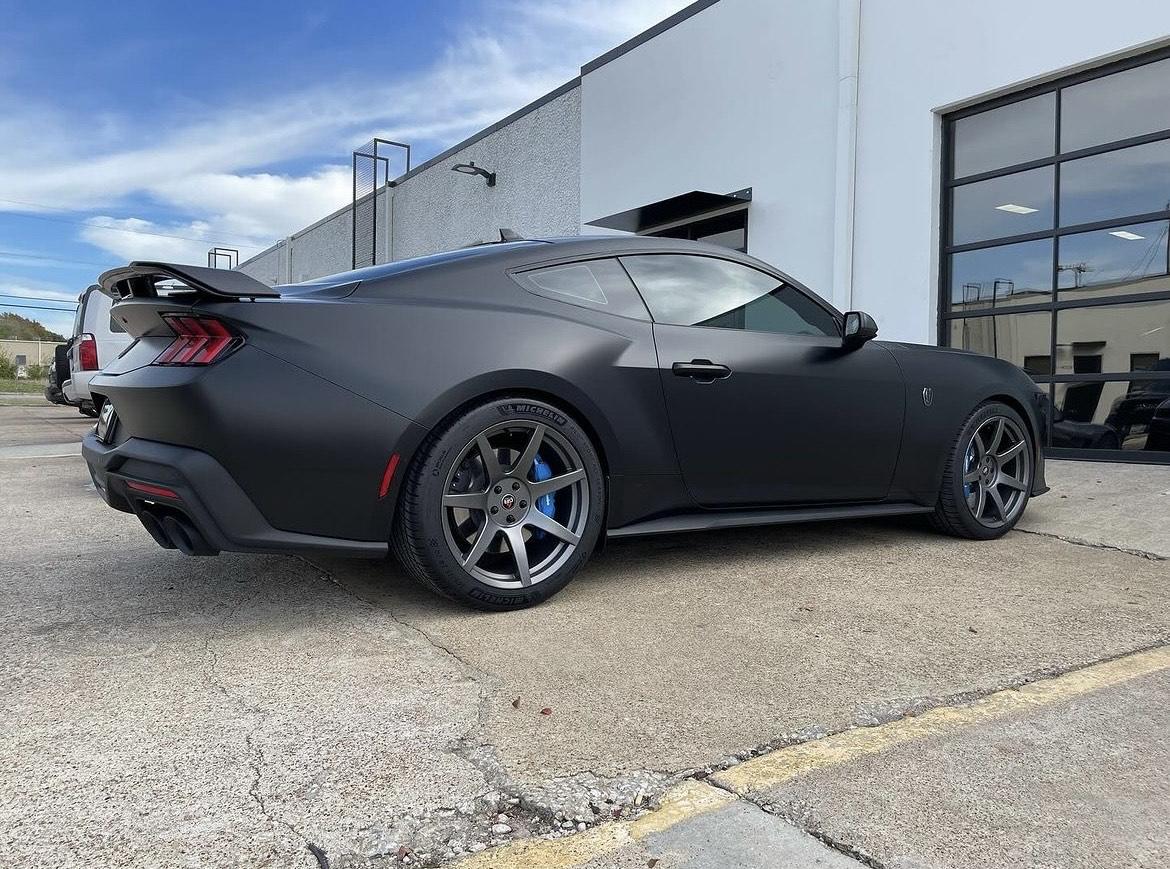

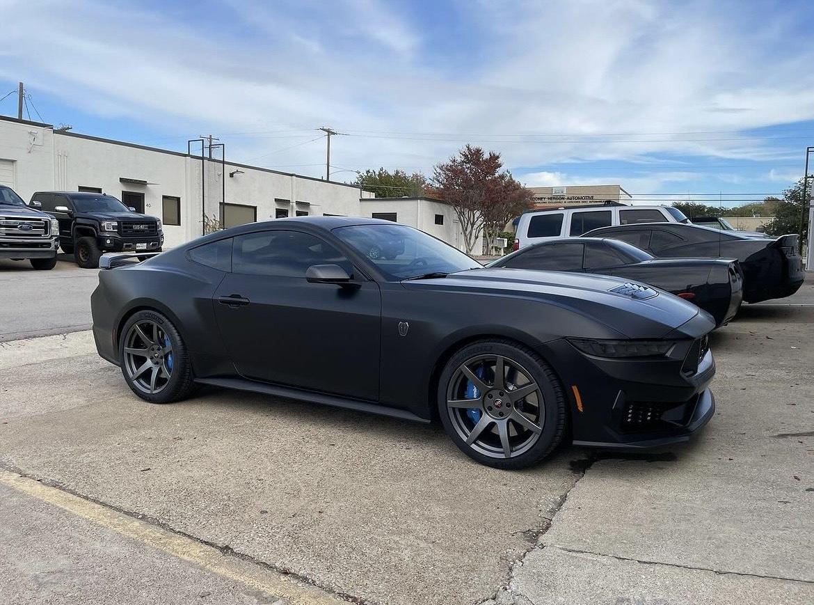

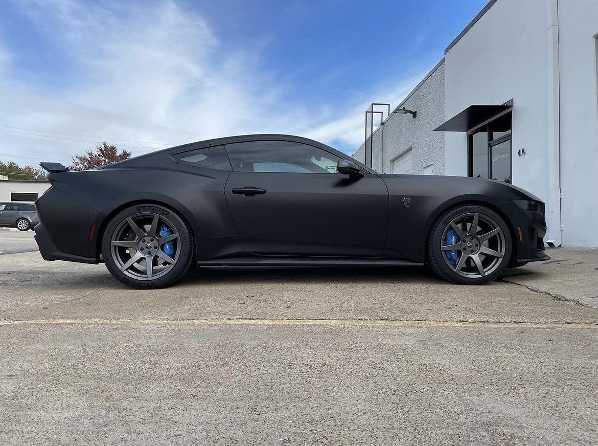

Isn't this Dark Horse a Non HP? I could be wrong and maybe it doesnt matter HP or not but I thought it did. I also have the HP and afraid to order wheels that wont fit over my calipers or rub... I want to change to 20's and prefer 305/345 if possible, if not than im fine keeping it 305/315s just changing from the 19s to 20s.

If you have the handling pack you have the carbon side skirts which allow us to run our R-Spec 11/11.5. Non HP would run 10/11 width\. For 305/345 you will need 11/11.5
