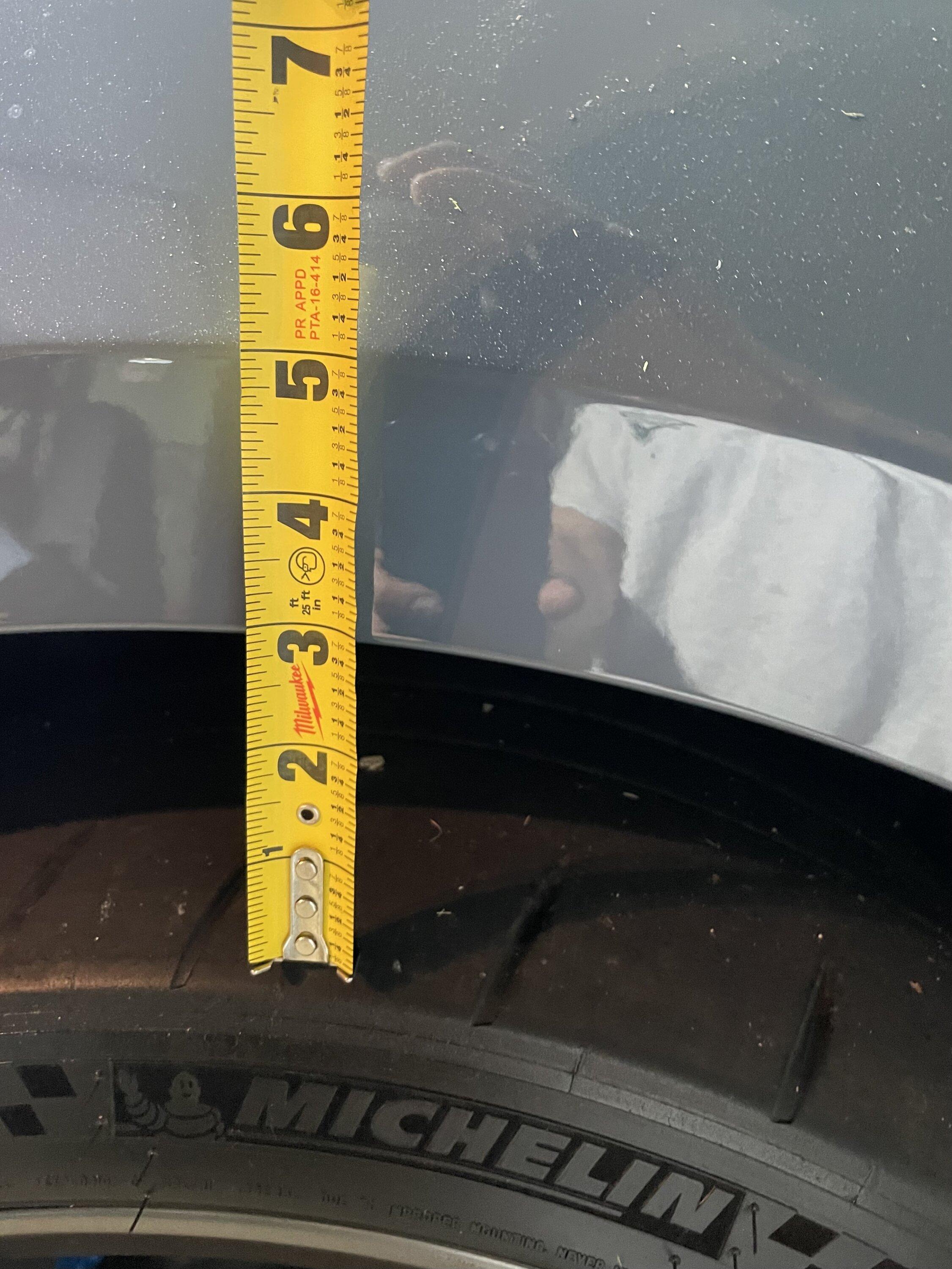

Hey there, sorry to hear you ran into some issues, hopefully they pertain to the negative camber. Although I measured 3 inches of clearance on the front wheels with stock height (10.5” front wheels). The only difference is I did not order magnaride so perhaps the size of the MR strut is different to the size of the regular strut as I have not experienced any rubbing. As for the thread engagement I have not noticed anything abnormal, it seemed a little tougher installing the lugs on the HP wheels compared to the OEM but nothing where the lugs didn’t fit snug. Best of luck and let me know if you have any other questions.

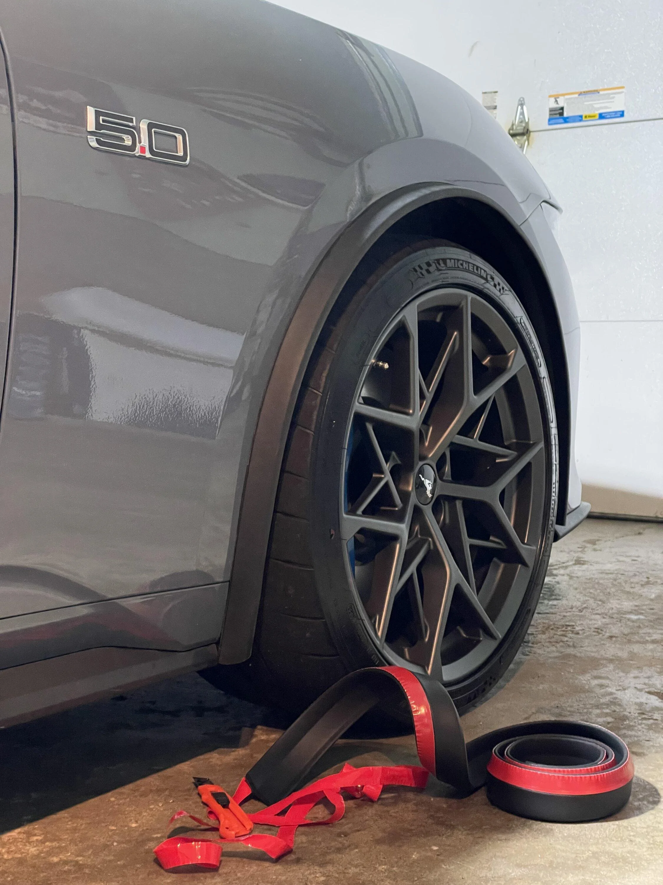

Sorry for the late reply, but they are 19x10.5 fronts and 19x11 rears. I would like to lower the car but i have a pretty steep driveway that the car just barley makes as is without scraping. I ended up putting those tacky flares on the car and I'm surprised at how nice they turned out. Based on them being peel and stick i assumed they would have fallen off after the first few drives, but after a few days they are definitely secure. Granted this could be my subjective opinion, but it makes these wheels not only look more OEM/clean but does a great job with rock chips. Keep in mind that they're meant for SUV's/trucks so they're not perfect, but they do the job. Here's a link to them on Amazon for anyone interested: Amazon.com: EZ Flares – The Original Universal Flexible Foam Rubber 1-Inch Fender Flares : Automotive
I have the same issue. My driveway has some good undulations and when I had 275/35/19 front and 295/35/19 rear with the Ford Performance Track Kit it would rub. I went with 285/35/19 and 305/35/19 no more rubbing if I left at the same angle. So if you lower the car, you may want to move to a taller tire.

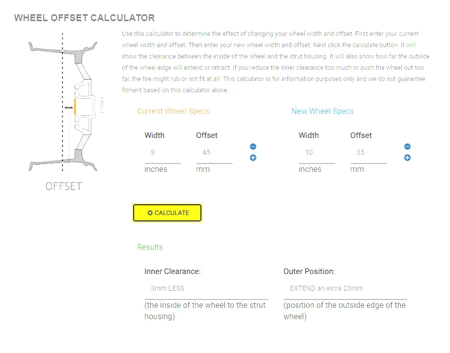

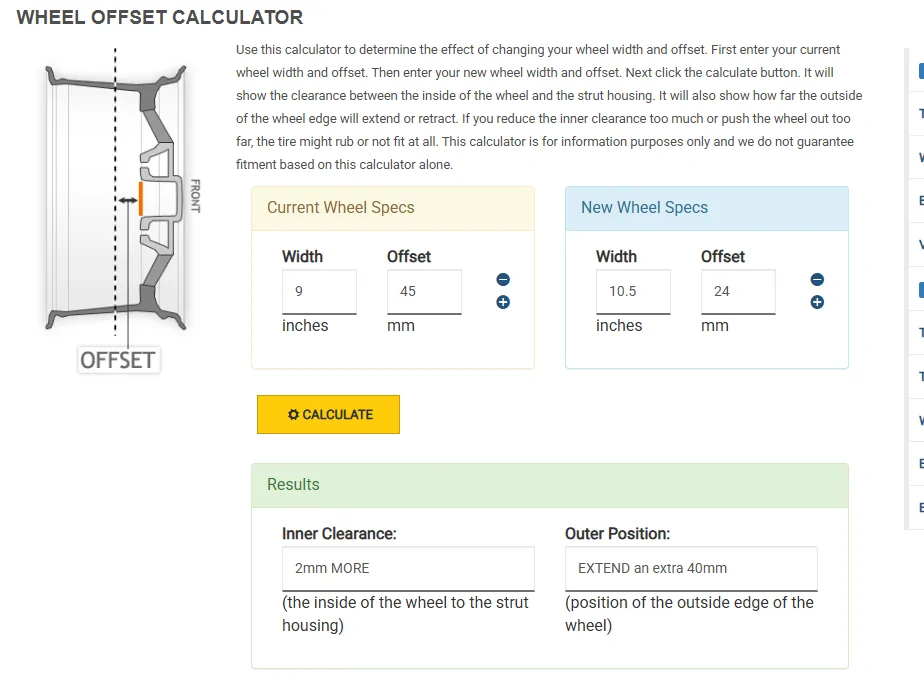

Sorry to revive an old thread but i want to provide an update on the Mach-1 HP wheels; after driving on them for a couple of months i noticed a thin scratch forming on the inner barrel of the front rims. I tried to root cause where the wheels are rubbing but could not figure it out. I did some research and concluded that there's about a 21mm difference in offset between the front OEM Performance pack wheels (+45) and Mach-1 HP wheels (+24). Since the Mach-1 HP wheels have a smaller offset would it be safe to say that they should not be used? If anyone experienced in wheel fitment could provide insight it would be appreciated as this is all a learning experience for me. @JediMindTrix Did you have a similar issue when fitting these wheels on your car?

Yeah rears were fine. I noticed the fronts were rubbing on the strut.
