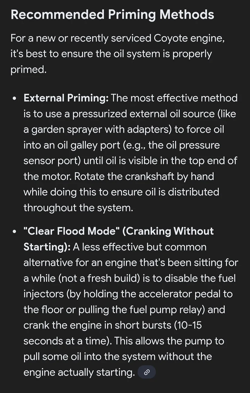

Heres something I found. I suppose the priming is the ultimate way.
I brought this up to learn , so Im open to all advice.
That is obviously an AI driven search response - where does that link lead too?
Trying a similar search myself generates a similar response with links leading to Youtube and Reddit discussions that then link to what to do if your car oil filter cannot be pre-filled after an oil change, which is not the case with the Coyote.
This is one of the problems with AI if you don't check the links and sub links. Not just that the AI then scrapes from a forum like this where it suddenly seems that you must do this after an oil change on a Coyote now, which then keeps feeding back to reinforce what was never true in the first place!
I don't know whether the process is good or harmful but I wouldn't make too many assumptions based on the information so far.
