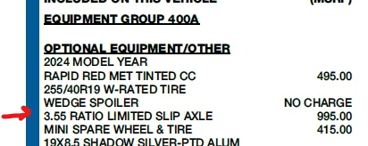

My dealer does full synthetic 5w-30, i wouldn't run anything other. lol
S650 Mustang Oil Pressure after hitting up some twisties 1768400911469-f1
I have the 3.55 diff gear, they tend to run a little higher oil temp just because it's going to be slightly higher rpms for the same given gear. I think an oil cooler is a must on my build just because of it. I mean i wouldn't give it up, it makes a pretty big difference in the way it accelerates. At the track the car will be about one car length ahead of a stock gt in the 1/8th mile, so it's significant.
