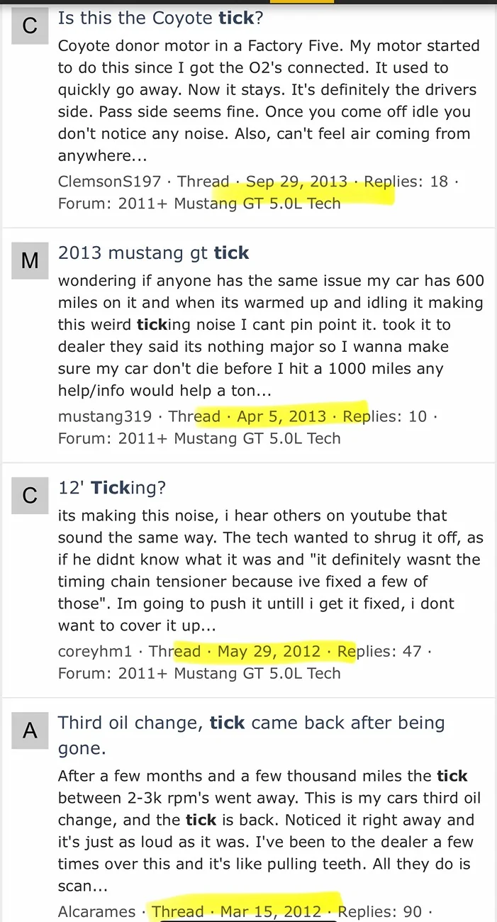

Coyote tick is also normal. Been that way since 2011.
