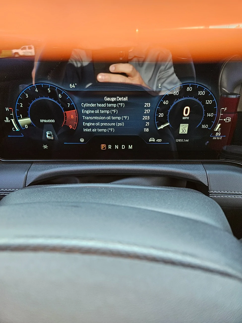

My 24 S650 GT Premium asked for a SW update when I got home last night. I told it to update now and wwnt inside. This morning, when I finished my 12 minute drive to work, I looked at my oil temp and it was 206, which seemed odd as its usually under 200 for such a shot trip in cool weather. As I sat parked, idling, it climbed slowly to 212. I took a short drive to see what would happen. It climbed to 224 while driving and when I parked again it seems to settle after idling at 217. Before the update it would quickly settle while idling around 195. Coolant temp is normal. Attached picture is after about 10 minutes ofnidle with no hard driving.
S650 Mustang Higher Oil Temps After Sw Update?? 1000001055
Anyone else notice this behavior after a SW update?

Inlet air temp is 118˚ but you say it was a cool morning….maybe the update messed with calibration?
To be fair, that was after a good 10 to 15 minutes of idling.
Just called my Ford dealer and they said unless the temps climb to over 250, they aren't concerned. Said sometimes the sensors will have this issue every once in a while and go away. Suggested I watch it for a week and call back if still concerned.

Ok, but those air inlet temps are what I see this time of year in Phoenix. It couldn't have been a "cool morning". Lol
And why are you letting it idle that long?
I let it idle so long to see if it would cool down. Normally dont do that. I'll keep an eye on the IAT as well. Tbh, it seems normal IATs for long idle, you can see in my pic it was 64F outside.
Idling gets the temps warmer not cooler. You need airflow. 👍🏻
Before this SW update, even a short idle would bring temps down to 195, but I can see what ur saying. I think this is an overall "keep an eye on it" situation.
Idling senario aside, the oil temps you saw are normal.

As a follow up, while driving home on the highway at 70 mph, 75F ambient, it held solid at 233F which is the first time I have ever seen my oil temp go over 230.
