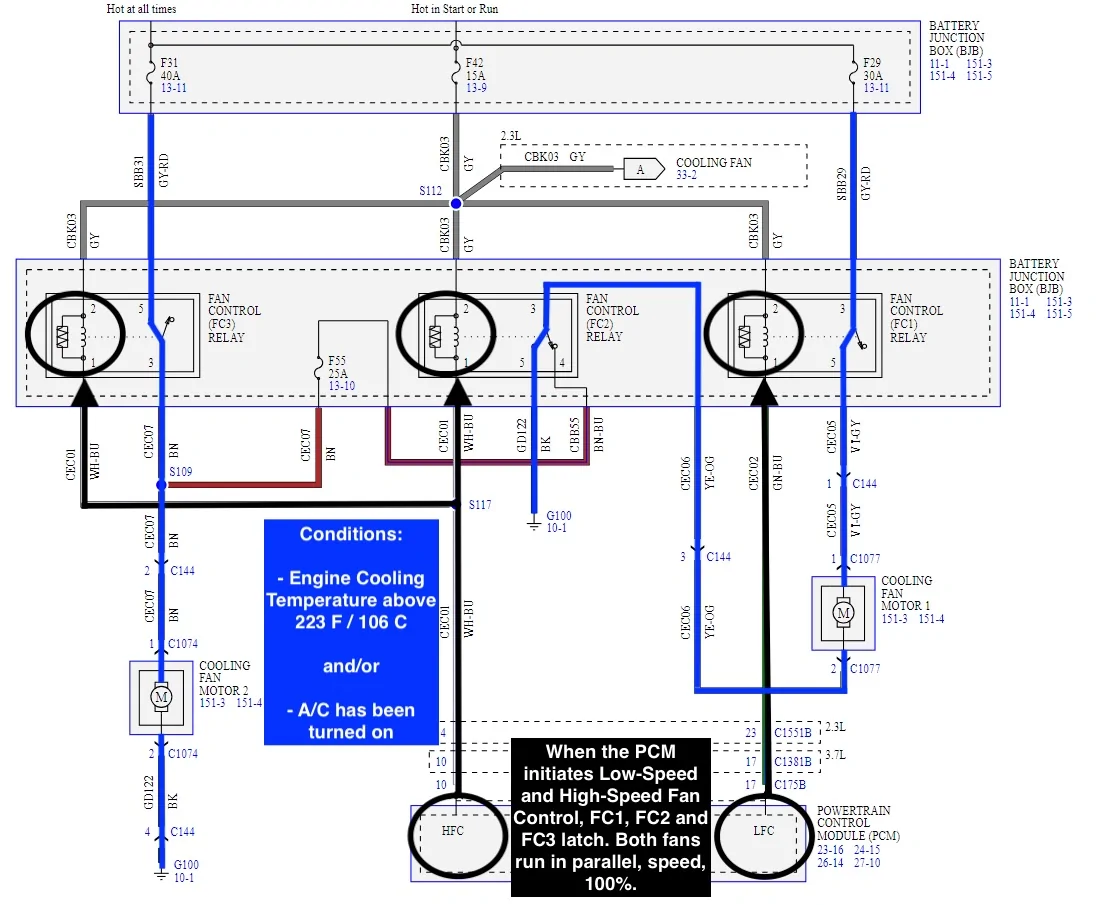

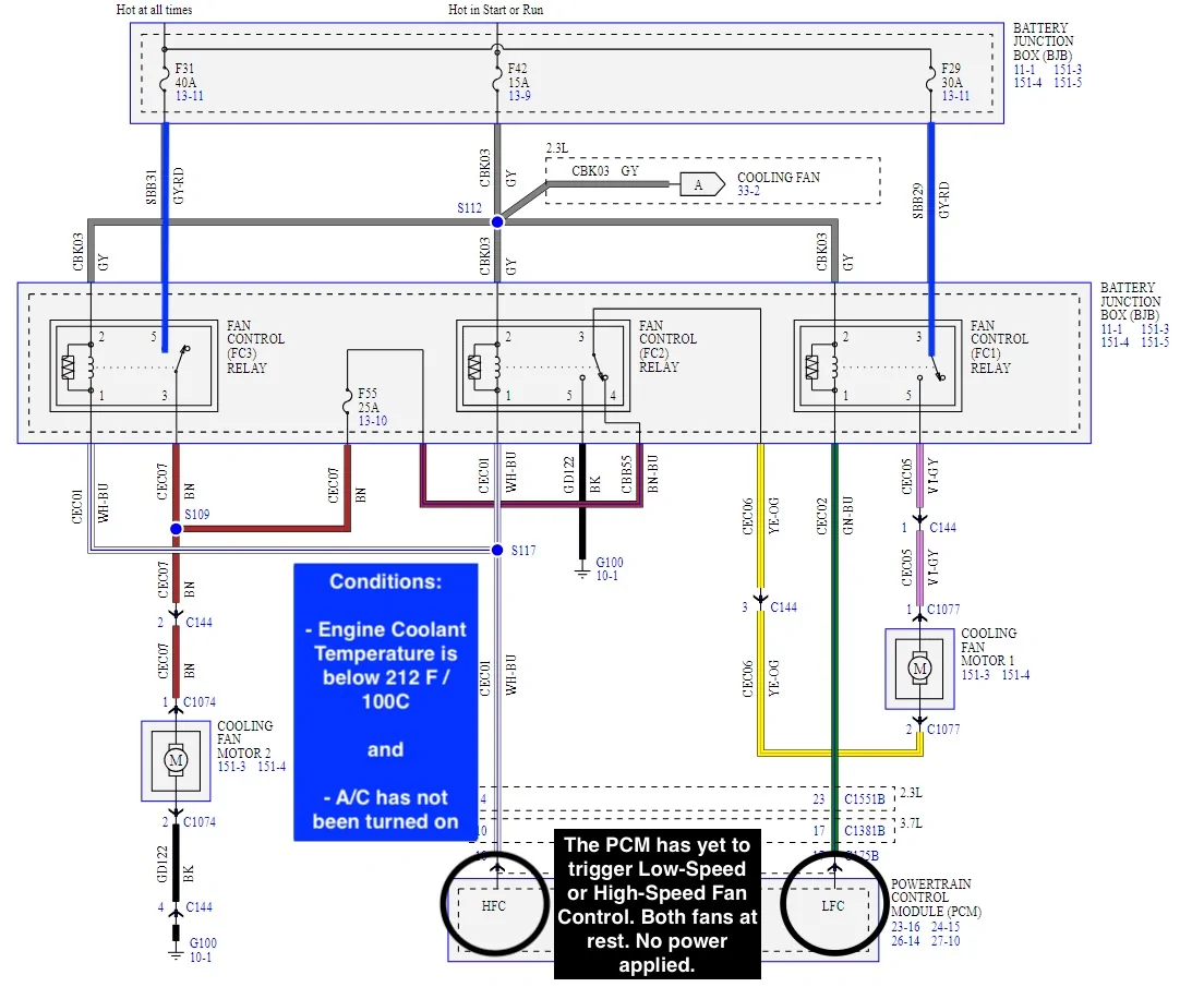

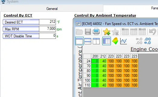

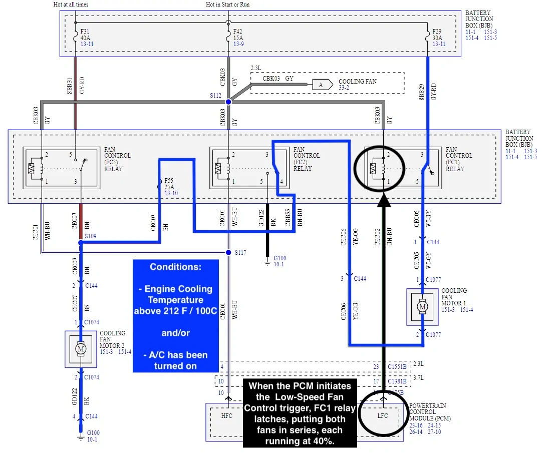

Using the S550 as a reference...
As to why operating the A/C generally results in cooler engine temperatures, that occurs due to the radiator fans. When the A/C is turned on, both radiator fans immediately begin operating at 40% power. If temperatures continue to increase to a given point, both will spin with 100% power.
The purpose of the fans engaging is two-fold: 1) to draw air across the A/C condenser, for better heat* transfer, 2) to keep the powertrain cooler (A/C condenser is now adding heat).
Why two fans? Fans are to a radiator as pixels are to a photo. The smaller the fan, the greater the coverage (higher resolution).
Why run both at the same time? More uniform cooling across the face of the radiator.
* There's not really hot and cold, but heat and less heat.
When it enters the low side of the A/C system, the liquid refrigerant expands into a gas; this process requires heat, the energy inside the interior of the car being the source. By turning from a liquid into a gas, the refrigerant absorbs that energy.
As the gas enters the high side of the A/C system, it's compressed back to a liquid. The heat taken from the interior now needs to be removed, the A/C condenser acting as a radiator, the fans hastening the heat transfer process.
By getting the liquid as dense as possible, it allows for the best energy transfer when it re-enters the evaporator core in the interior of the car.
It's the same process for many of us with a home system involving a compressor and fan outside. The evaporator core is inside the home, in the ducting. The compressor, condenser and fan is outside.
On a small scale, you can experience the same when holding "air in a can", using it and noticing how the can is cooler. On a grand scale, Liquid Natural Gas ships first super-chill, condense the product at the filling terminal, then later expand the product at the receiving port (very, very slowly). :giggle:
^ Chart of Engine Cooling Temperature parameters and fans, S550, above.
The Coyote has a Cylinder Head Temperature (CHT) sensor; this sensor rests in the back of the head, passenger side. The sensor itself is a thermistor. The resistance of the sensor changes with temperature, with any reference voltages then adjusting as a result. The CHT is what we see when viewing the in-dash display.
Some manufacturers will produce engines with Engine Coolant Temperature (ECT) sensors. These sensors rest in a coolant jacket and read liquid temperatures directly. The Coyote does not have an ECT sensor. In the Powertrain Control Module, software derives the ECT from the CHT. Fans are then turned on/off based on the ECT and other logic.
One can think of ECT as a raw reading at one point in time, while CHT is a measure of everything. ECT + engine load = CHT. ECT can be read with scanner/tuning tools and software. Under light loads, ECT/CHT could be pretty close to one another, while during more spirited driving, ECT/CHT could differ by as much as 10+ degrees, the ECT always being cooler.
That is all how I understand things to operate
