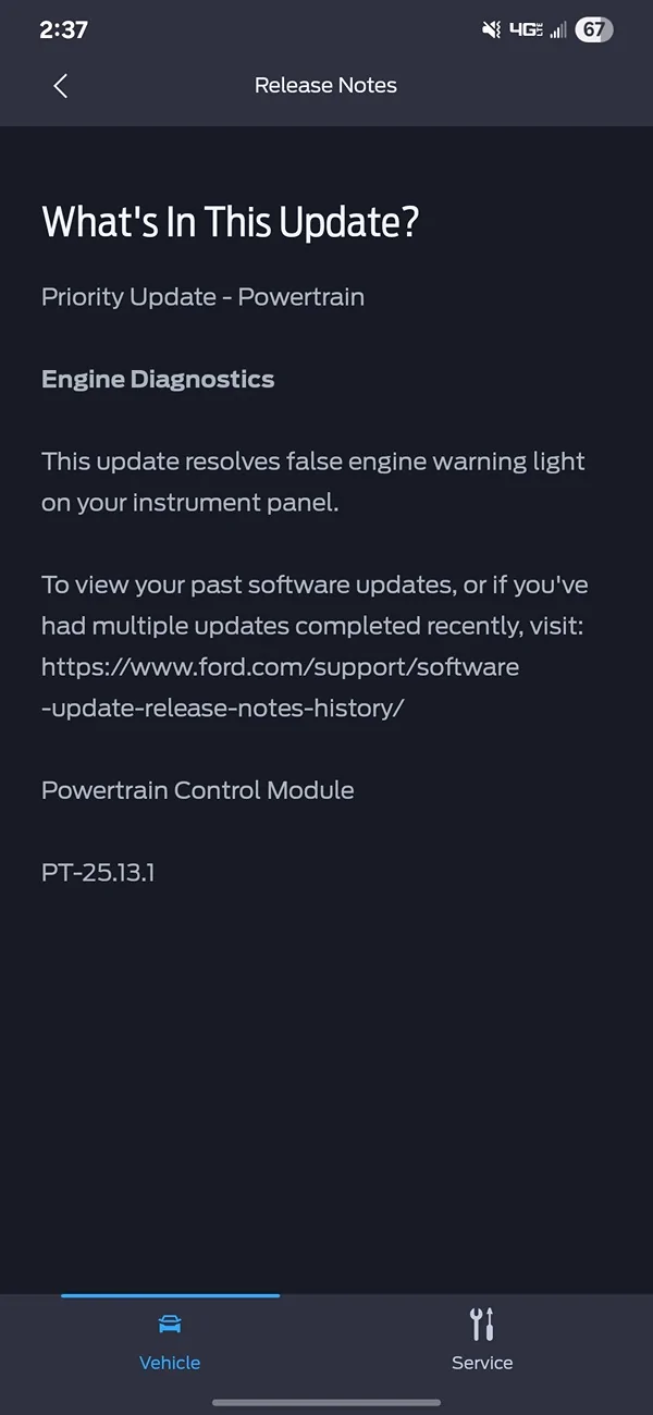

Which update was this? Was there a description and number?
