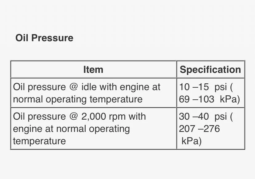

@GeekGT5.0 ..... you are okay. Remember "today's" synthetic oils run thinner (they have too) and are formulated to do so. Their VI's (viscosity improvers) can form long chain polymers to protect against engine heat and even spikes in a nano second. Two suggestions: I have a 2024 GT and will soon have a 2026 GT and I have and will always run FULL synthetic as it is IMO a universe different than semi-synthetic or synthetic blend. I only use Ford FULL synthetic and Ford oil filters. Ford has an amazing base stock and superior VI package. Second, if you are going to have some "normal" fun and having a 3:55 considering an augmented oil cooler for the engine and even transmission sounds like a wise idea.

10 psi/1000 rpm under load is normal optimum pressure for function and longevity. I have confirmed this with multiple respected Ford/Coyote builders. In a race I see 100+psi cold start, 95-100psi warmed up above 2300 rpm-7700 and end of race/session 80-90 psi with oil temps of 240-250 actual/255-268 Ford ECU inferred. My combination is GT500 pan/pump, Setrab 960 oil cooler and -12 lines. At idle warm/hot the car will see psi as low at 28, which is not an issue, DHR cars we see it as low as 26 which sometimes causes the warning to illuminate in the MoTec dash, totally acceptable as long as running at load pressures are in the limits.​
The poster is an actual race car driver (Ford Dark Horse R)
