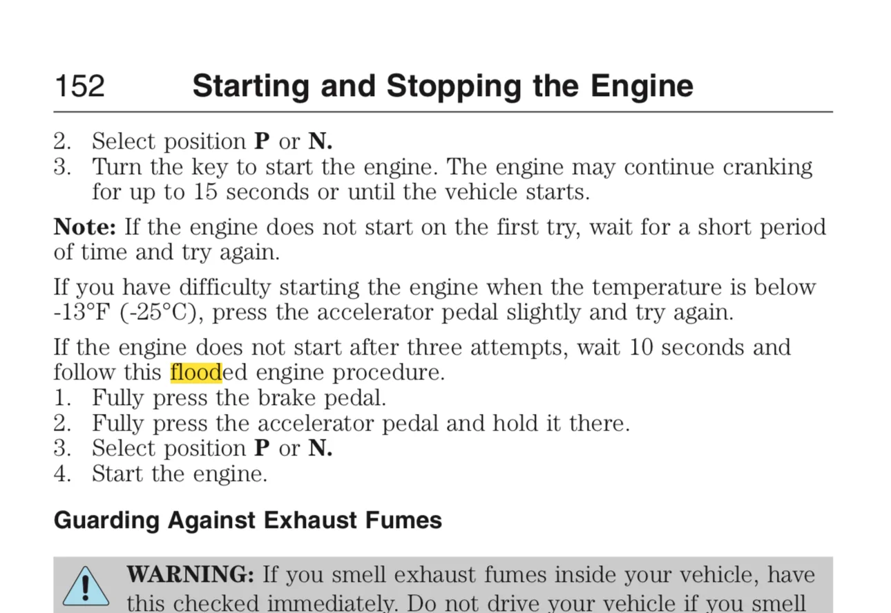

Where does it state this in the manual, and how long is sitting for "a while"?
It's in some years manuals, and it's flor clearing a flooded engine, not building oil pressure
We had this discussion either here or on 6G and there's some goober that does it when he hasn't driven the car for a few days...

So you're ignoring what ford tech instructs you to do? Why? Sounds like you're the one disregarding information.
it's not a small block ford with the old, different style oil pump.

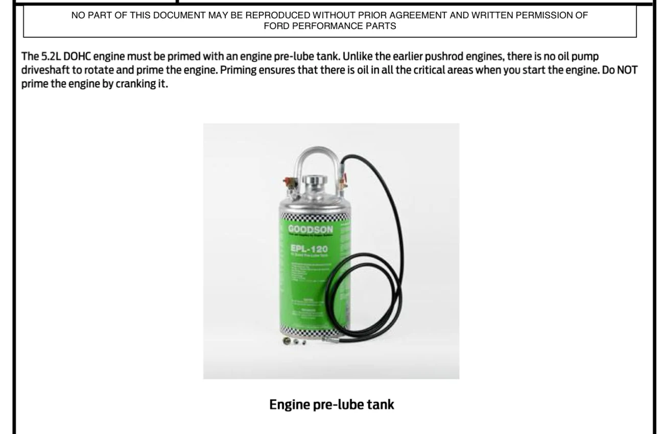

What you shared said 5.2liter , Wouldn't that be a Vodoo or predator engine ? They require higher oil pressure , so it may not apply the same to those engines. Also in high performance applications, I could see them recommending the oil pump over the "flood procedure"
Are you saying a Gerotor pump will not push any oil during turn over ? I read the opposite. Granted it isn't building much if any pressure, it still will push oil. No ?
I am definitely not a engine guy so I could be very wrong. I would like to hear why you say it won't pump ANY oil ?

Yes , I 100% agree. You HAVE to prime a rebuild or freshly assembled engine with a oil primer pump. It states that clearly in a lot of what I am reading. Do Not use the "flood procedure" I never said to do this after you reassemble your engine. lol.
I honestly could change my opinion, but you have not shared anything that does yet.
Do you think the oil pump does or does not push any oil during cranking ?
It's the same oil pump design.

It states that a Gerotor pump doesn't self prime very well ,if at all from what I read. So yes , you would need to push oil through the system after a rebuild or it will simply air lock and not pull oil. Once the system is primed , and granted it doesn't drain out , it will continue to push oil. If it didn't, how would it if you just fire it up immediately?
So I will assume you do not think any oil gets pushed during cranking.. ?

If it got to the top of the engine, they wouldn't say to use another method
pop a valve cover off and try

You cannot build pressure by turning the engine over with the starter on a modular engine. It's a Gerotor oil pump. Doesn't turn fast enough, ford even says this in the engine docs. It's not like the old style engines and oil pumps. You can pre-lube it with a pump
Is that on a newly rebuilt engine, or all?
