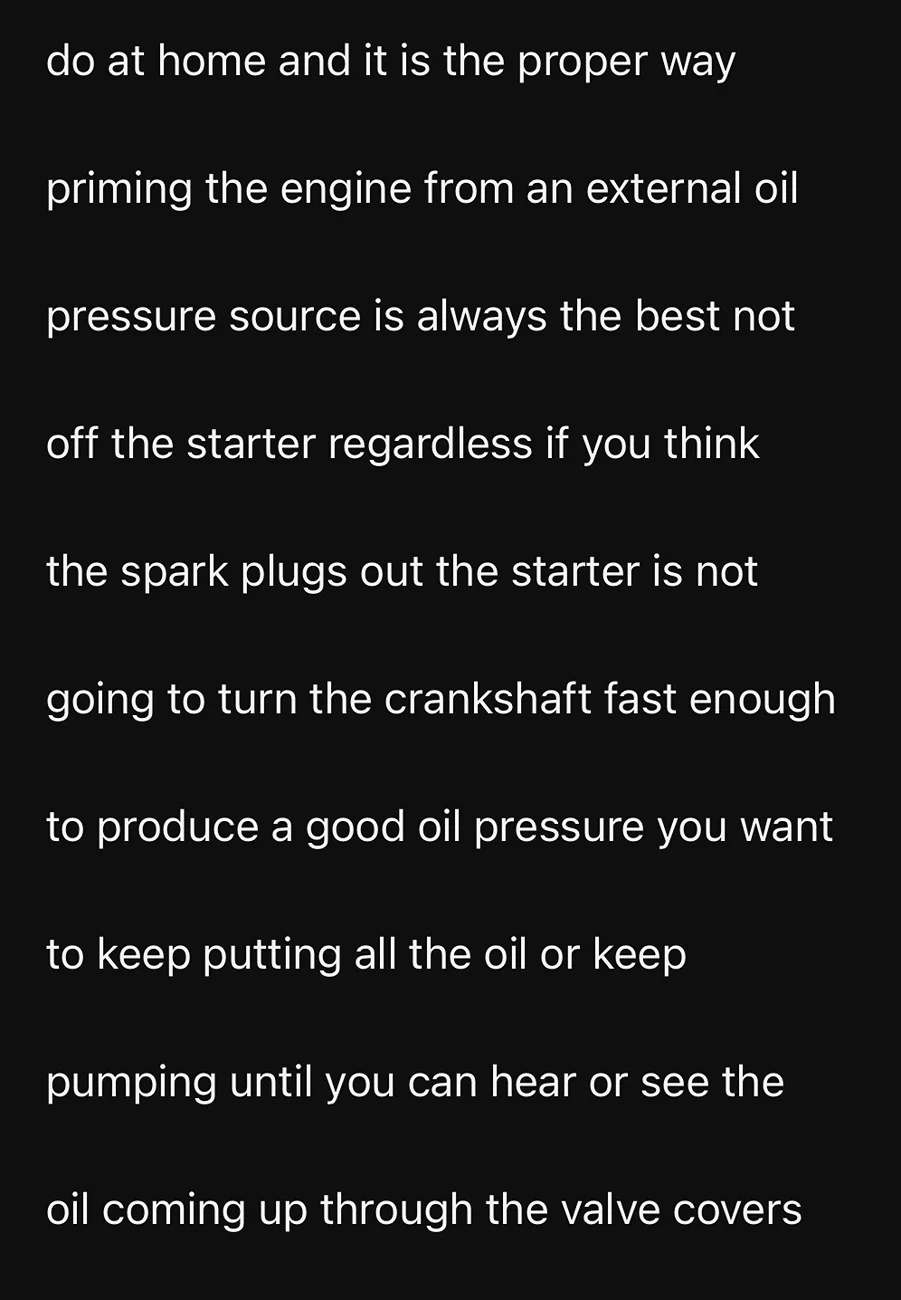

Ford saying "do not prime the engine by cranking it" doesn't mean anything I guess.
When you turn the crank , oil flows. A Gerotor pump is a positive displacement pump. A set amount of oil is pushed every rotation , regardless rpms.
It doesn't flow as much as the engine starting up. Too low of an rpm from the starter alone.
