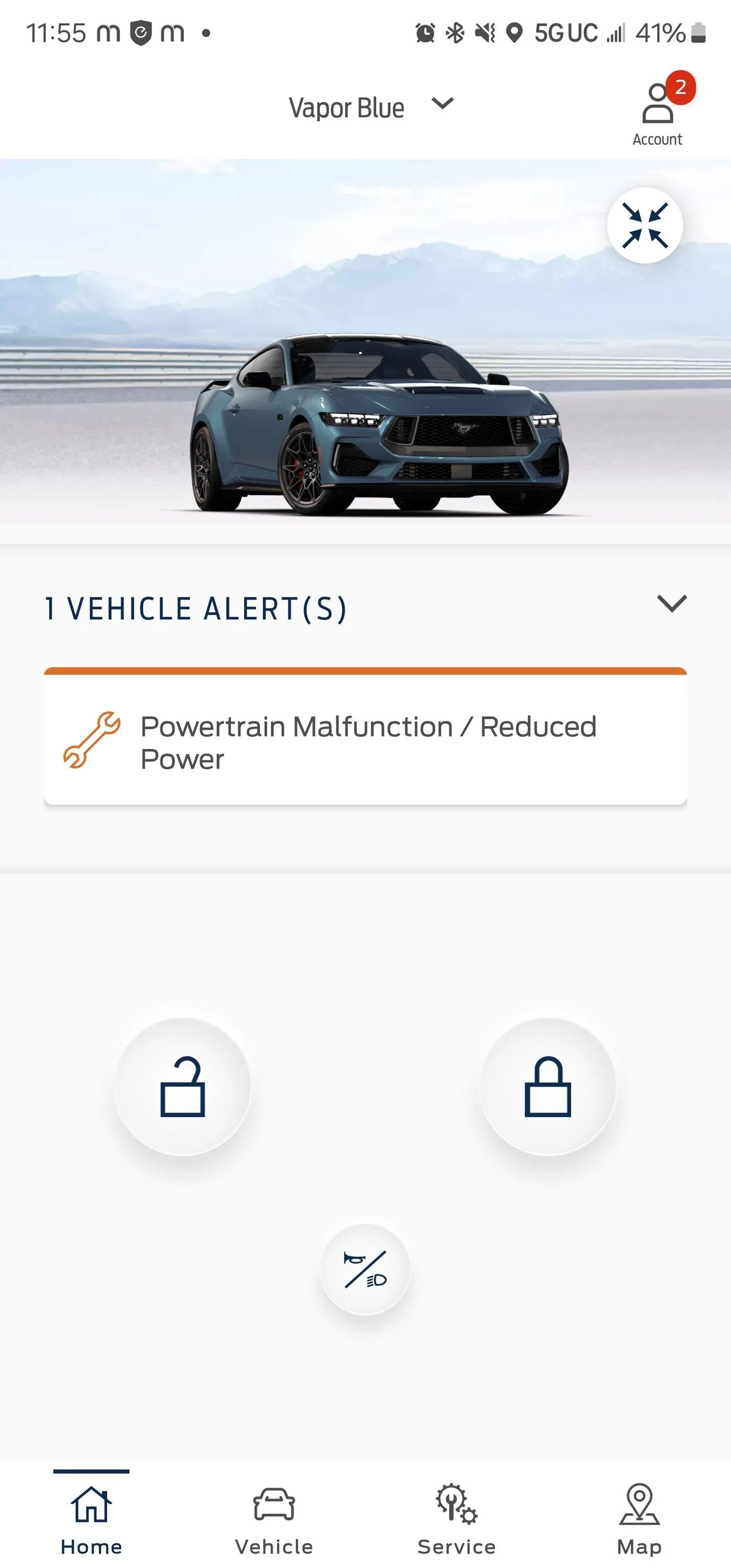

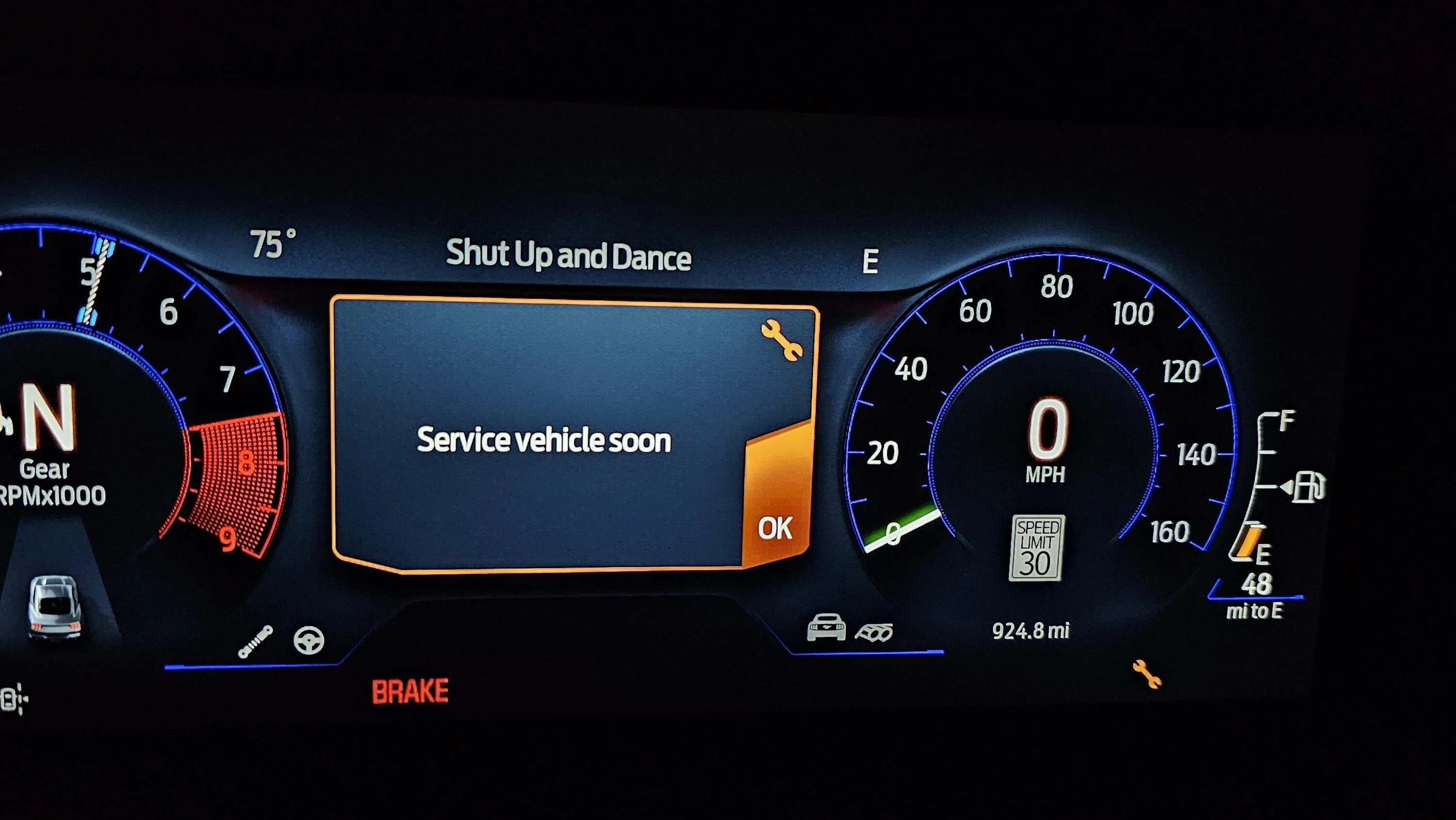

Just under 1000 miles and started up my car tonight after it had been sitting for 5 hours and was presented with a pop-up that says Service Vehicle Soon and now a small wrench sits on the bottom right of the dash. Way too many issues with such a new car. Anyone have any insight into this. I have been babying this thing from day one keeping it under 4k rpm until I hit 1000 miles and now this crap @Ford Motor Company

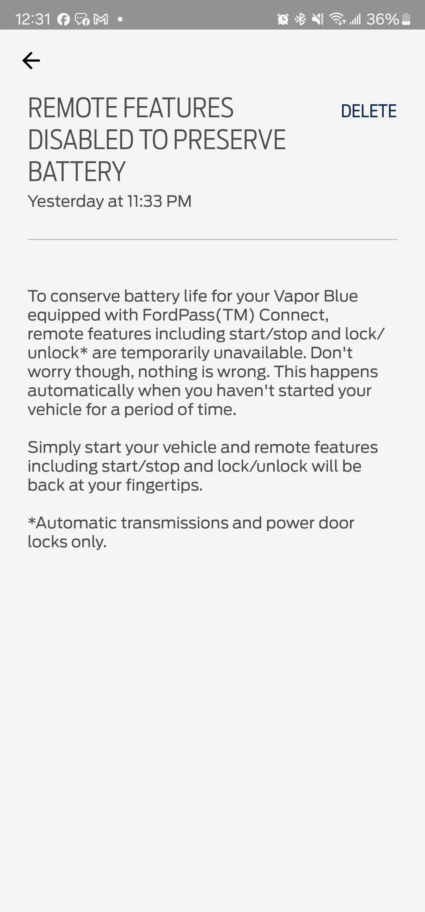

I was looking through the Ford pass app and noticed this message was tossed up at 11:33 just minutes before the service vehicle soon message was displayed. Which makes no sense because the car is my daily driver and is driven all the time ...

Most likely common weak battery issue. I was getting the Fordpass disable features several times a week. Though the car would crank up cold start no problem. I took it to the dealer to have the battery tested. Passed all tests was little low so they charged it up. Came home that day next morning got the Fordpass disable notification again. The key fob is not disabled so no big deal, I never start the car with the app anyway.
Dealer confirmed my suspicion,this car has so much draw on it that Remote Features disabled is just a protective measure. I keep mine on a battery tender now and have not had an issue since.
Mine is a almost daily driver though short trips on a daily basis is just not good enough to satisfy the battery and low RPM driving does not help. I know there is no official break in period though I have been gettin on it much more and it is really running like a beast. This car does not want to be babied, good thing for me.

Not to sound like a dick but this is a new car and legit Your problem is a weak battery. I hate when ppl have little understanding of how things work and cry when a minor malfunction happens on a brand new style vehicle.

Quit babying the car. Like another poster said, drive it like it needs to be. Babying a car too long is not the best option. After 500 miles it’s good to go.
As for you issue, check the battery voltage. If it’s low then put a charger on it or take it to the dealer and have them look at it. You shouldn’t be having this issue on a new car daily driven so you could have more than normal parasitic loss and if you are only making short commutes you aren’t giving it enough run time.

Ford recommends driving the car at least once every two weeks; it is around this time that Deep Sleep Mode will often engage; it should not be entering that mode more frequently than that.
If Deep Sleep Mode is coming on sooner or more often, that could be a tell to a few broad issues:

Powertrain malfunction is minor?

Went out to the garage this morning and the first thing I did was read the battery voltage not turned on It was sitting at 12.45v. I decided to go ahead and turn on the vehicle and lo and behold like magic no pop-up about service vehicle soon and over inch icon in the bottom right-hand corner. Going to drive the car here in a little bit hopefully this was just a fluke and not the beginning of something serious

12.45 is plenty of voltage. 12.7-12.8 is roughly 100% charge so your battery is roughly 80%. Our Pontiac would start fussing when the voltage got down to 12.2-12.3 even though that’s still considered good voltage.
