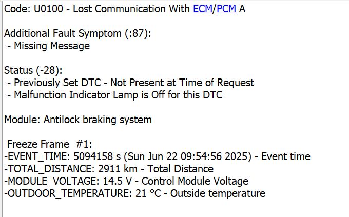

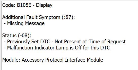

FORScan shows:
ABS U0100:87-28
APIM B108E:87-08

Sound similar to TJ HUNT’s GT, ended being cracked piston(s). So idk maybe take it in to check. Popping and burble is normal but with power loss is not normal.
2,681
4,068
an advisor at my dealer just had to replace an engine in a 2024 GT with 11000 miles. cracked cylinder 7 piston, bent valves with the actual valve heads sideways in the head or missing. customer just said it "died in flight", likely not explaining the actual events due to the potential for the engine not being covered by warranty
