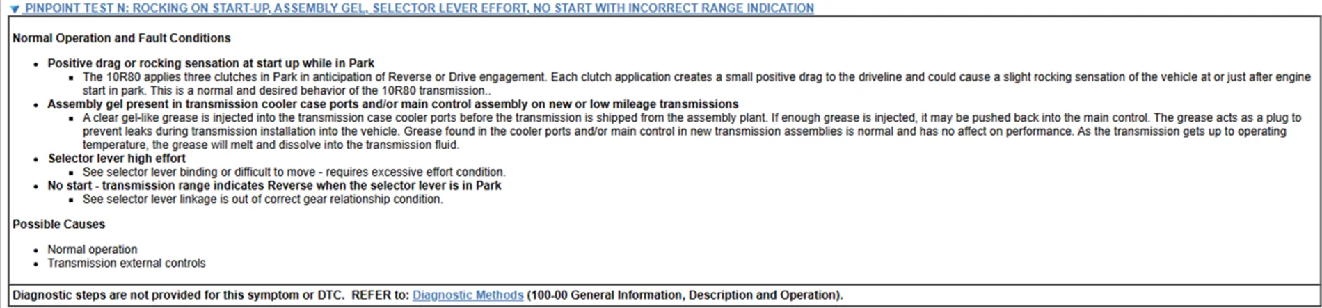

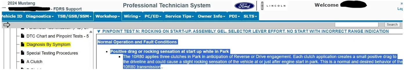

The Ford Europe "engineer" said 'all normal' and even issued a new TSB. Unfortunately he said the "rocking at startup" is normal ... but mine don't really rock (like when you switch gears) but clunks. Anyway .... I appears I'm gonna have to leave with this.
S650 Mustang A10 transmission loud mechanical clunk at startup Capture d’écran 2026-05-10 aĢ€ 21.32.30
