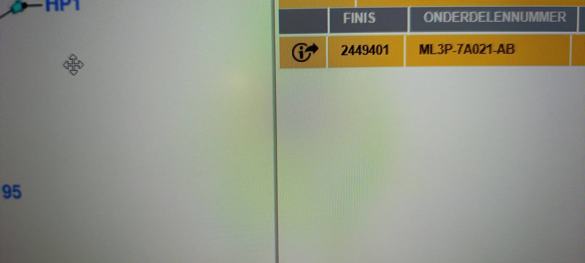

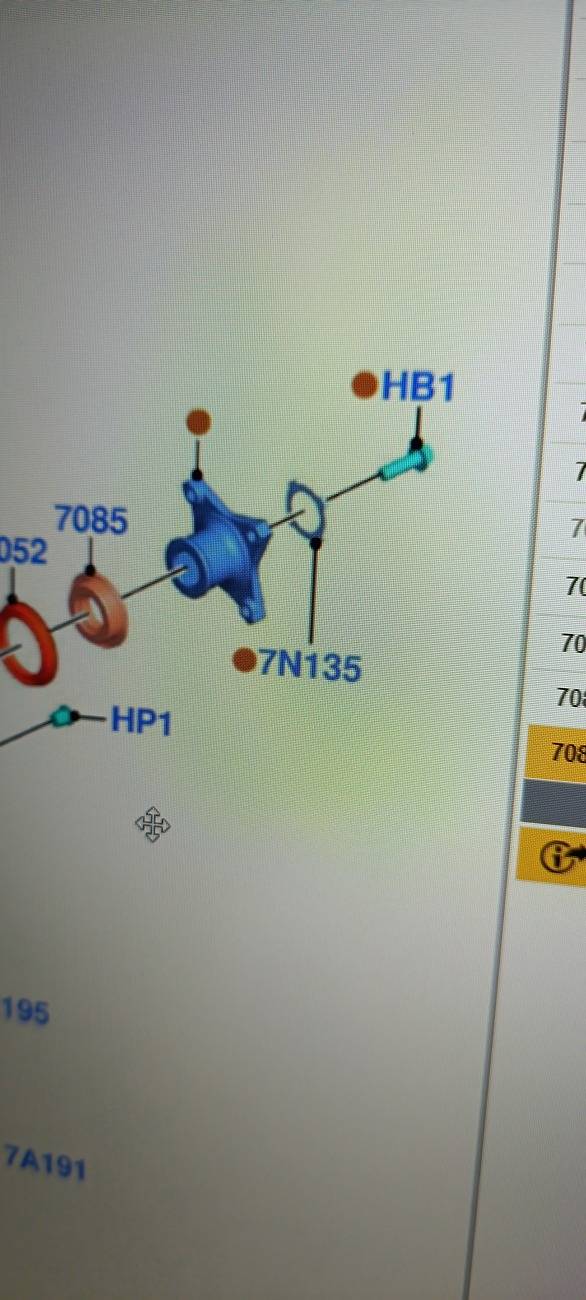

Has anyone gotten any info from the "FORD MOTOR COMPANY" member?
I think part number for A10 output shaft flange to be: JL1Z-7089-B. Still have not found a TSB that covers this.
If anybody has P/N or TSB, please post.
If you are going to wait for a official tsb from Ford good luck!

Applying grease to my transmission output shaft splines and the I.D. of the output flange splines resolved my clunking noise. The output flange is connected to the driveshaft. Mine has the stock exhaust. Only takes about 15 minutes to apply the grease if you have a lift. Good Luck

The answer is already given by other members and me with pictures and everything. What do expect more?
