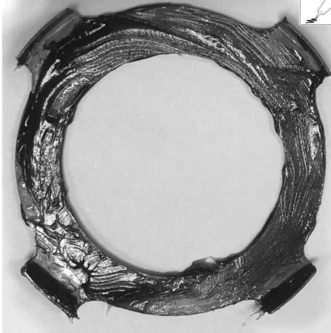

I forgot to ask you did you hear scratching comes from that side? Regards to the scratching marks on your ring?
No have not heard any scratch type sound, just the clunk, I also have a vibration in my floorboard when suspension uncompresses but im not sure if it's related. Don't think it there's any marks on inside of rim.

Hello, just to verify did they replace the output shaft? Do you plan on having them do that if not? Otherwise no issues or returning clunk just from grease only? They put grease on mine but I dont have car back yet. They did verify the clunk though so thats good.
You only need to replace the output shaft flange, which is the part connected to the shaft. Remember to ask them to put enough grease on both sides of the anti-ting ring, which is a piece of metal coming together with the flange part if the dealer is going to order it for you. Then the problem will be solved if your clunck is the same with ours.

I wonder what the anti-tinq ring does look like? Probably looks like a big slim washer maybe??
