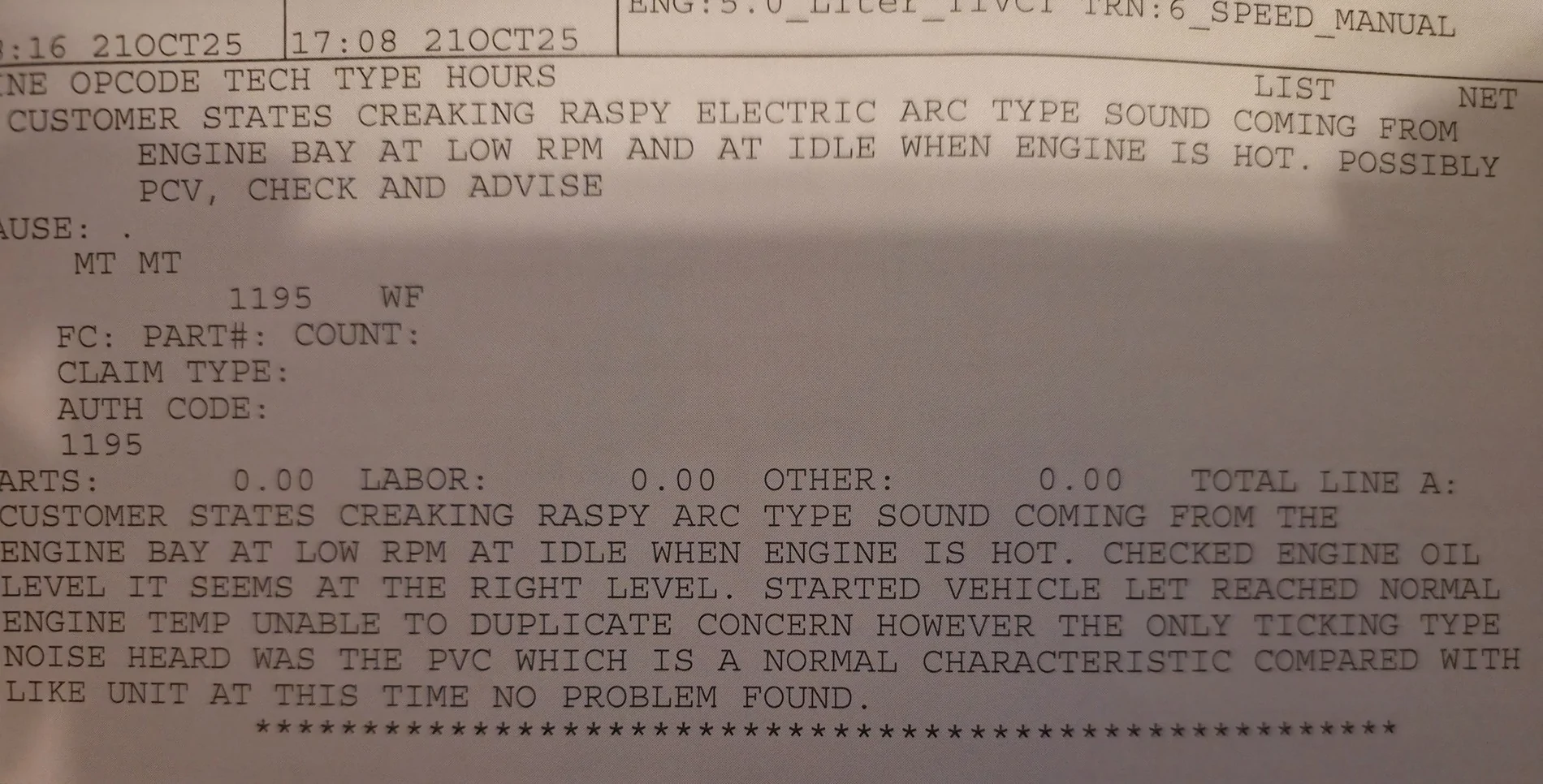

I've had my horse checked for this sound. Techs said its normal PCV sounds. Here is the write up. Engine noises aren't the issue,,I just want to know exactly what is causing it and if it's the pcv why it cant be remedied.
