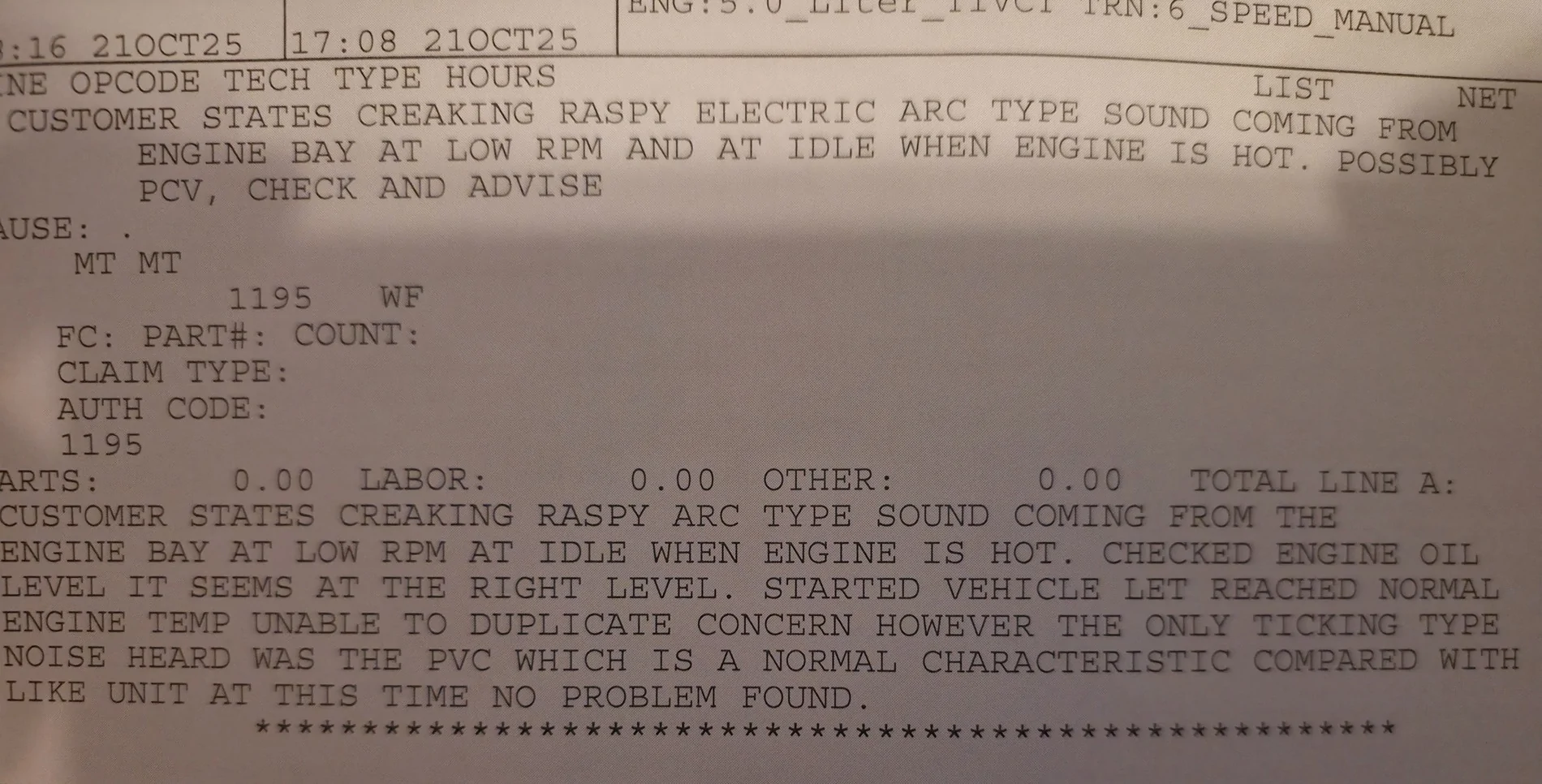

That is the PCV rattling, mine does same. Its a normal PCV sounds for this motor. Had dealer check mine its normal.
S650 Mustang new ticking sound… e239314f-6ad5-4022-8a6a-09061bf5ac24-964b33a2-d599-44d0-a20e-bc1d0af63b42~2
