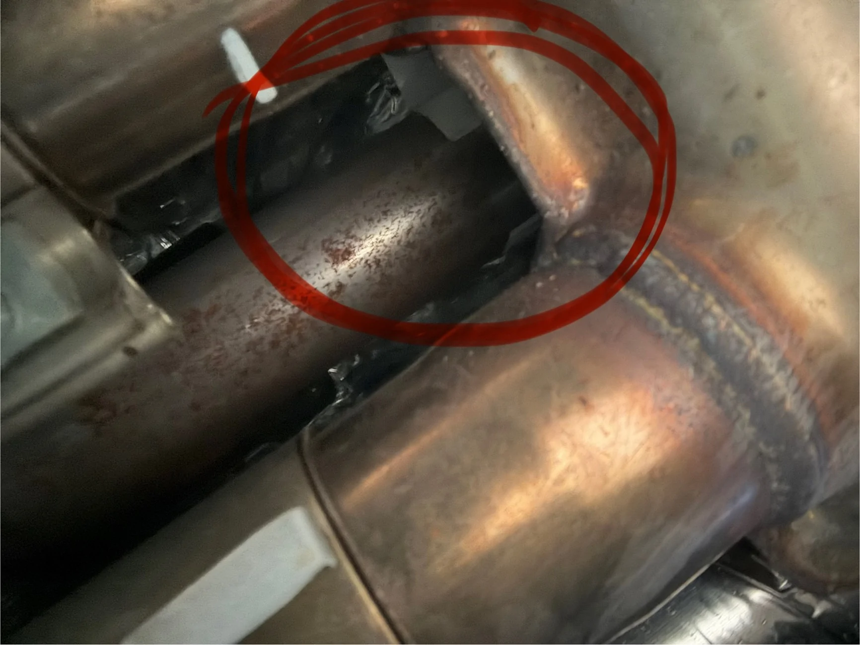

I’ve had a very tinny ticking sound coming from under my center console for about a week now. It is speed dependent, starts being audible at around 15 mph and gets faster and louder as speed goes up. Video file attached, acceleration is from stop to 45 mph
Only reason I can think of was clipping a curb in a thin section of road last week.

Did you ever figure it out? I have this same noise coming from the cup holder area of my 2025 GT. I’ve had the car for a month but I only noticed it this past week

someone put a zip tie on your driveshaft as a joke?

I didn’t, though it went away a week or so after I made the post. Prolly should’ve cleaned up the post with that info after..
Did you bump your wheels at all or this sound just appeared out of the blue?

I think it’s literally a sticker from the driveshaft peeling off. I took the sticker off and the noise went away🤣
Well hell, that might’ve been it for me too. Alright, no clocks zip ties or explosive surprises, mission accomplished lads
