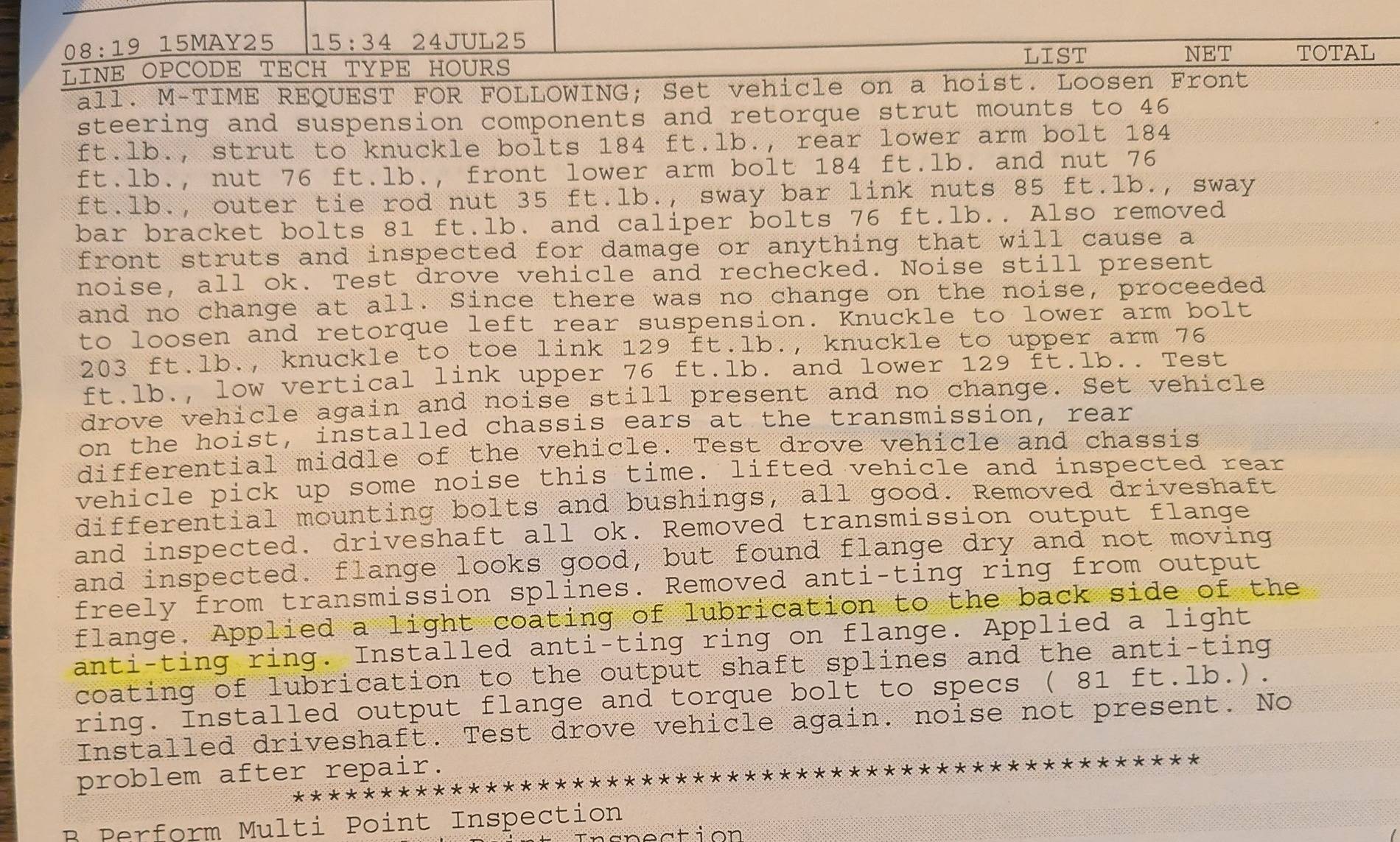

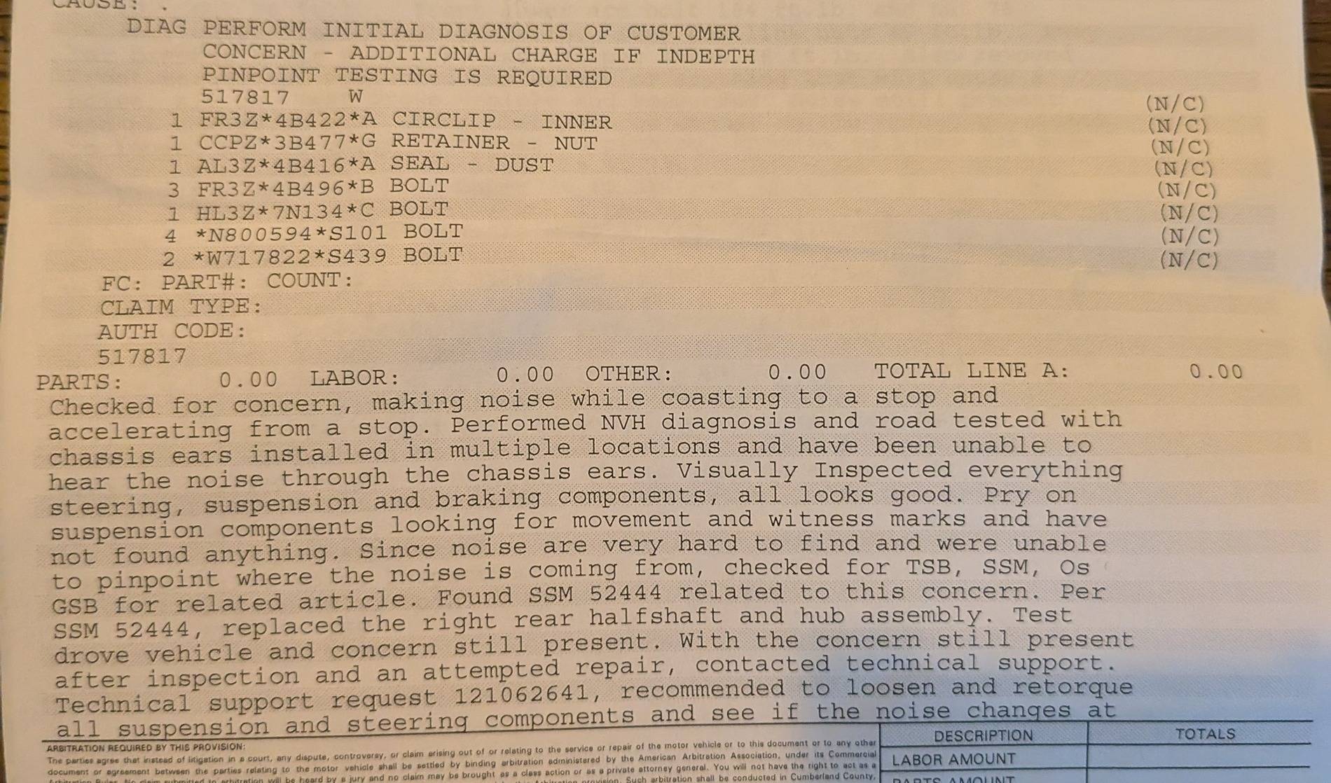

Update:
It's been 6 months since the dealer applied grease to the output flange and splines.
I currently have 6500 miles on the car and it's running great. The popping/clunking noise has not returned. ✌

As a dealership employee, that is enough to bring a tear to my eye. THAT is proper dcoumentation and how to get paid from the manufacturer.

The dealership before this actually kept my car for a week, told me I had aftermarket suspension and also said they can't figure out what's wrong with it and to top it off they said their mechanics weren't experienced enough to fix the problem. I asked them. Isn't there a procedure, they told me just to go get my car they're not willing to work on it ... I had to go to the back where the cage doors and grab my own car. . . You made me so mad. I wanted to just go back to Toyota šŸ˜‚ but I found Liberty Ford NC and they did a great job. Also, the foreman for the shop owns a dark horse! He treated it like it was his own
