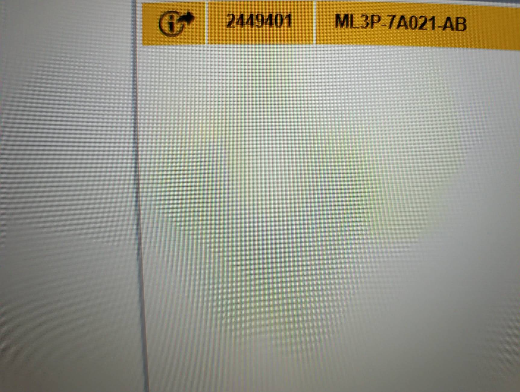

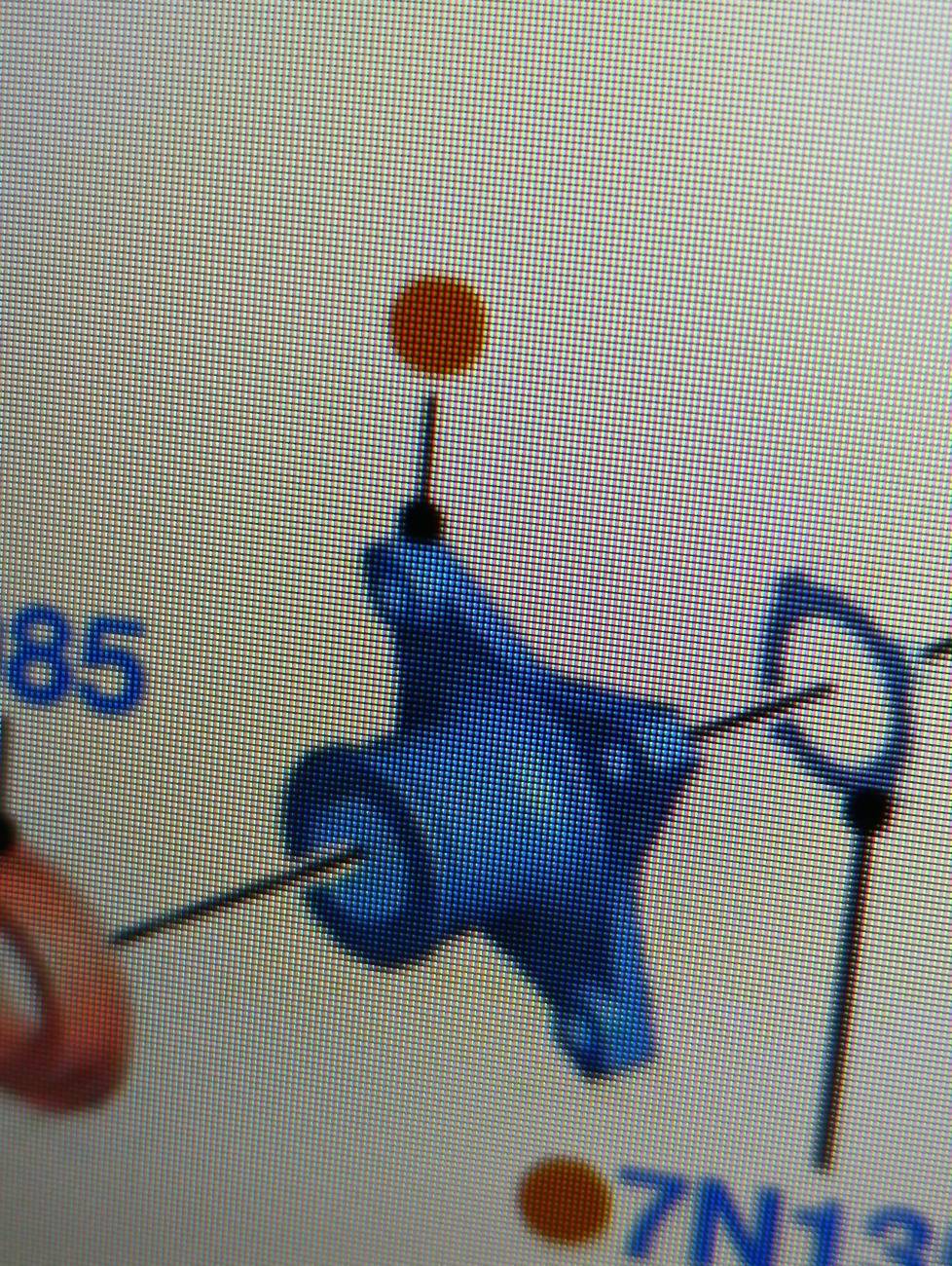

I've been trying to get info about any related TSB for output shaft or P/N to no avail. Anybody have a possible TSB or P/N? As we all know, going to a dealer unarmed can be frustrating.
Adautomotive
Jun 30, 2024
40
Belgium
Dark Horse
Thanks!
Looks like that number translates to : JL1Z-7089-B.
These are the oem numbers from my vin nr i also noticed they use all New part numbers and eventually a lot of parts are used on a model before for example the front stabilisator bars are New numbers and the are the same ass on a s550 this flange the same it's evantualy just a 10r80 gearbox. Maybe good to noticed i am based in europe so the numbers are different then in usa to 5years ago it was hell for us to find the correct parts now it's finally getting better.
