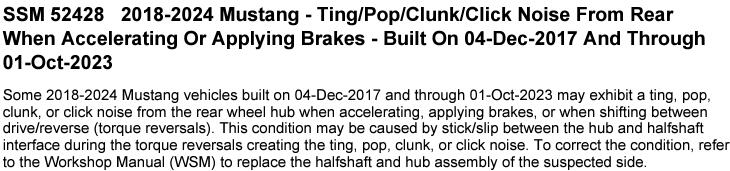

Hello everyone, Dark Horse owner from Dubai here. I have a Dark Horse that has a similar noise as the one described in this thread. A few thing I can add to the conversation are that I have a good idea on where the noise is coming from. Firstly I noticed that my noise also happens during light breaking/downshifts/Switching to R after D so this leads me to believe that it is related to the service bulletin Ford had for the previous Mustang. I will be going to my local dealer soon to talk to them about it but I am pretty sure that it's the one I think it is. Hope this helps someone in the future.

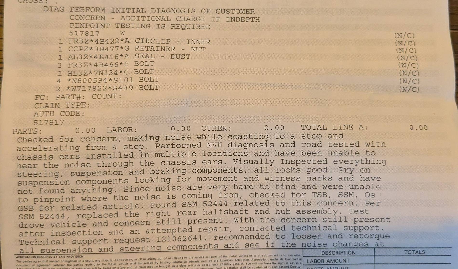

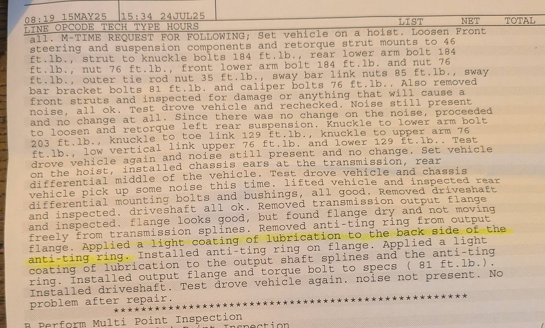

A dealership in North Carolina called Liberty Ford kept my vehicle for 3 months almost and they finally figured out what this issue is, I'll be posting the paperwork and hopefully it helps you guys. Plus actually having the same issues and it was frustrating because nobody could figure it out. It's actually really simple and it's kind of hidden and funny. But I got you guys and it's not a big deal. At least I don't think so

I hope this helps brothers I was patient and worked with them! If you live close to Liberty Ford, NC. Please bring your vehicles here. They really take care of it. The highlighted portion is what they did to fix the issue.
Real tough diag there. Maybe it took a long time but the dealer stuck with it and solved the problem. Many dealers would claim it's normal and send you on your way... Glad you got it fixed and thanks for posting the actual fix as it will help others with the same/similar issue... We all learn from other's experiences.
The Ford dealership in Lumberton North Carolina kept my vehicle for a week, didn't work on it told me I had aftermarket suspension and they can't fix it, I said aren't you supposed to go through a procedure? They said take your vehicle and leave we don't want to fix it then we're not going to fix it. They pretty much told me to leave before they call the cops 😂 I even have to go to the back where they keep your vehicles in the locked area and grab it myself... I'm telling you bro. You're right, it's hard to find dealerships like this. I remember when I visited Liberty Ford and I went to the back and I saw the vehicle pretty much in pieces, the mechanic looked at me and said I'm going to find this issue... And he did. I didn't pay a single cent and a vehicle was covered by Ford. If you guys are close I recommend this dealership. Again, I hope this helps. I almost sold my vehicle because I thought it was really really messed up.
I also have the same problem and found this on another thread . Mine is booked in for its first service so I'm hoping these examples make it easier to solve. Thanks for sharing your inspection report as I'm sure I would have been told its normal or possibly changed a heap of different parts and not solved the problem

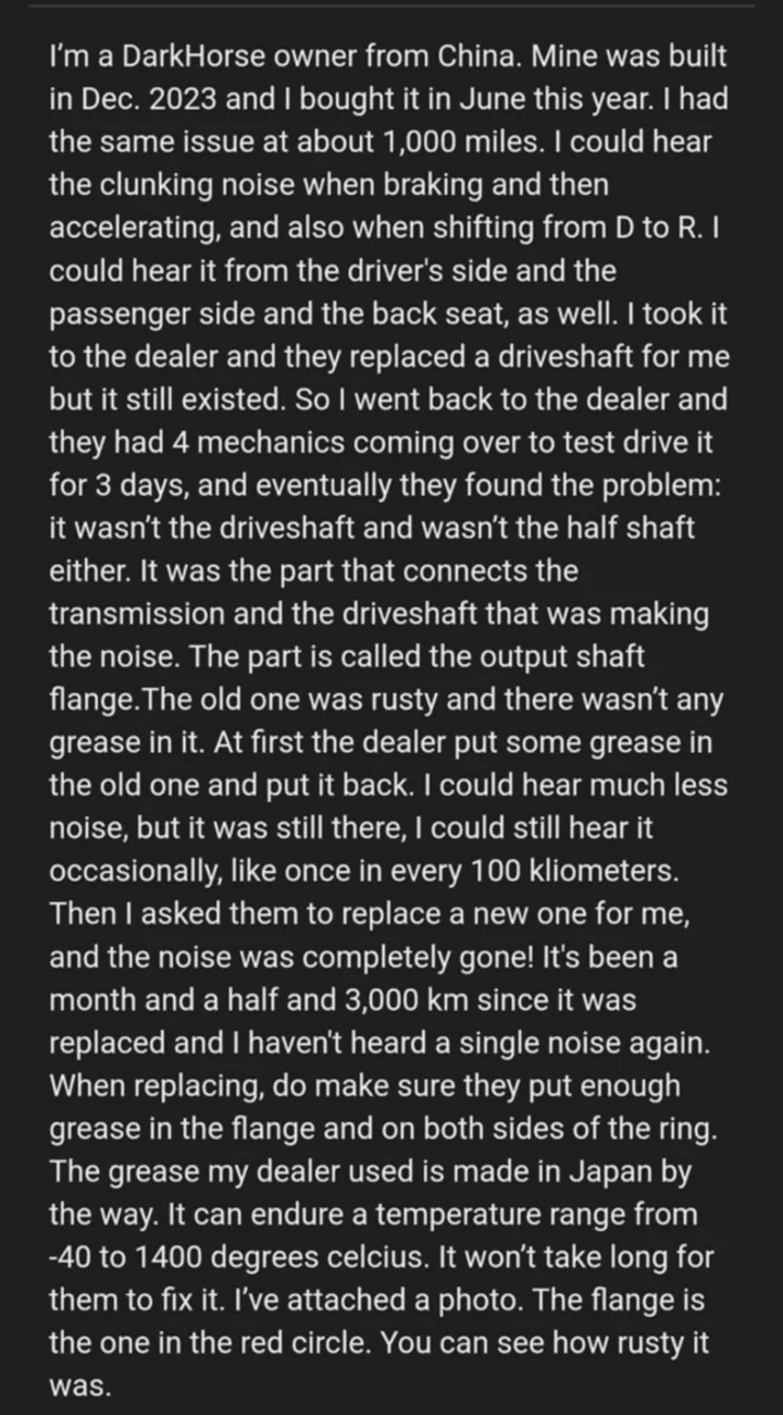

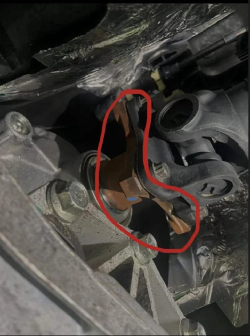

This is how my car was fixed. I also found this file online which is a Ford Technical Service Bulletin from 5 years ago. Seems Ford has long been having the same issue with the 10R80 transmission. Wondering why this issue happens and after all the years the problem still exists and Ford can't fix it before the cars get out of the factory.
