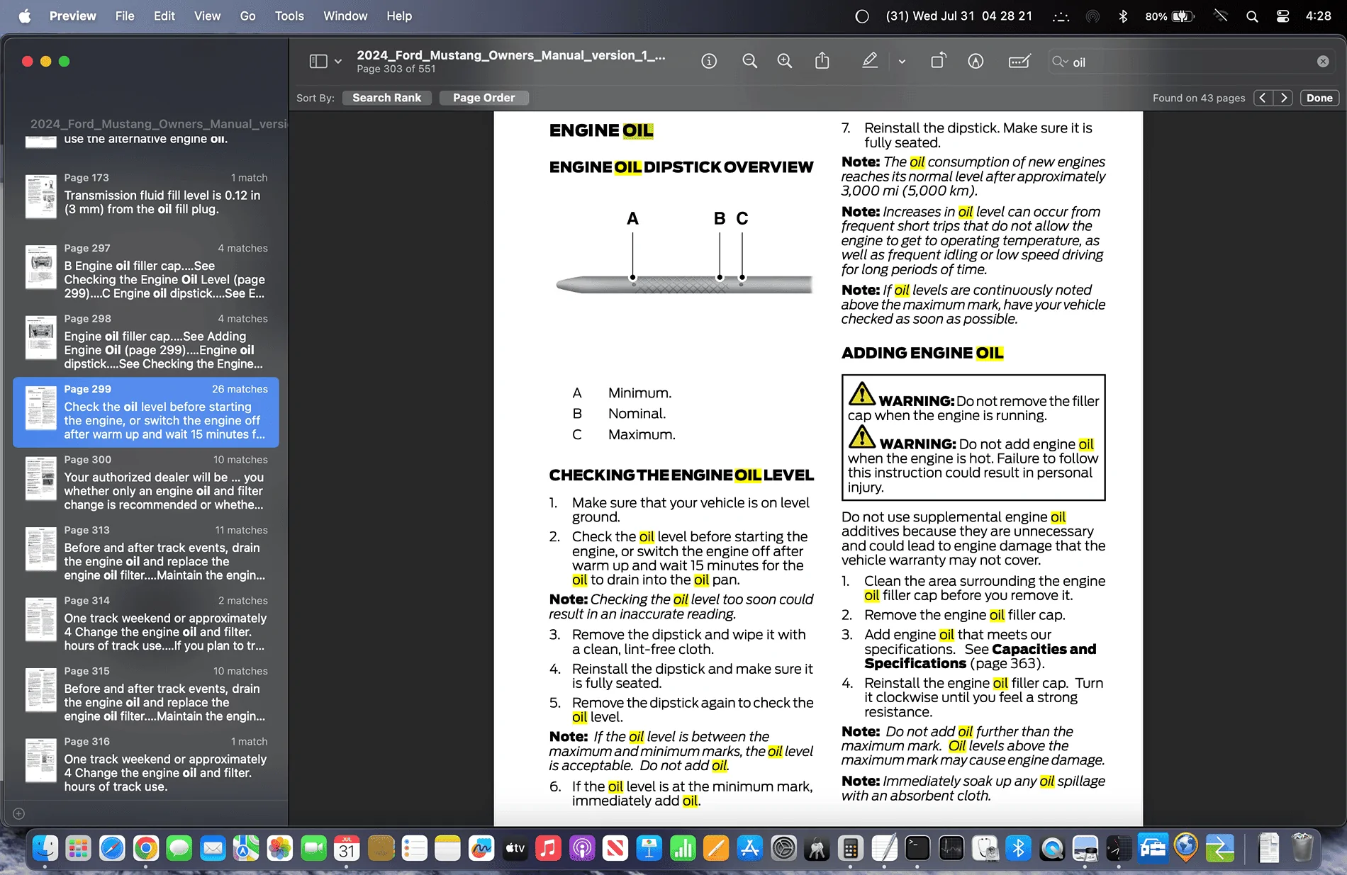

I thought motor was supposed to be warm when checking oil ?
I prefer checking when hot, as that is the condition by which the engine operates.
The manual does state engine oil can be checked hot or cold.
Almost felt like i was playing name that tune - i can name that desktop in 4 icons. 😁
