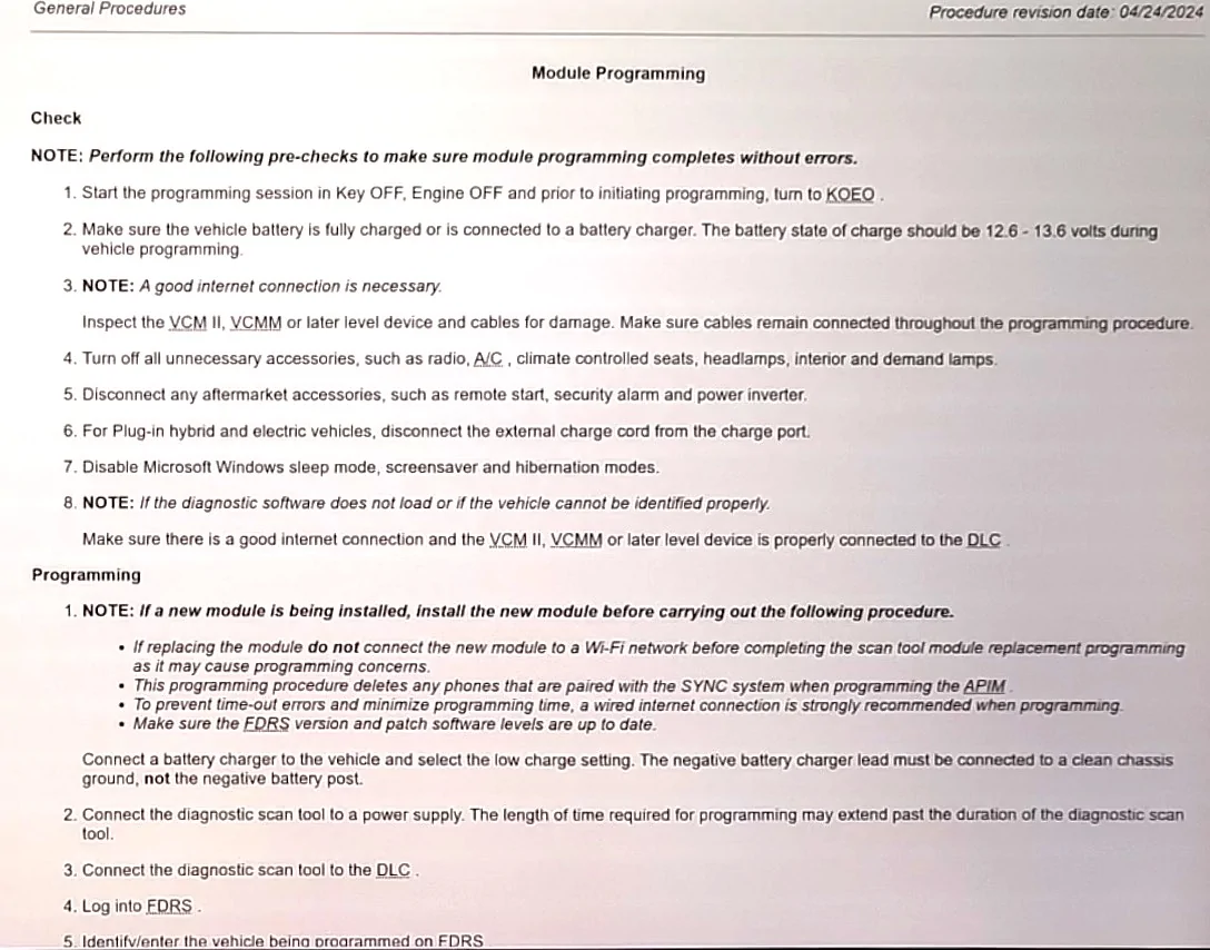

If you are doing any kind of key on, engine off reflash, you need to hook a battery charger up so that there is no voltage drop. That will abort a program real quick.
