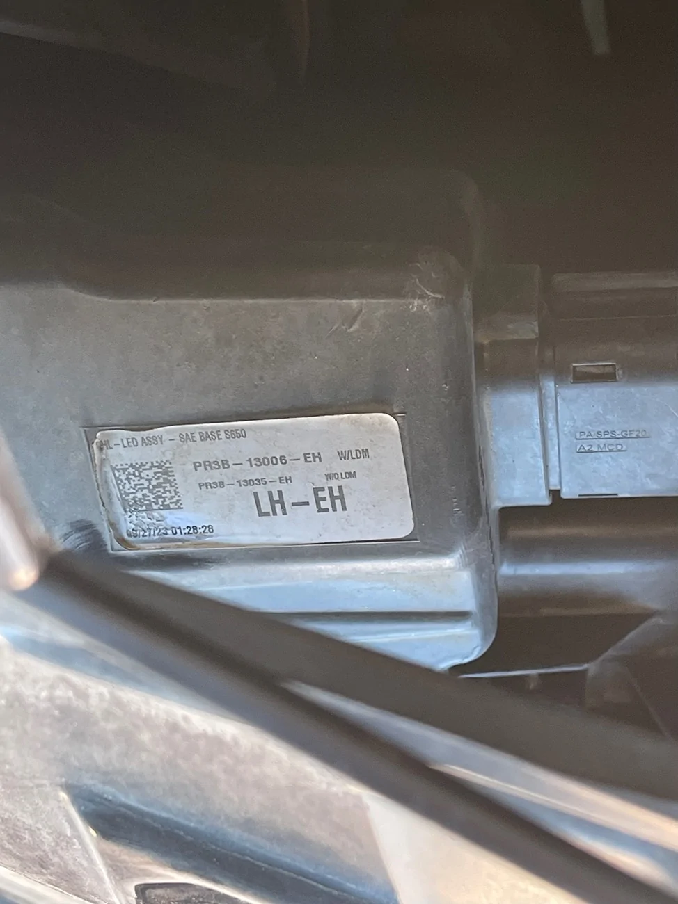

I bought a second hand 2024 Mustang Dark Horse, the car was previously involved in an accident. During the repair, the driver-side (left) headlight was replaced (by the previous owner) with a standard Mustang GT headlight (part number PR3B-13035-EH).
Since this replacement:
• The welcome animation did not work correctly
• The left DRL and left turn signal do not work
Later, I took the car to a workshop to try programming the headlights to fix the issue. After programming:
• The welcome animation stopped completely
• Before programming, only the left headlight was showing a partial/strange animation, while the right headlight animation never worked, which was unusual

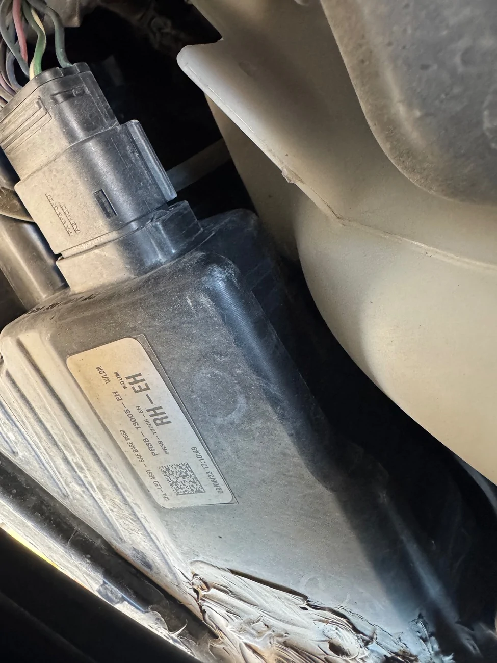

The passenger-side (right) headlight otherwise works perfectly (DRL, and turn signal). Its part number is PR3B-13008-EH, but I am not sure whether this is the original OEM Dark Horse headlight or just a compatible Mustang headlight.

1. Is the right headlight (PR3B-13008-EH) the correct OEM headlight for a 2024 Mustang Dark Horse?
2. Do I need to replace the left headlight with the same headlight type/part series as the right side for all functions—especially the welcome animation—to work correctly?
