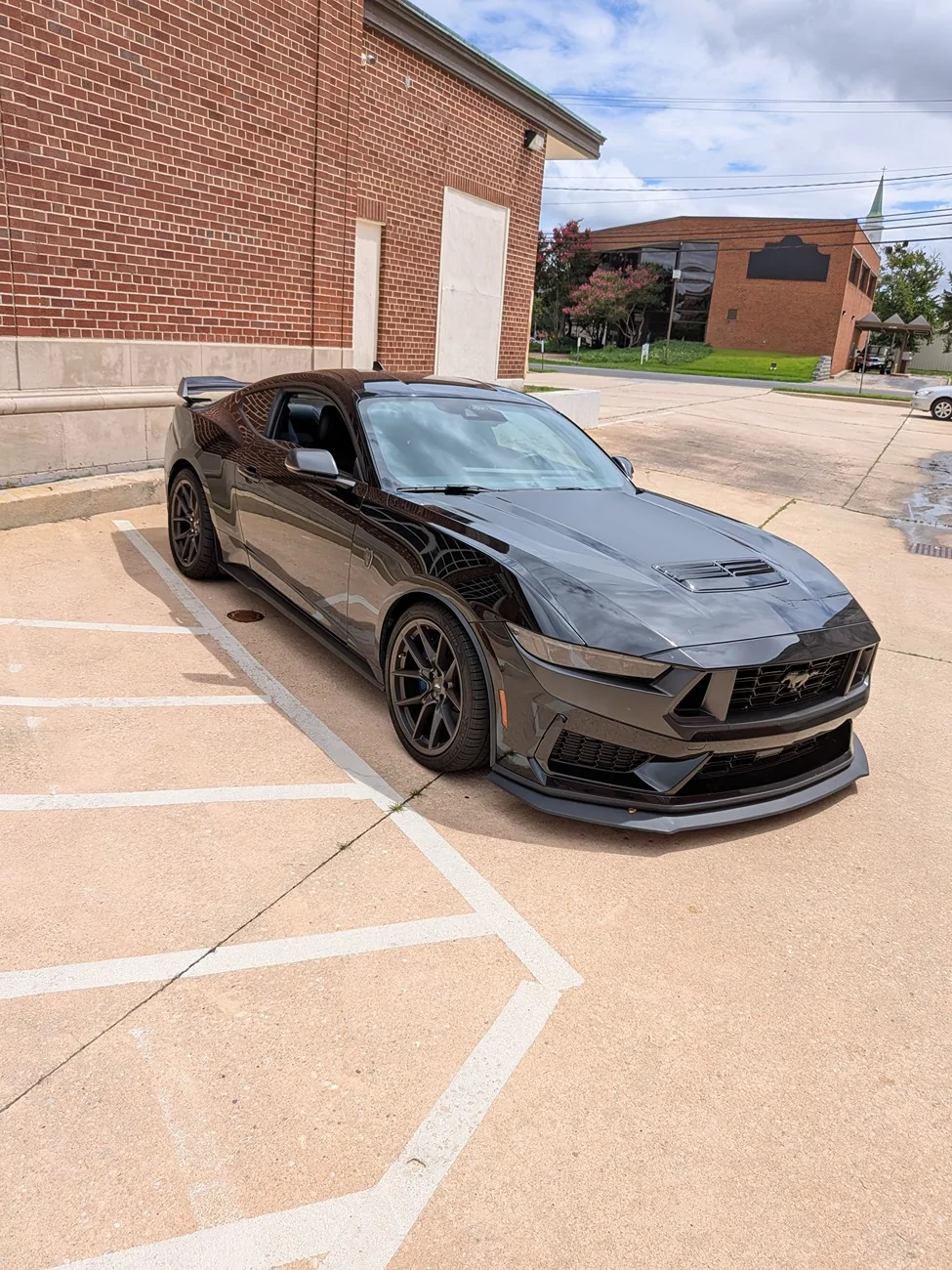

Nice seeing everyone working on fixing ! Glad it helps! I love this car so didn't want to get rid of it
S650 Mustang Dark Horse Driveline Clunk PXL_20250811_161009961
