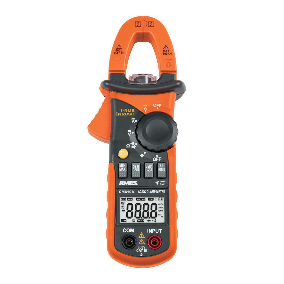

What I was getting at was measuring the parasitic current flowing from the battery AFTER normal shutdown. I have an inductive current meter and will do the measurement once I get my car. in about 4-6 weeks.

No, it’s a lot simpler. You just hook the loop around EITHER the positive or negative main lead coming from the battery! The meter works on induction.

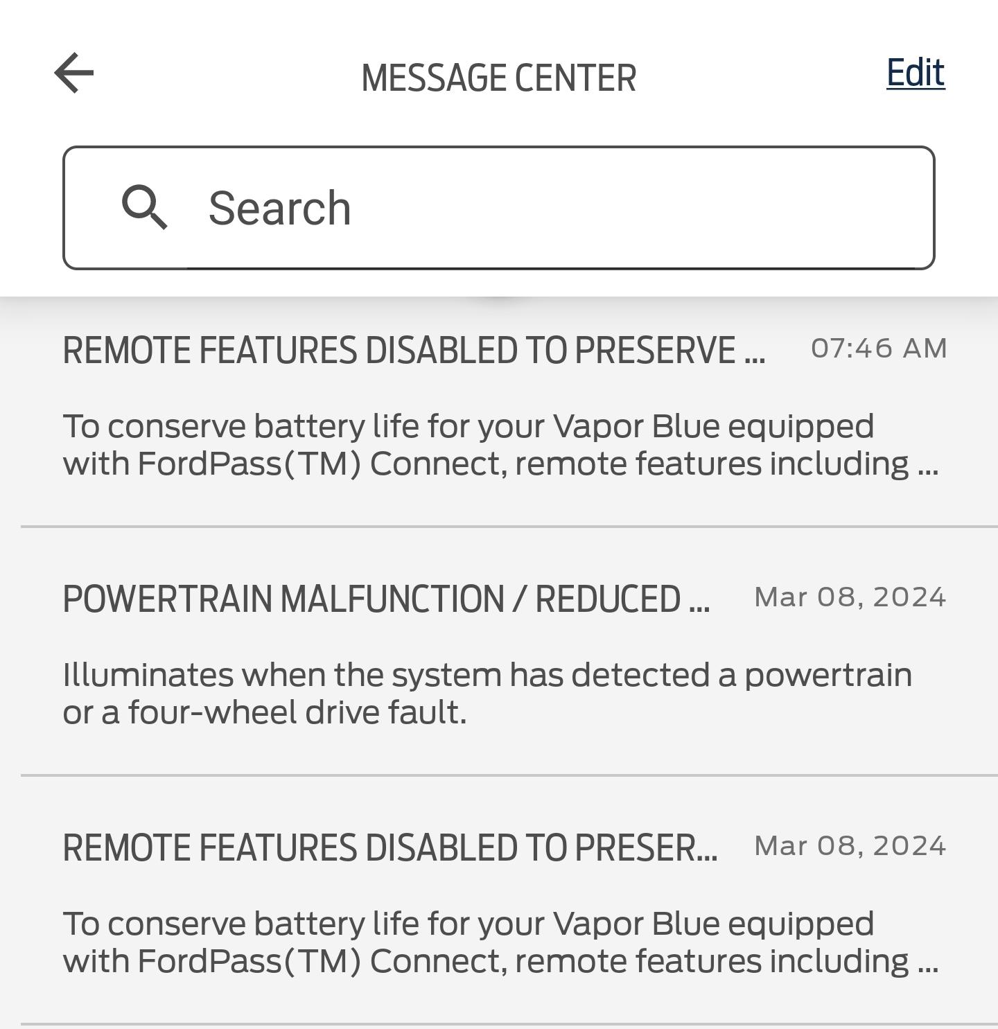

Car is still acting funny this morning I noticed the shift indicator was reset back to 4000 rpm and I got another remote features disabled messages on the fors pass app. Keep in mind this is after driving nearly 250 miles this weekend
I’d swap out the battery or put it on a one week time-out (locked and undisturbed - not even fob nor app check - and trickle charge) and then if still acting up to the dealer. Downstream codes can be set from an upstream issue - remove that potential before addressing downstream anomalies.
sometimes batteries will take but not hold a charge - so even a good trickle doesn’t always resolve.

when the vehicle is operating normally, the "Powertrain Malfunction"/Wrench Light is one of the worst lights that can come on (besides "Low Oil Pressure" and both of those are minor compared to the dreaded "Stop Safely Now" message), because it means there is an engine, transmission, transfer case, or differential issue. on new vehicles, there are so many electronics and modules that a weak or low voltage battery can set a myriad of codes for low voltage, loss of communication, and more, and sometimes those codes can set a light like that
