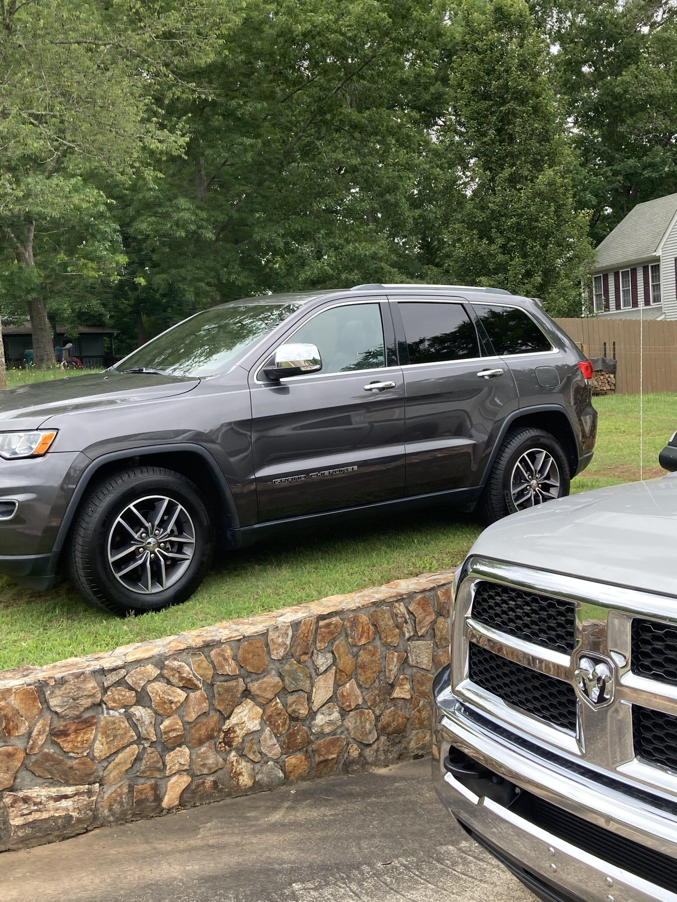

I really like this. It rides smooth and very comfortable. This one is loaded and has a moon roof. She should test drive one. Also a jeep wrangler, had one of those too. You can get the 4 door And they actually have quite a bit of room in the back, and you can also put the backseat down so you can use it for everything including mudding.
