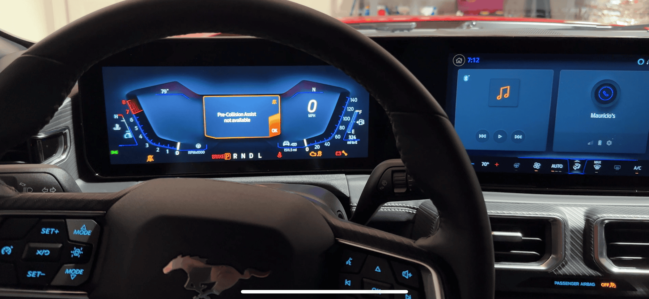

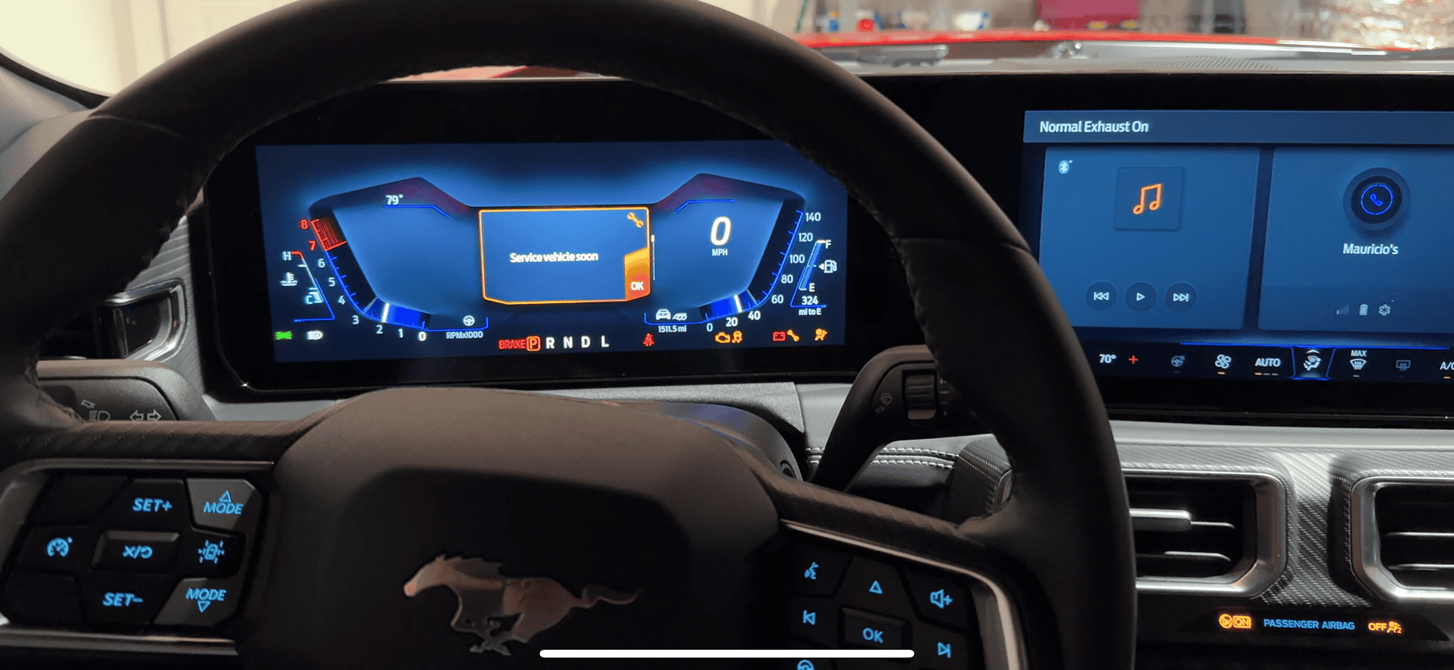

So this happened this morning when trying to head to the office. I couldn’t get the engine to turn on. Didn’t even try to move it.
Called the dealership and they are sending their mobile techs to check it. Will share more after they look at it.

Same thing happened to my GT a couple of months ago. I was about to leave for church with the family when it happened. Took the wife's car instead. After Church, we went to lunch. When we came back home a couple of hours later, I tried to start my car. It started right up with no issues. It hasn't happened since. Just wait a little bit. It will fix itself.

Follow up:
Dealership’s mobile technician came and connected the computer to diagnose it. Voltage on the battery was low and all the codes during the scan were related to low voltage. It seems like these cars need to have perfect voltage from the battery or they get messed up.
Since I am only at 1,500 miles and 4 months, I will get a new battery from them.

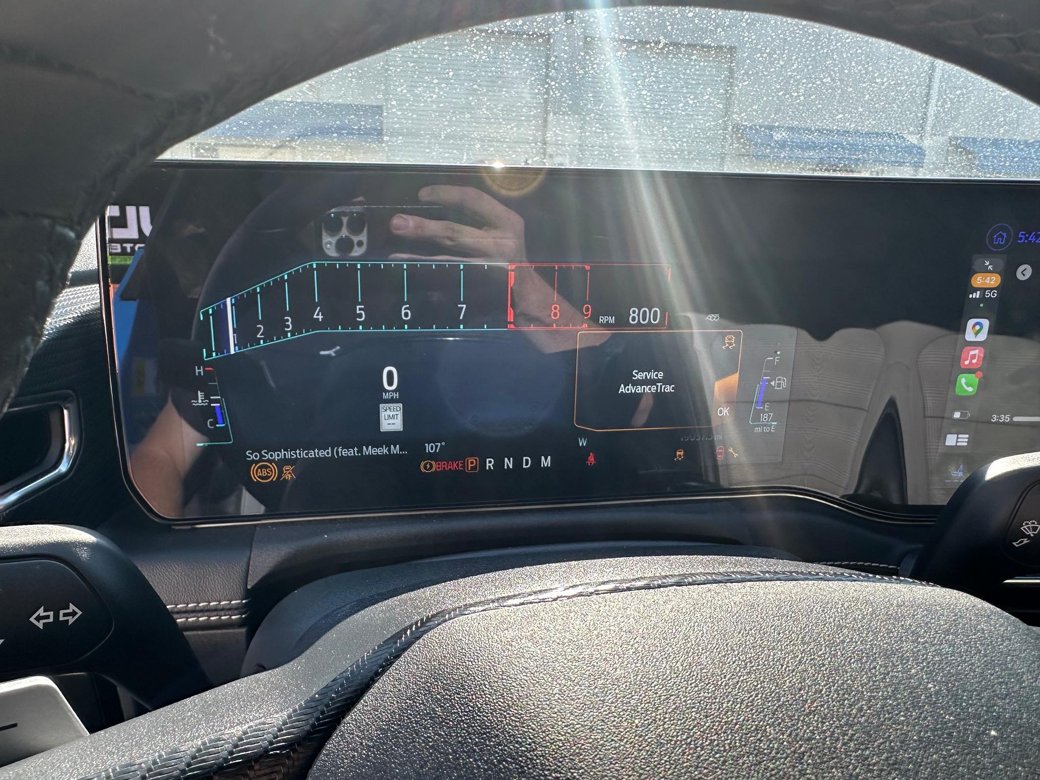

Mine done this 3 times now, just unhooking battery and letting sit for 5 mins then reconnecting, only does it randomly when remote starting
