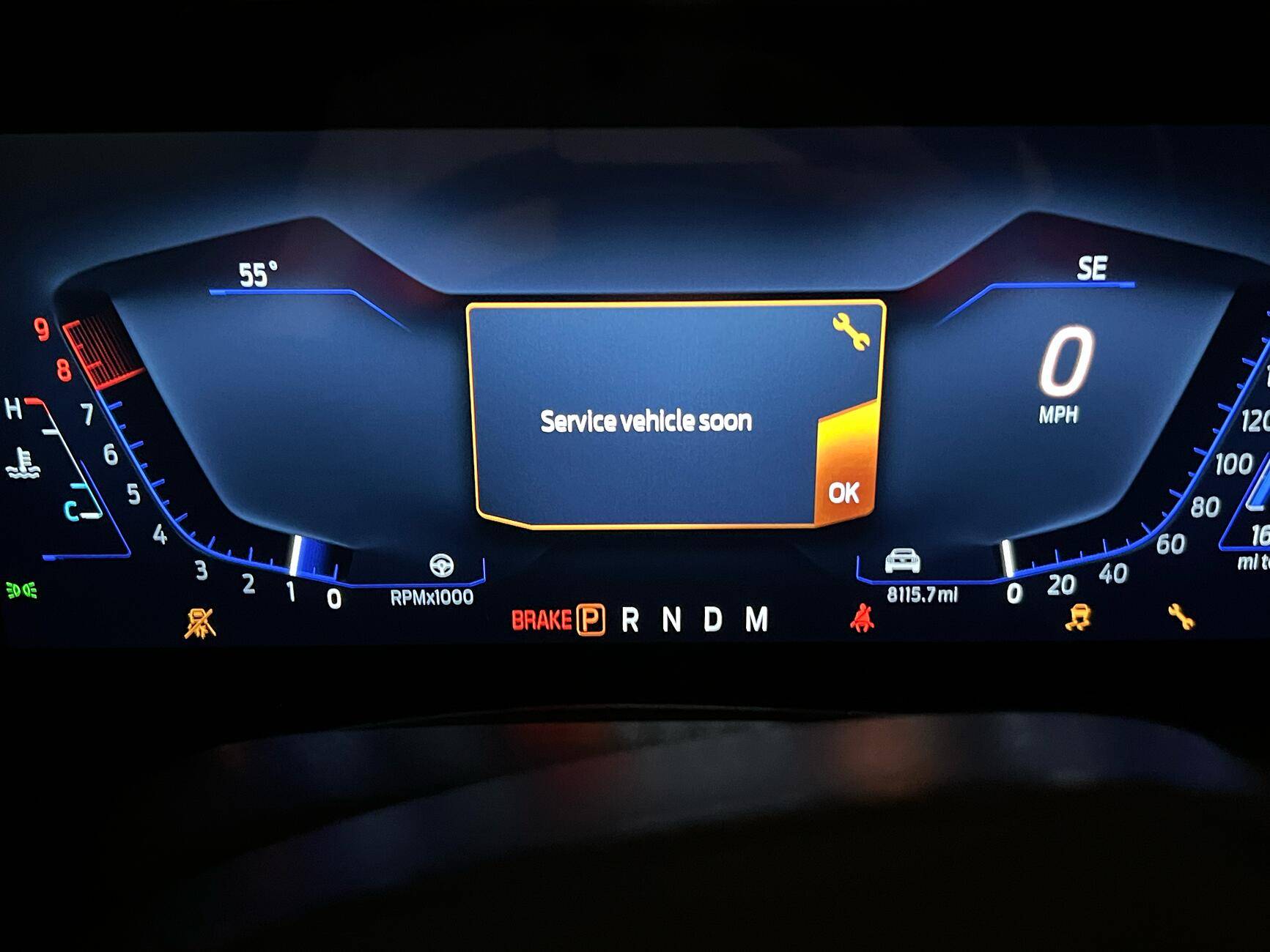

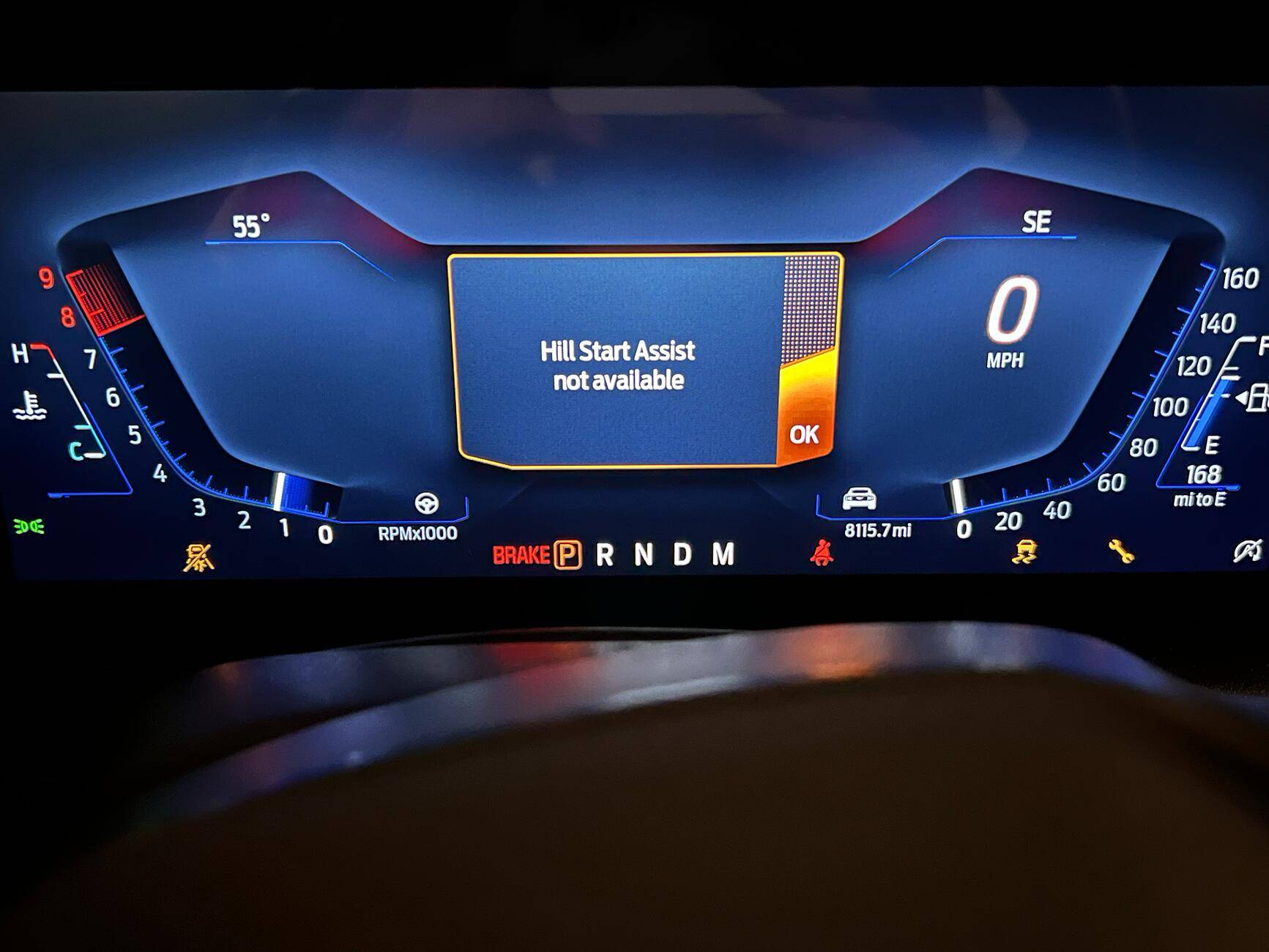

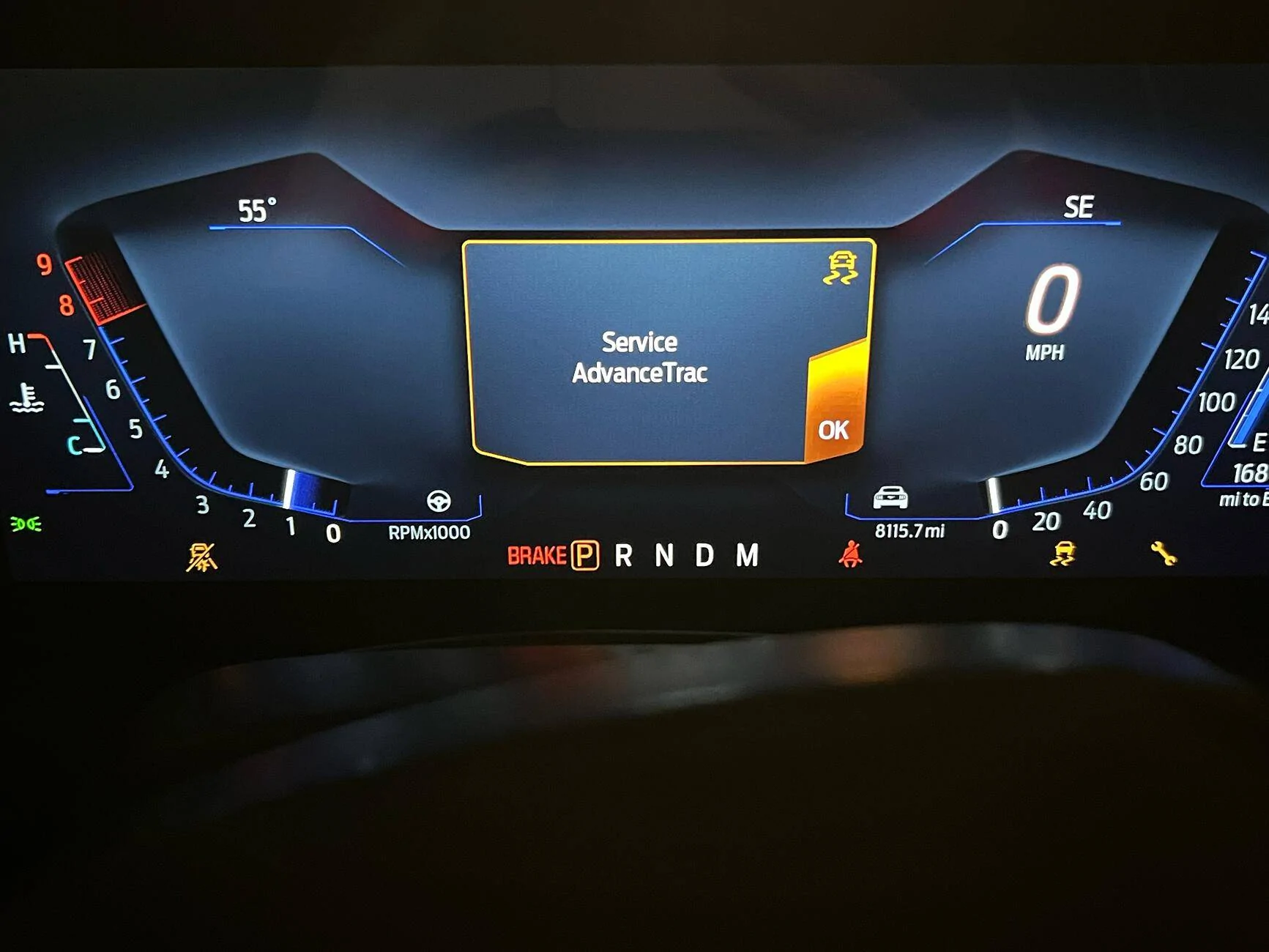

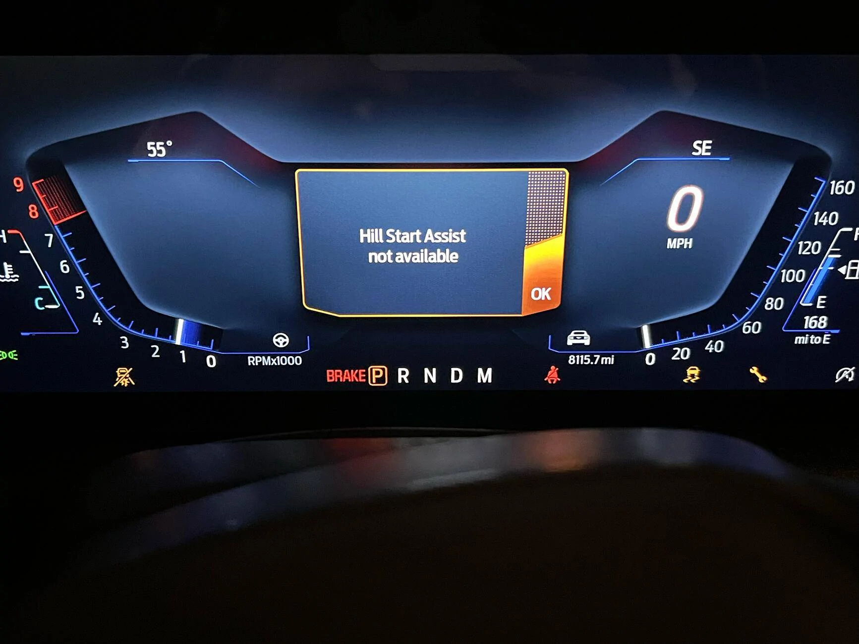

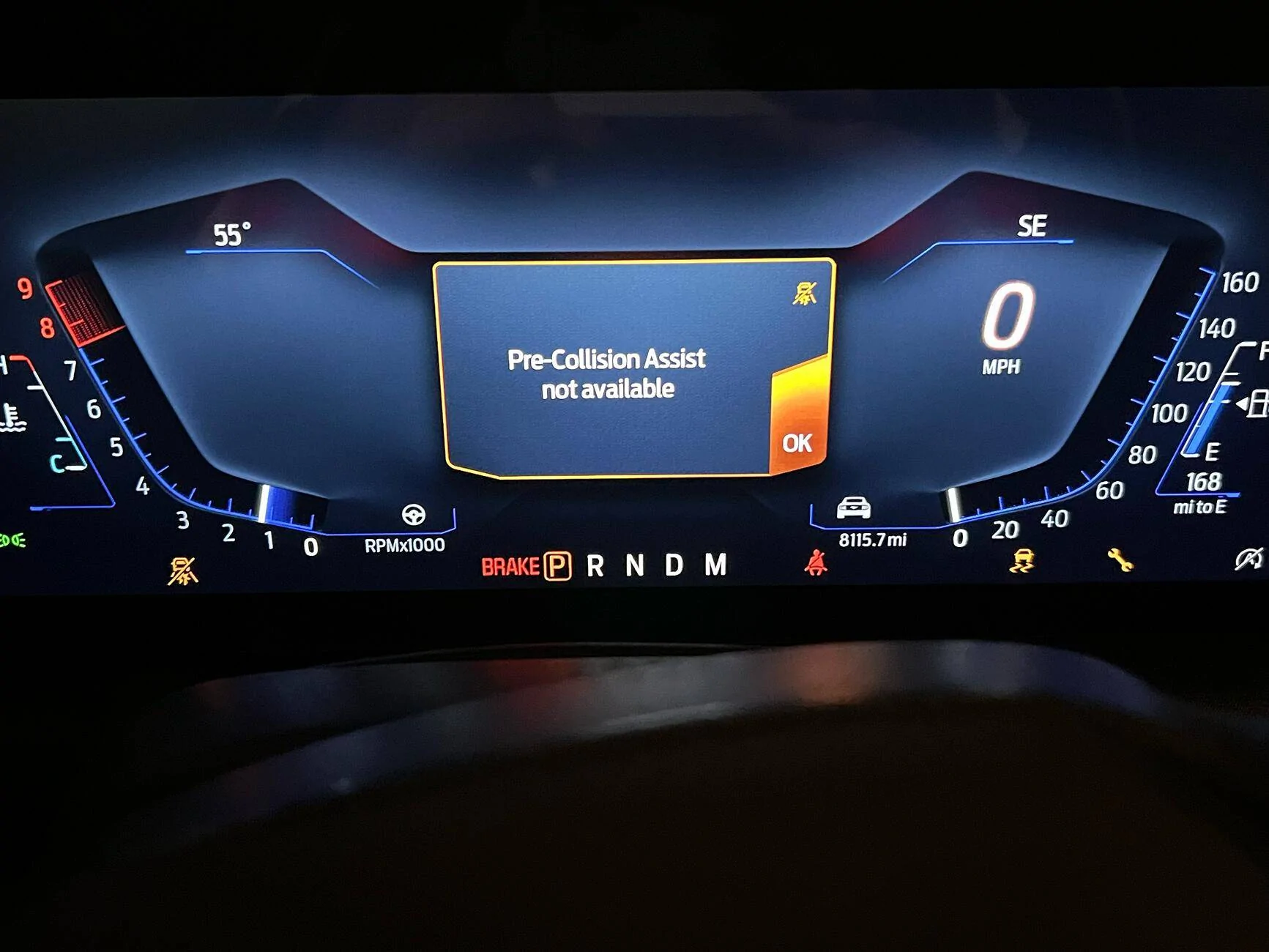

Happened to me this morning. Throwing all kinds off errors and service messages....car won't start, and even if I start it via the remote app as soon I go to D it shuts off. What is happening ?
Should I tow it to the dealer or is there a remedy to fix that ?

Disconnect the battery at the negative terminal, let it sit til the capacitors drain any residual voltage, hook back up and the car should have reset.
Take all your pictures and go to the dealer and tell them you need the TSB I have referenced above done,
I'm not letting anyone put my car on a ramp truck if I can avoid it, it is too low in the front.
I waited for 15 min and then remote started it with the key . I will take it tomorrow to the dealer and show it to them...
