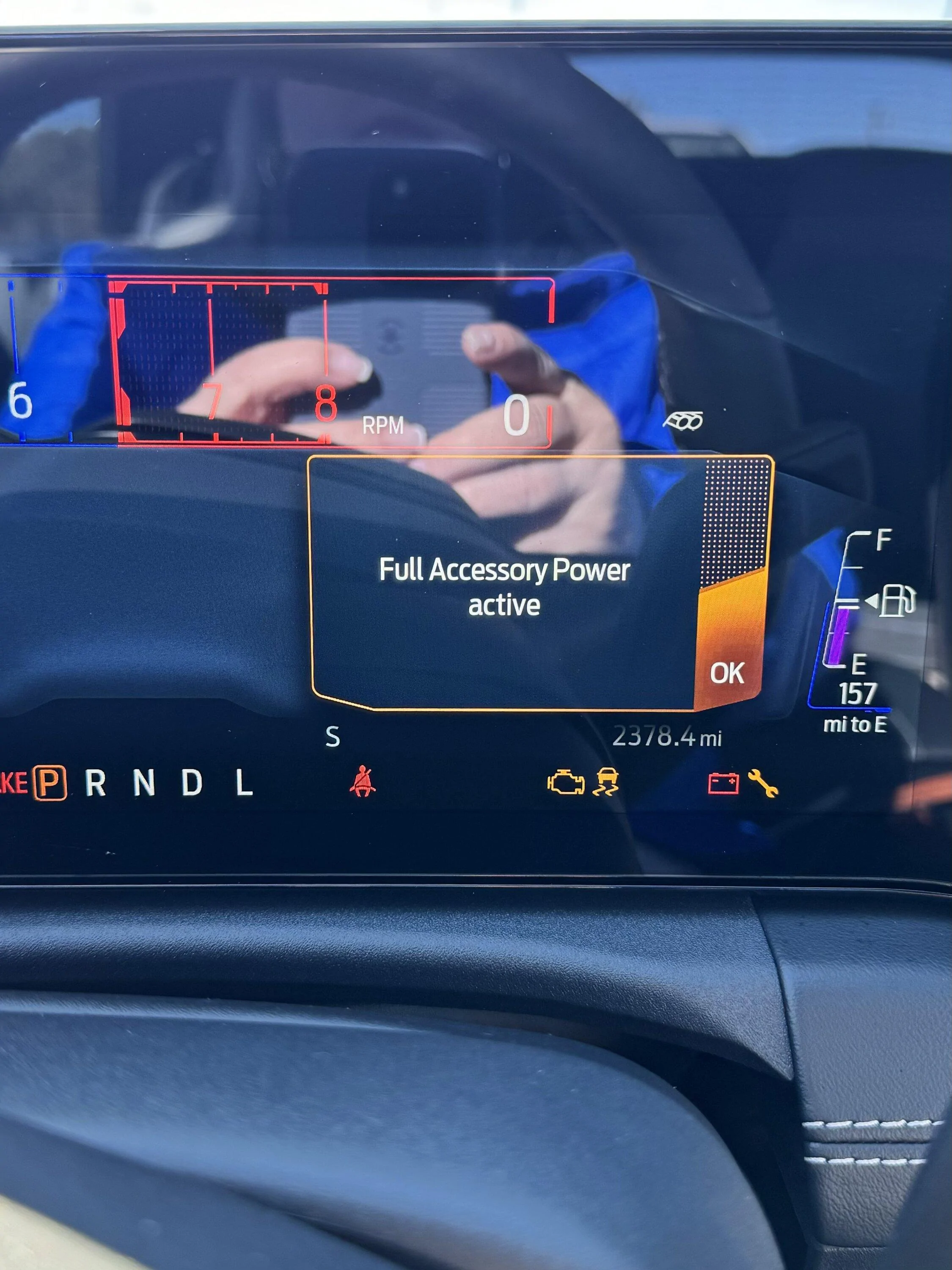

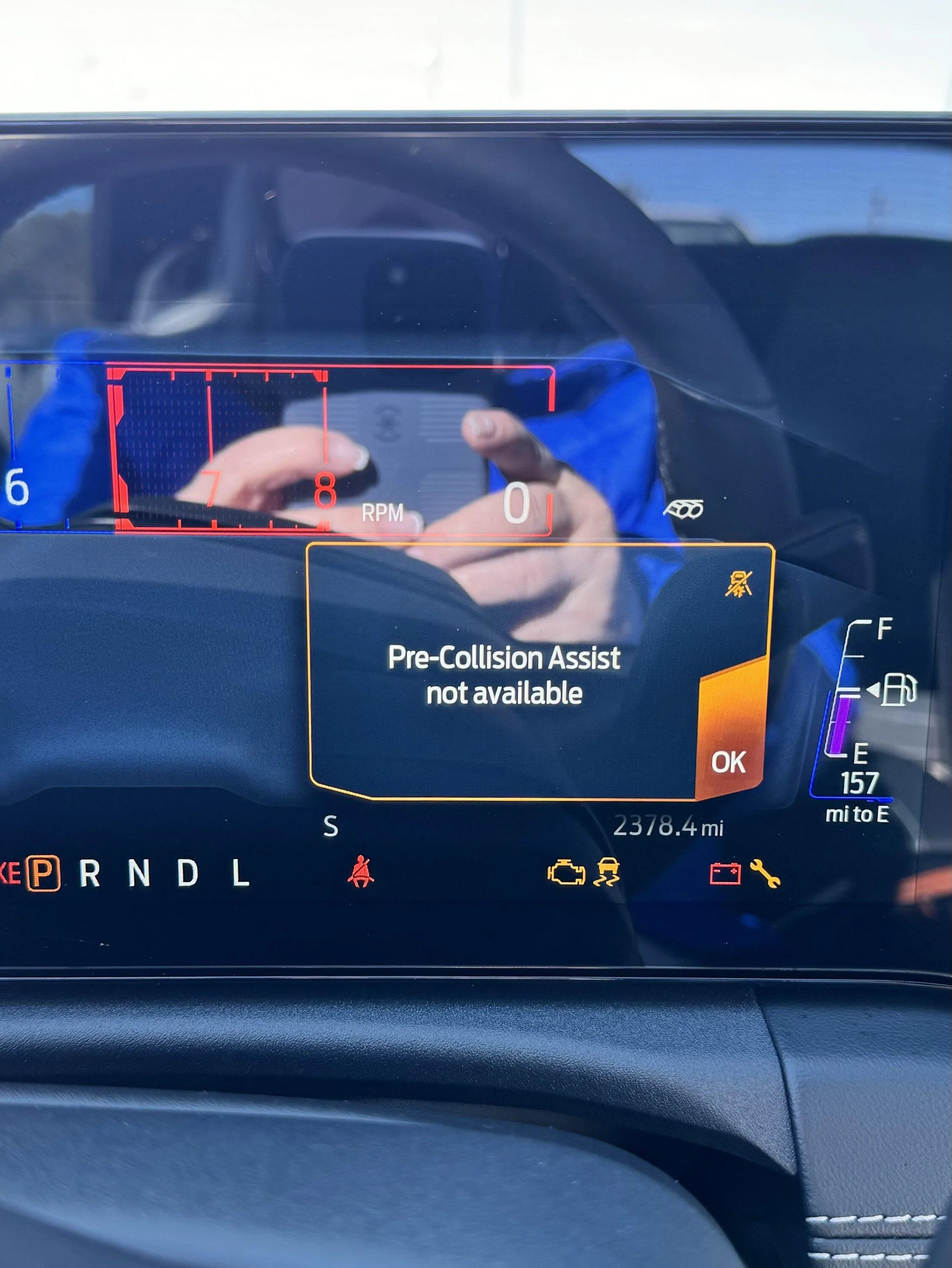

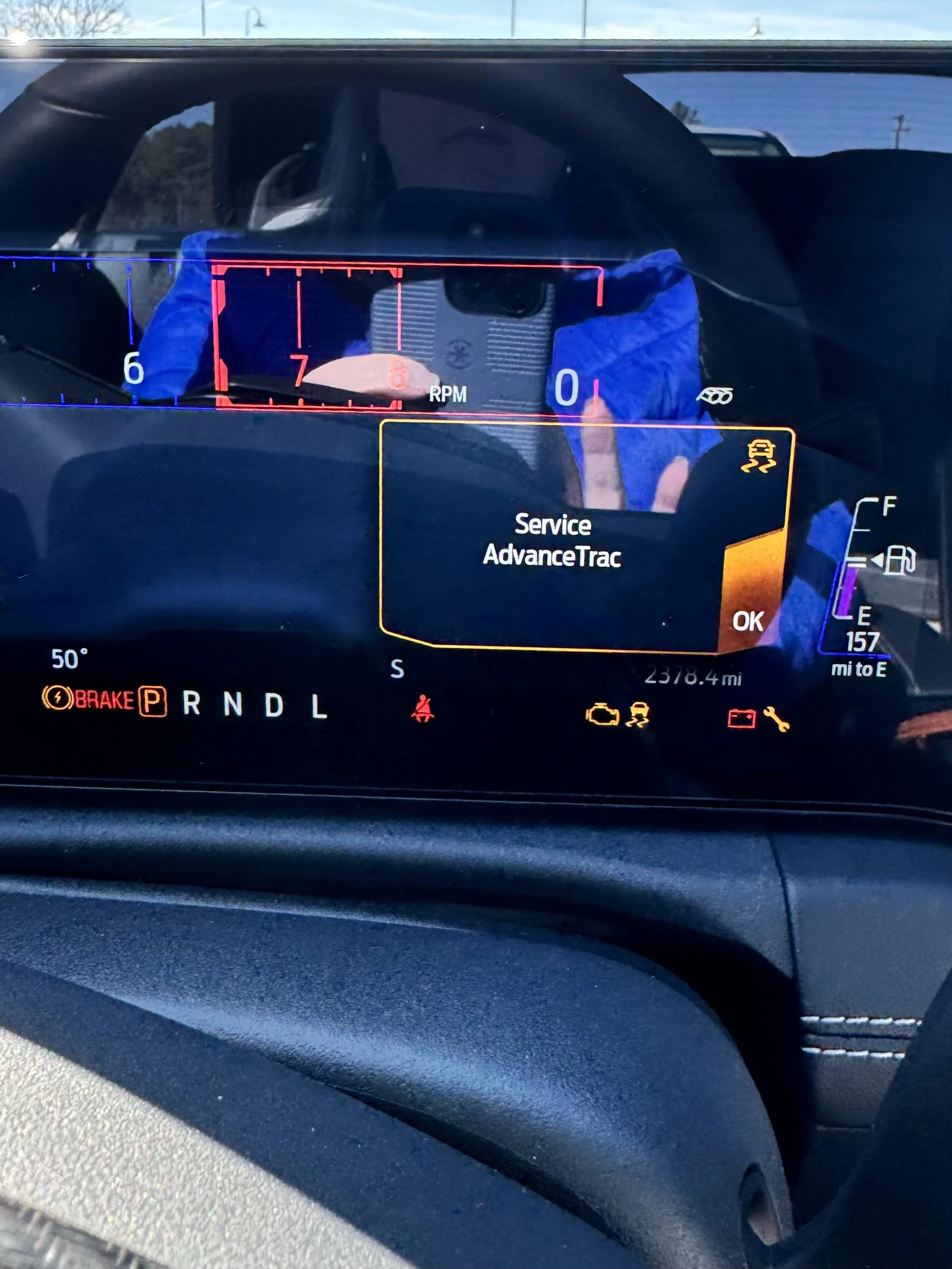

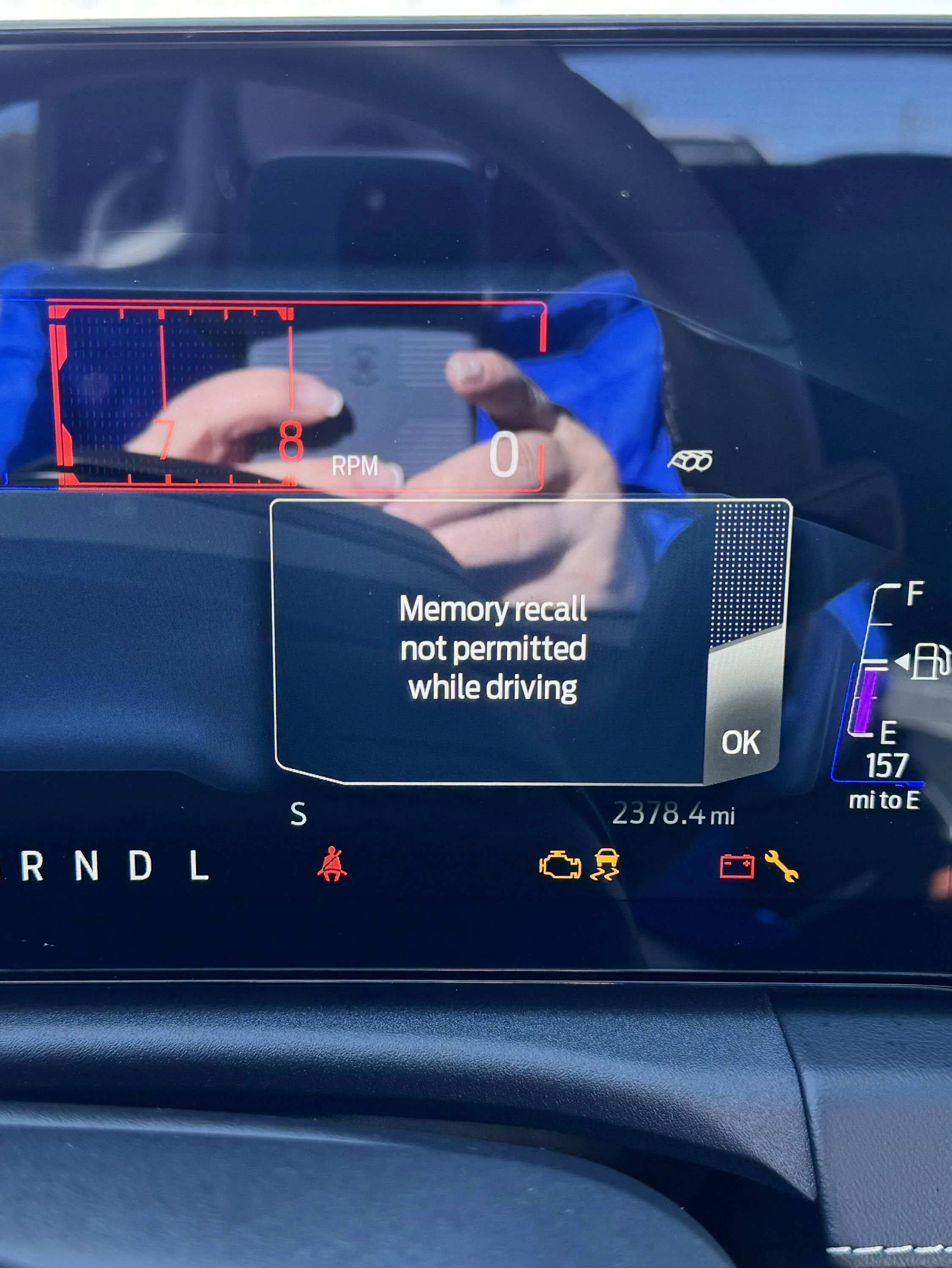

I know there had been another thread but it lacked any significant updates.
My vehicle failed to start a couple days ago after being driven for about 10 miles. It started fine that morning. Went into the grocery store for 15 min and the no start upon leaving. The below messages presented on the dash.
Ive read a couple threads where Gateway Modules were replaced and maybe one battery when this occurred. Has anyone else experienced this? After just sitting for about 20 min the car started. Put it on a slow charge and the tender light is green after many hours. Will give this a shot but if it happens again it will be going to the dealer. Car has 2500 miles
Maybe this is related?
https://www.mustang7g.com/forums/threads/tsbs-ssms-and-recalls-for-the-24-mustang.157809/
11. 12/19/23 - 52142 - "Intermittent No Crank/No Start Condition With Various Lost Communication DTCs Stored In Various Modules And Multiple Illuminated Warning Indicators Displayed In The IPC"
Some 2024 Mustang vehicles may exhibit an intermittent no crank/no start condition with various loss of communication diagnostic trouble codes (DTCs) stored in various modules and multiple illuminated warning indicators such as: anti-lock brake system (ABS) warning indicator, parking brake (red) indicator, brake warning indicator, parking brake (yellow) warning indicator and/or parking brake (red) indicator and/or stability-traction control indicator displayed in the instrumental panel cluster (IPC). To correct the condition, reprogram the ABS module using the latest software level of the Ford Diagnosis and Repair System (FDRS) diagnostic scan tool. For claiming, use the causal part number 2005 and applicable labor operations in Section 10 of the Service Labor Time Standards (SLTS) Manual.
