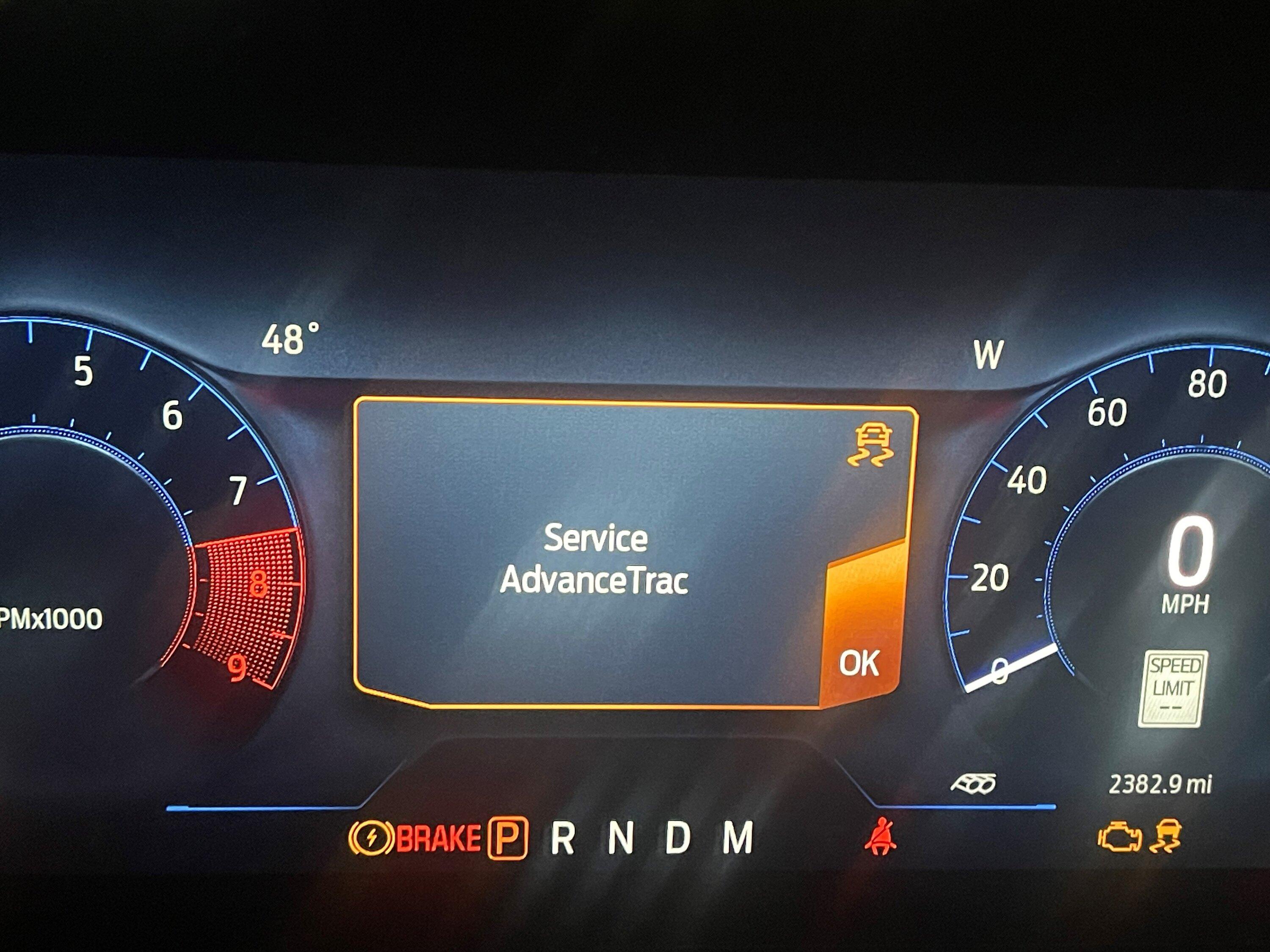

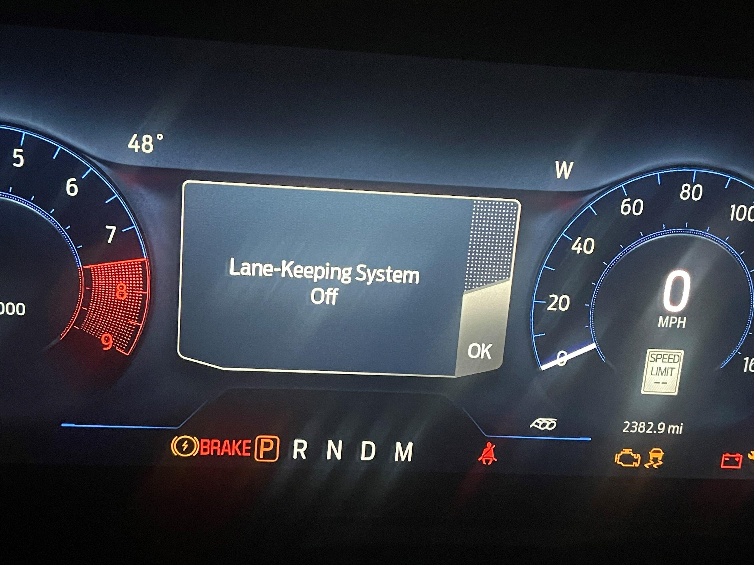

I'm relatively new to this forum, but had replied to a post about an incident regarding my car slightly jerking forward upon starting it. This occurred only once while I was manually starting the vehicle (not remote starting as the original poster was experiencing.) I took the car to the dealership and they checked it out for 2 days and found nothing wrong. I was told to continue driving and take detailed notes around any issues I encounter as they were unable to replicate the issue.
Evidently Ford social media employees monitor this sight and are asking me to bring the vehicle back into the dealership. I just got the car back a week ago.
Well last night I experienced a different issue. The car would not start. I had driven the vehicle just a few miles to mail a package and then stopped at a nearby shopping center to pickup some dinner. I did sit in the car in accessory mode only for about 10-15 minutes. I then started the car to park closer to the restaurant to go pick up my food. I was gone maybe 5-7 minutes. Upon exiting the restaurant I tried to remote start with my key fob. The car attempted to start (almost like a partial crank), but failed. I tried again and the same result. I then entered the vehicle and tried to start it manually. It didn't even try to crank. Just the accessories came on with a bunch of warning messages.
The include the following messages:
1. Memory recall not permitted while driving
2. Lane-Keeping System Off
3. Service AdvanceTrac
4. Service Vehicle Soon
5. Full Accessory Power active
Note that even though the vehicle failed to start, I could shift into any gear. (Car is an automatic)
I tried multiple times to start the vehicle while I waited for Roadside Assistance. I entered it as a battery jump needed in hoping that they had a battery tester.
When roadside assistance showed up, I exited the vehicle and wanted to show him how it attempts to crank while remote starting. Of course, this time it start up just fine.
I did show him the video and pictures that I took of the error messages, however. I called my dealership first thing this morning and they want the car back to try and diagnose, but I need the car to visit my father for Thanksgiving. It is a 10-11 hour drive and he lives alone.
My personal opinion is that the car behaved as if it is in gear and running. I think this issue is related to the jerk forward that I encountered previously. Perhaps the issue is that the car is not engaging entirely into Park. I would appreciate thoughts on this. I did see a video on another thread of someone else experiencing the same issue, but I don't know what the resolution was for that person.
I like your thinking. The safety-like switch or gear-selector switch, that mechanism or function, could very well be your problem. I'm afraid I cannot offer anything other than empathy.

Maybe moving the gearshift lever is a good clue. I had Lincoln once that the interlock switch on the brake failed and it would start but the lever could not move. Another thought maybe use the other fob to see if the problem is still present.

As I posted on the other thread, it could be a linkage problem where the transmission isn't going into park. As your car sat at dealer for a long time, it's possible the battery needs a charge as well. We have found many flakes happen with the computer when there are battery issues.
In addition, my mom has a 16 ford edge that had a recall because the shifter linkage wasn't correct. You might put it in park with the engine running, get out of the car and it would move even though it was still in park. Anytime you see movement when in park, it's a sure thing that there is an issue with the lock that is supposed to prevent that from happening. They might be reluctant to deal with it because they may need to pull the transmission and without a clear diagnosis they may fear not getting paid for it. They may want a sure thing before they go in that direction and so far, nobody has been able to repeat it.

It sounds that direction. Kinda like it failed to trip the switch, didn’t fully shut down, drained the battery, entered fault mode, battery recovered from lack of drain, car restarts and then possibly rinse and repeat. I’d be tempted to do a load test on the battery, do an overnight recharge and condition and make sure to always double press the remote lock button as you walk away, just to make sure she’s locked.
