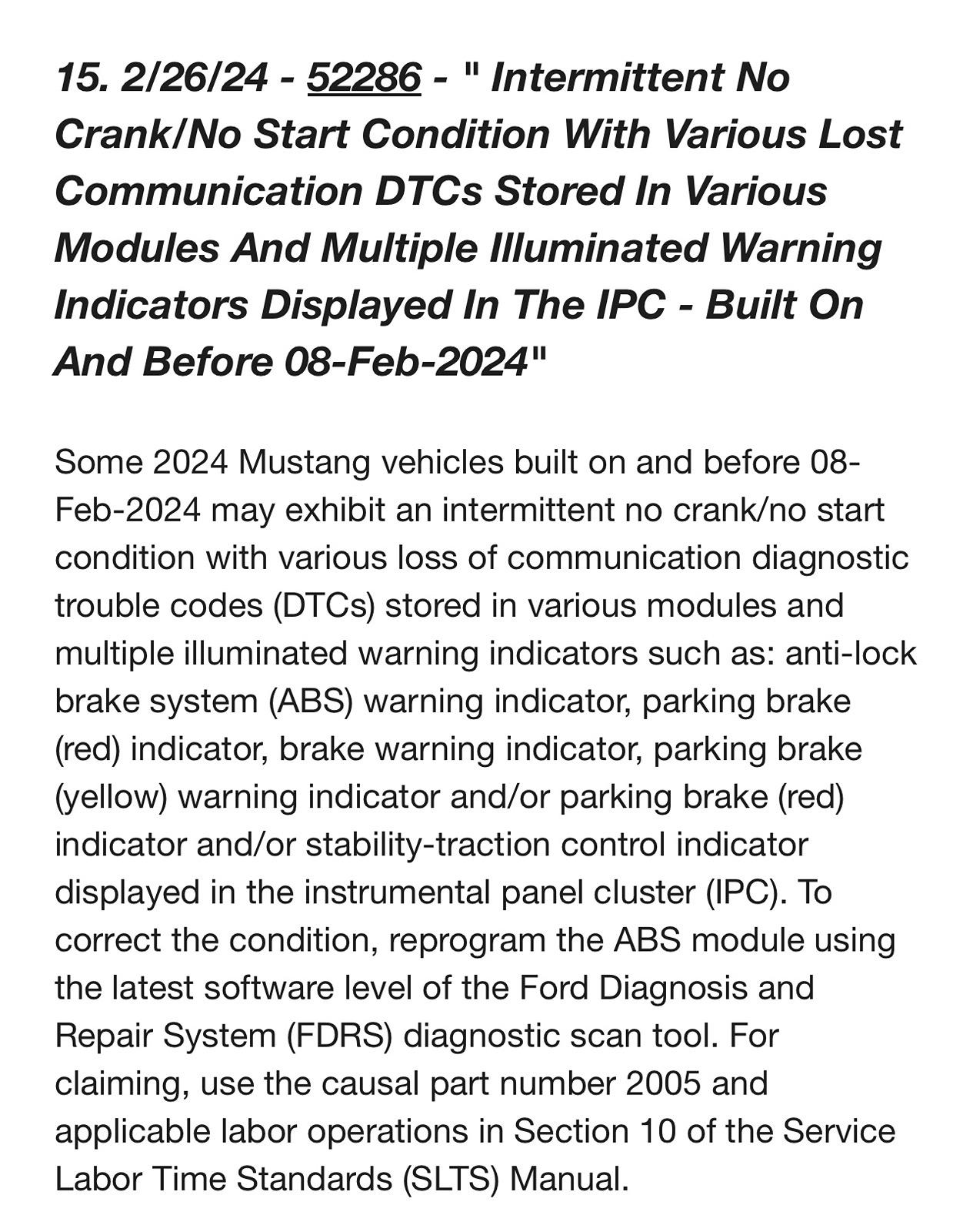

Maybe this is the issue. Happened to me today and I dropped it off at the dealership

Isn't this what the ongoing OTA software includes... a new version of the ABS software?
bweber
Aug 15, 2023
95
118
I believe so but I haven’t received the OTA yet

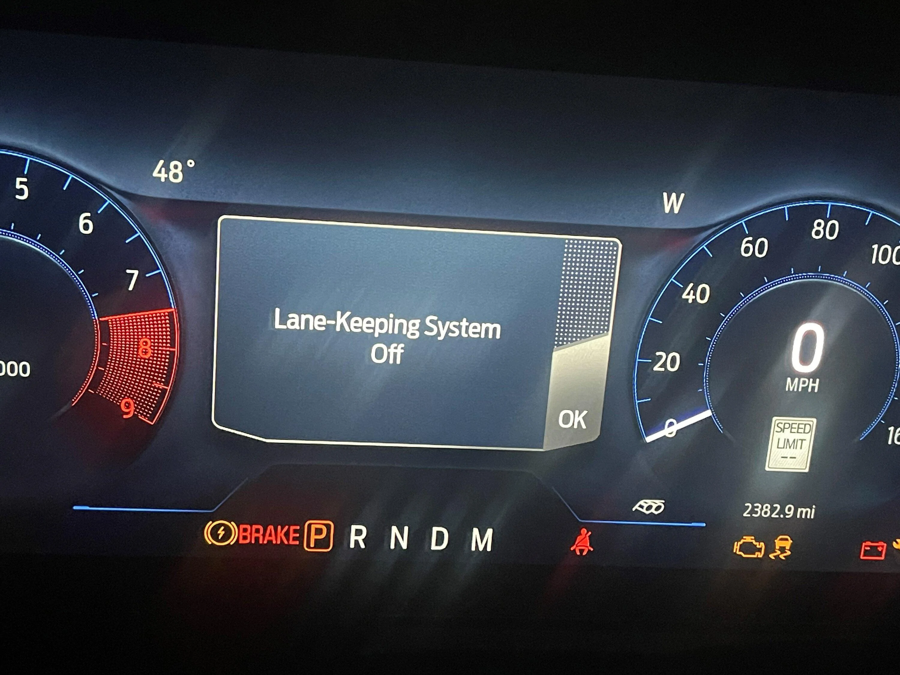

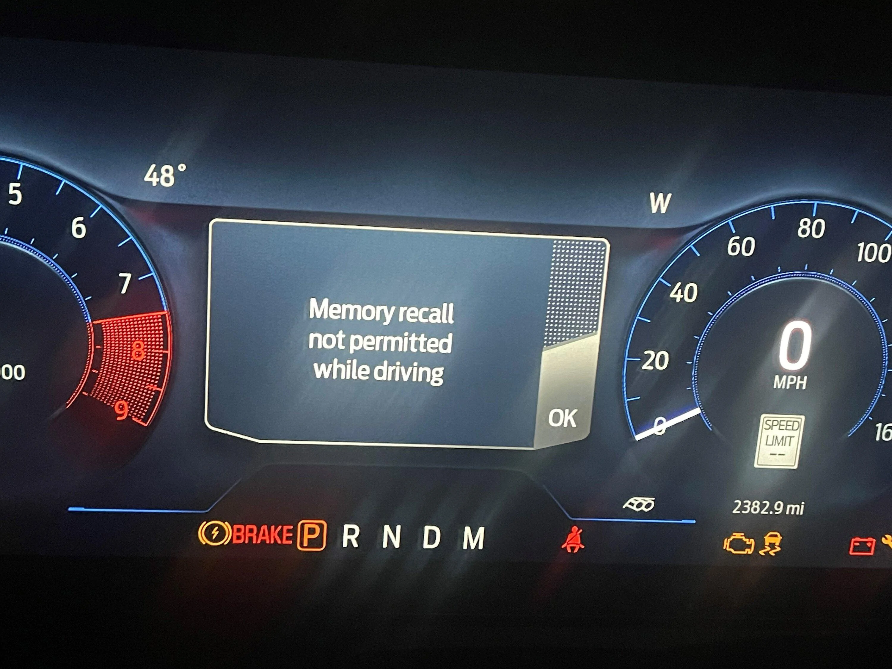

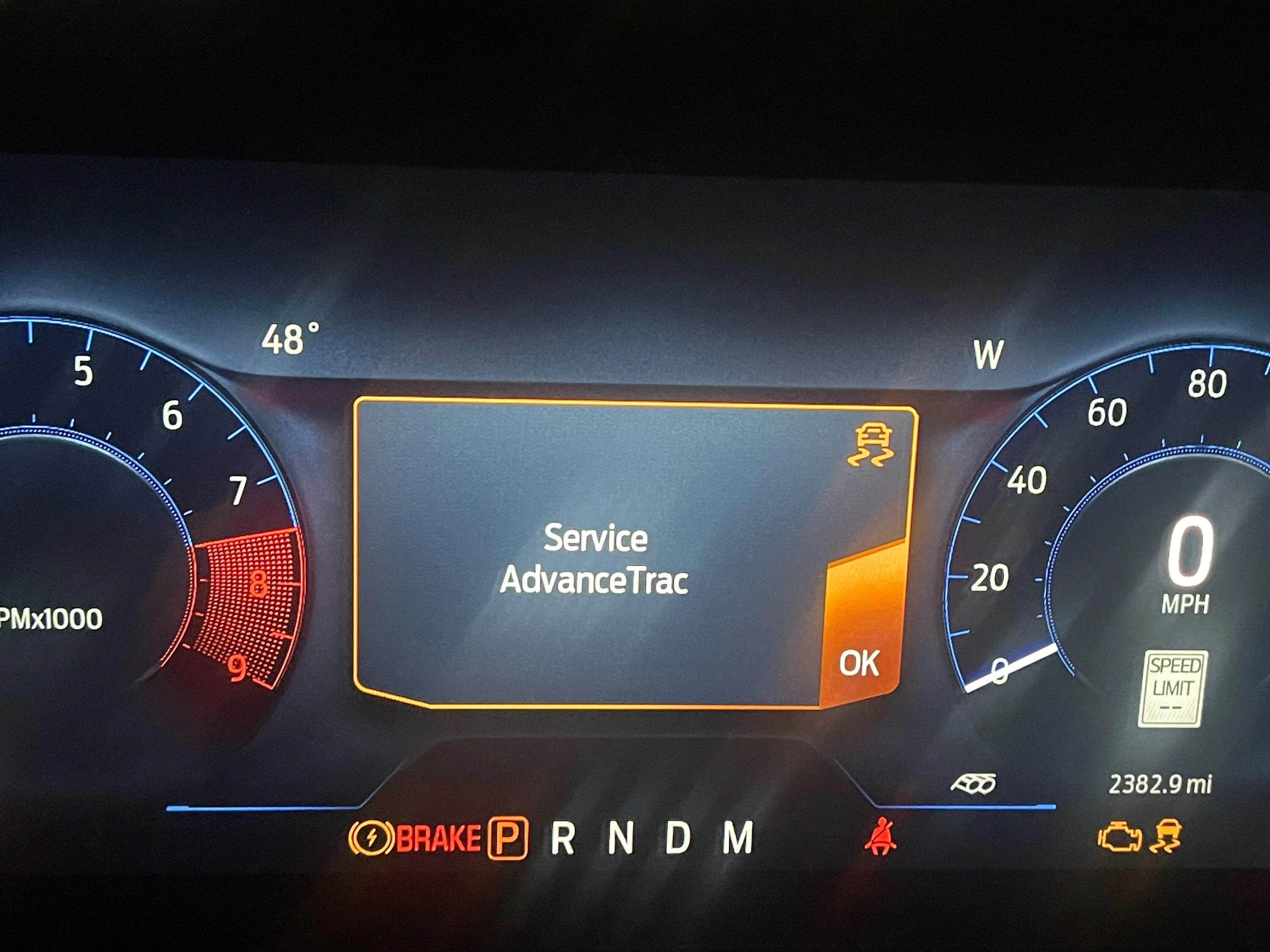

Well last night I experienced a different issue. The car would not start. I had driven the vehicle just a few miles to mail a package and then stopped at a nearby shopping center to pickup some dinner. I did sit in the car in accessory mode only for about 10-15 minutes. I then started the car to park closer to the restaurant to go pick up my food. I was gone maybe 5-7 minutes. Upon exiting the restaurant I tried to remote start with my key fob. The car attempted to start (almost like a partial crank), but failed. I tried again and the same result. I then entered the vehicle and tried to start it manually. It didn't even try to crank. Just the accessories came on with a bunch of warning messages.
The include the following messages:
1. Memory recall not permitted while driving
2. Lane-Keeping System Off
3. Service AdvanceTrac
4. Service Vehicle Soon
5. Full Accessory Power active
Note that even though the vehicle failed to start, I could shift into any gear. (Car is an automatic)

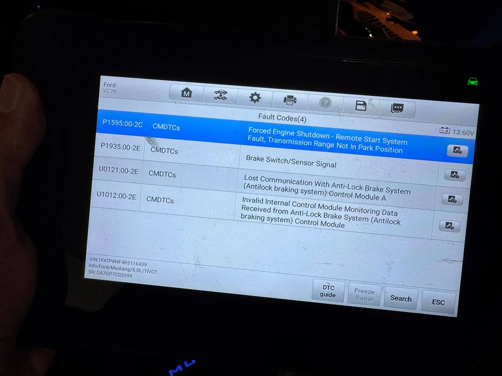

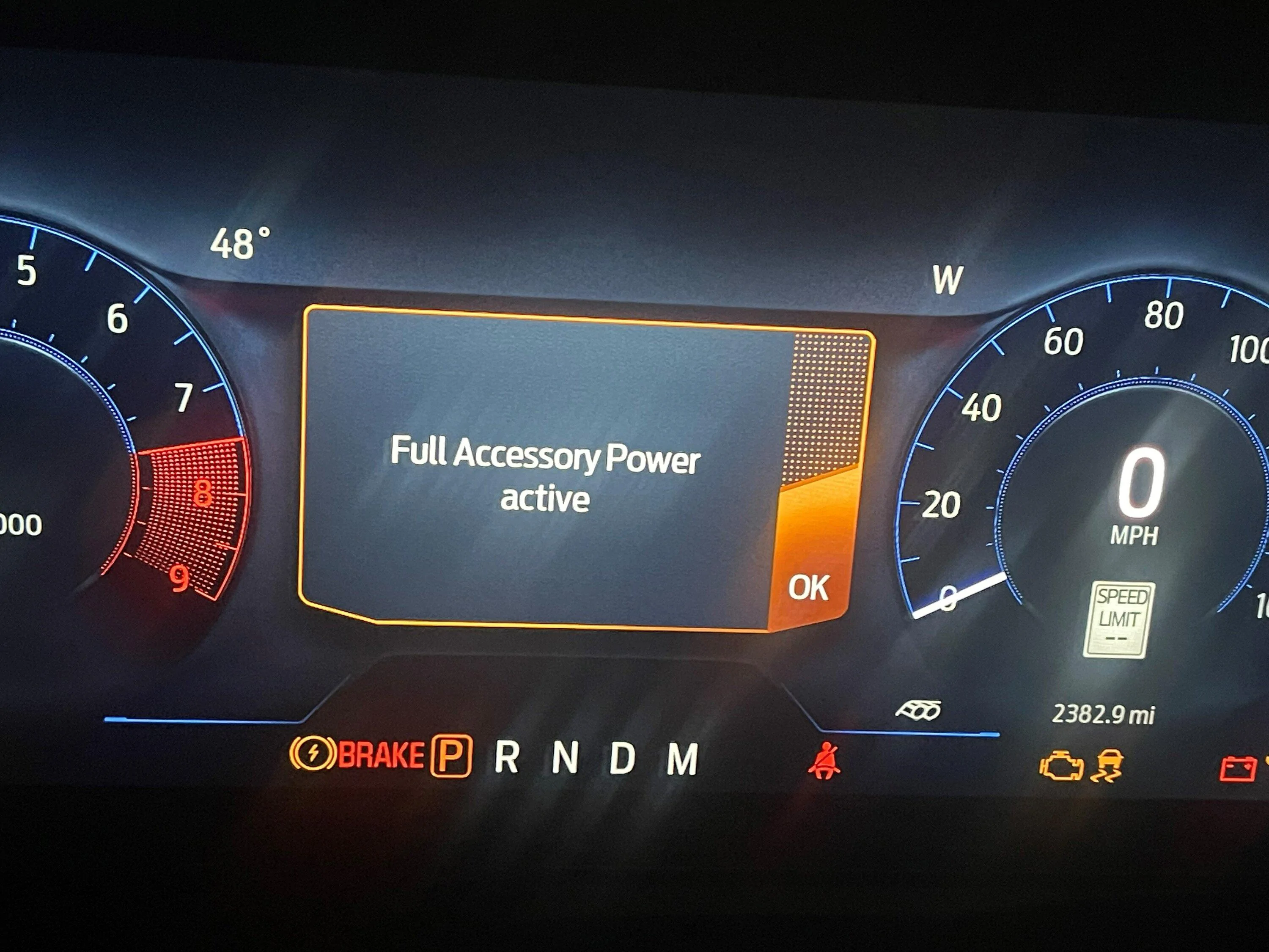

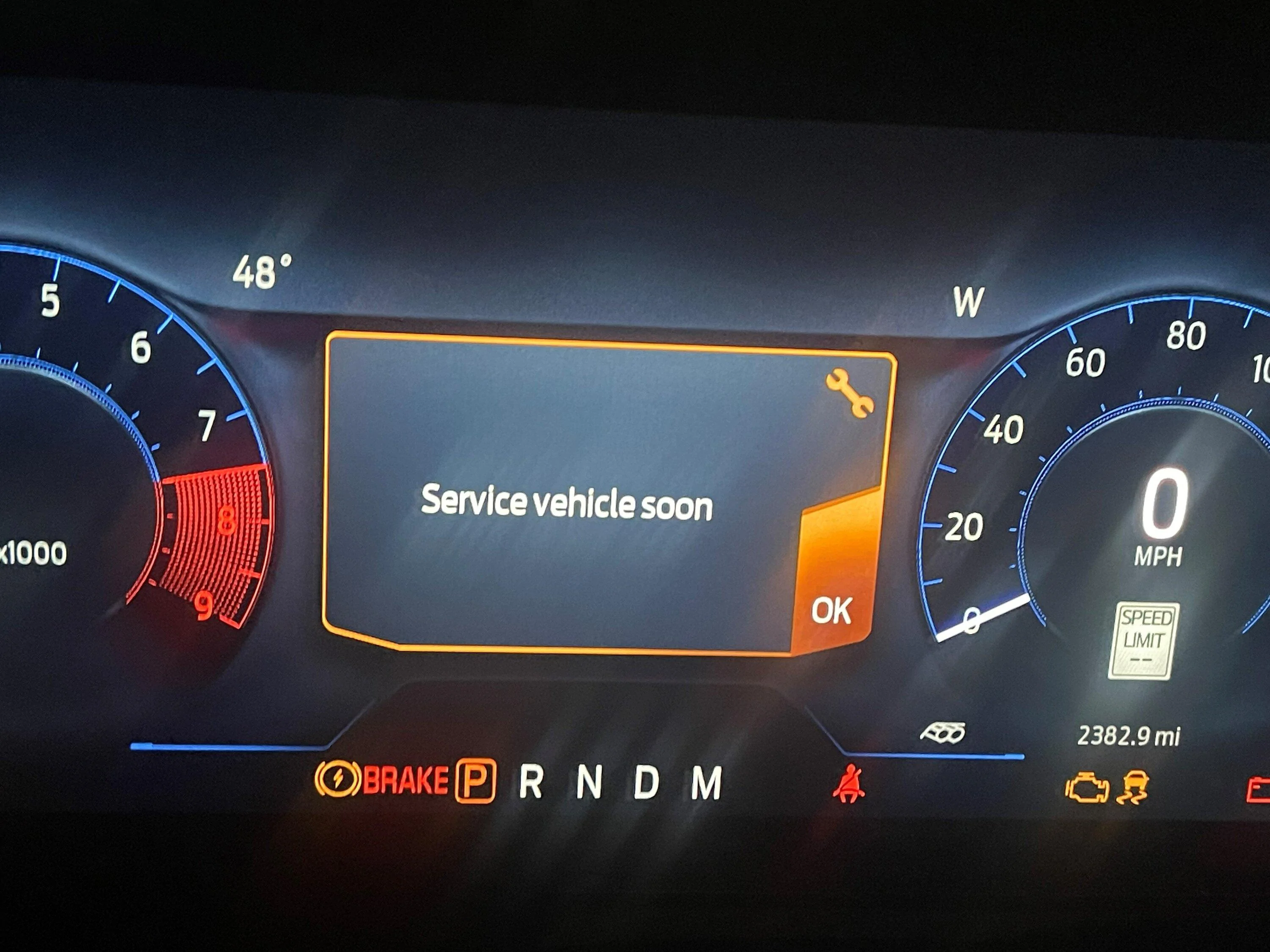

This exact scenario happened to me today, it was quite upsetting for my 9 year old daughter who with me. The car would not start for about 45 mins, but miraculously started as soon as roadside assist arrived. They plugged In the one and this is what it showed. Taking it to the dealership asap.
S650 Mustang 2024 Mustang GT Premium - Wouldn't Start IMG_3422
S650 Mustang 2024 Mustang GT Premium - Wouldn't Start IMG_3421
